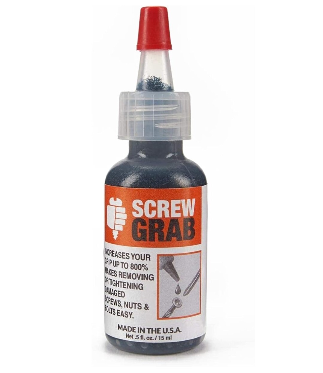

This is a handy product for stripped screws - carbide grit paste, bites into the tool and the fastener for better grip. I’ve kept a bottle onhand for years, only needed it a couple times but it’s definitely helped.

Interesting. I have another brand but it dried up years ago. What I do have is some stuff called “Clover” which is a carborundum/oil paste used for polishing stuff on the lathe, and that might be worth a try too.

If it’s the right grit size, go for it! I thiiiiiink carborundum should be hard enough to work similarly?
Well, absolutely no luck. I have tried the standard size (1.5mm ) allen, all the way up to a 2mm allen, as well as T7 and T8 torx, alone and with: single layer pice of a latex glove (.1mm), double layer piece of a latex glove (.2mm), rubber band (.5mm), steel wool, and the clover grit (interestingly, made by loctite), and a screw extractor. And no movement whatsoever. Last resorts are heat and jb welding an allen or torx to it.
