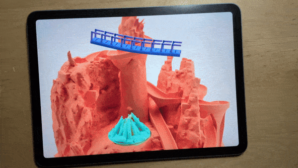

Many projects have motion or some kind of interactive component which can be hard to communicate in a photo or GIF. While I had a crowfdunding campaign running, I took a break from that project to work on an interactive itemI- 've been experimenting with adding animations to help illustrate its function.
The iPad app Looom allows you to sketch simple drawings frame-by-frame but you can also sketch ‘live’ while the animation is running.
Here’s an experiment where I’m trying to show paths in assembly instructions where users will be threading string through parts:

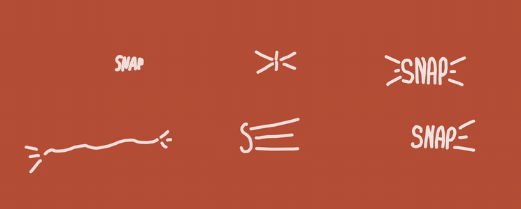

Here are a few thumbnails where I was experimenting with type that could animate on top of a photo/video to show an action. In this case, parts snapping together:
SketchAnimation1-ezgif.com-crop

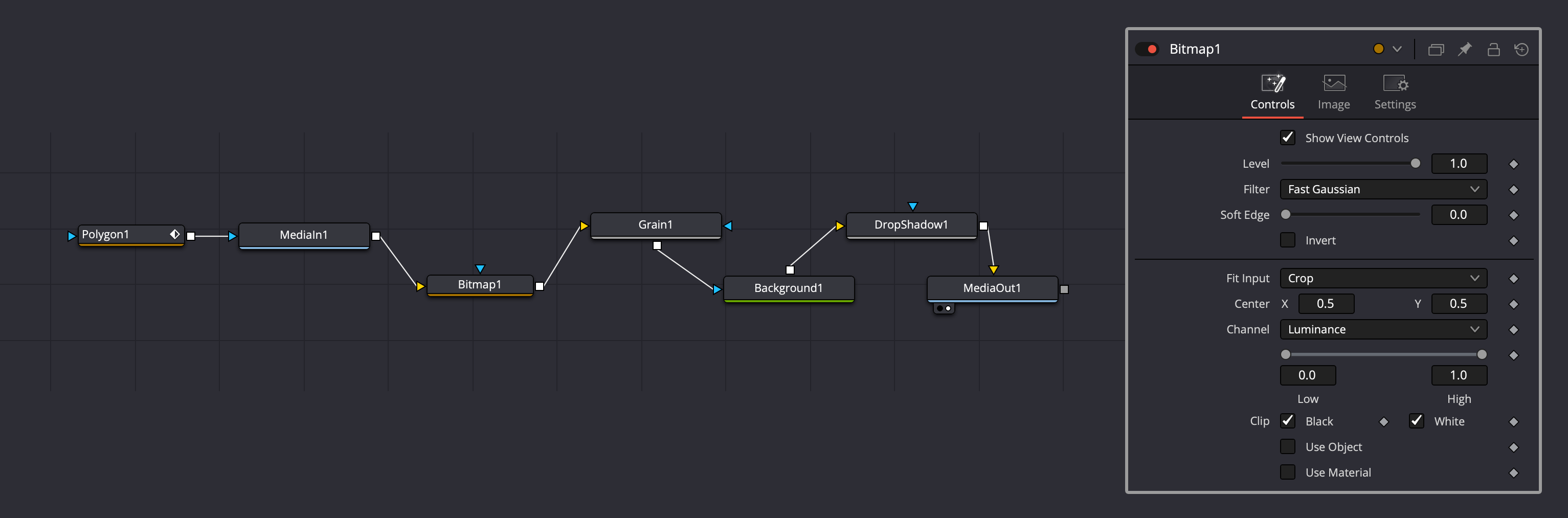

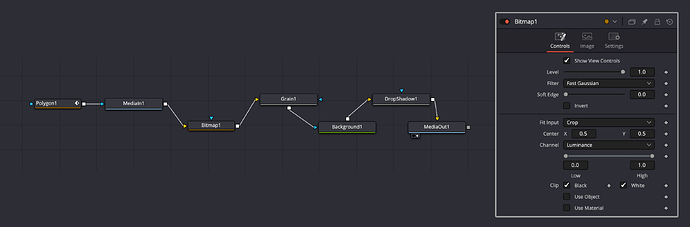

I’ve been slowly trying to learn DaVinci Resolve (free) and you can use it to layer these animations on top of video. Do do so:
  • In Looom, change your background to black and lines to white.
  • Press the Rec button in Looom to record a video of your animation.
  • Import the video into DaVinci and place it in the timeline in the track above your video clip.
  • With the Looom clip selection, go into the Fusion tab
  • Add a Bitmap node and change the channel to Luminance - this will separate your animation from the background while keeping it solid.
  • Optionally, you can add masks or a Background node to change the color of the animated lines.
An example of the nodes in the Fusion tab:
After that, it’s just a matter of exporting and converting to GIF (I use EZGIF).

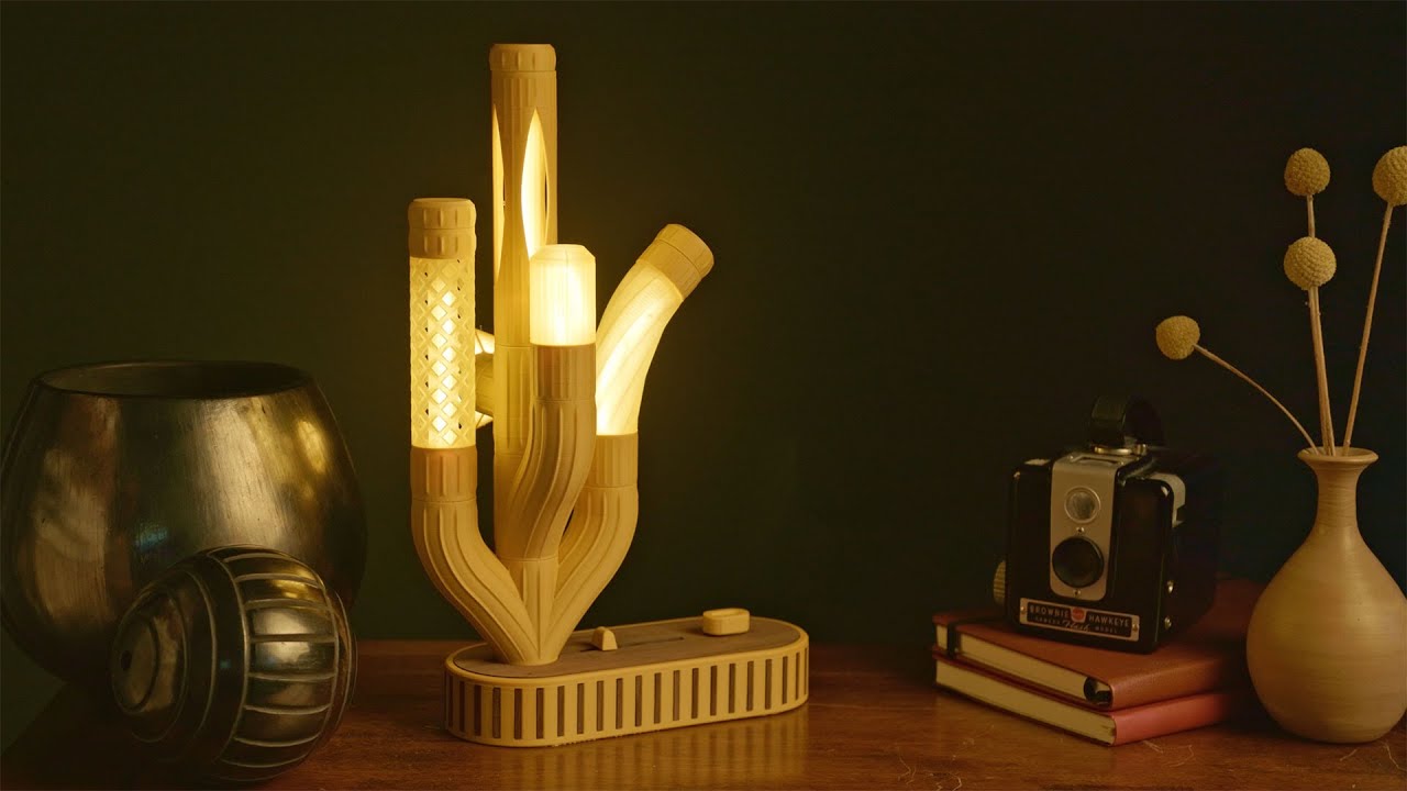

Having gotten Relic Rush out the door (along with a string of updates over the last month to fix issues and make improvements) I’ve posted the pre-launch page for my next campaign. I wanted to change it up and ended up with a décor item that uses the magnetic power connectors from Maker’s Supply - they make a pretty satisfying noise when they snap together:
Tip for magnetic connectors: I’ve found that I can minimize connection issues by leaving one side of the connector essentially ‘loose’. This will allow it to travel a bit and overcome any minute surface differences introduced through different devices

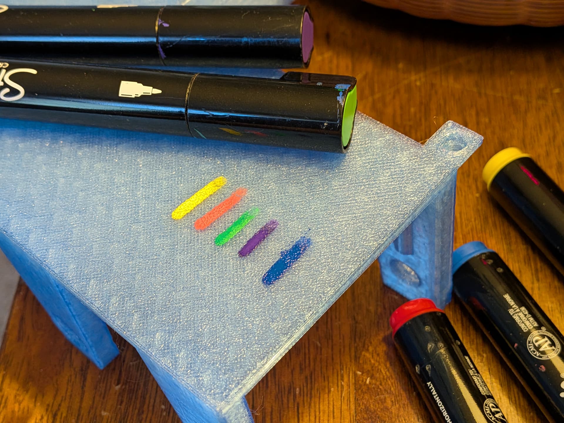

Cool Tool: Sharpie Creative Markers
I end up using these markers all the time to make notes on prints or just to test out different shapes or ideas on prototypes. They are opaque, write well on prints & with a few color options, have worked on basically any filament color. I’ve even used them in place of paint for areas that just need a small dot of color.
