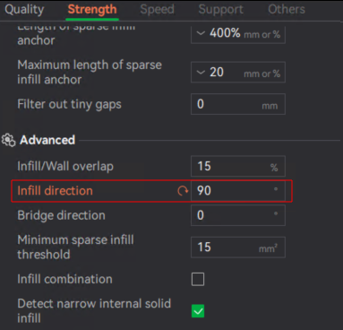

Where is the option to change the line from 45 degree to 0,90 or 180 etc. Making wall panels for buildings and need the final line to run horizontal or vertical not at a 45. Same with ironing. This should be an option for people that are building models that require straight lines. CURA would allow this [90,135,180,225] as an example. I could force CURA to to have bottom layer lines, top layer lines and Iron/smooth lines to run in a direction that made the wall panels look architecturally correct.
Not always intuitive, but you can find them here:
Ironing line orientation
Top/Bottom line orientation
Thanks that helped some. Still would like the face be Horizontal or Vertical but the internal structure to be 45 diagonal for strength.
But this does help. Thanks
