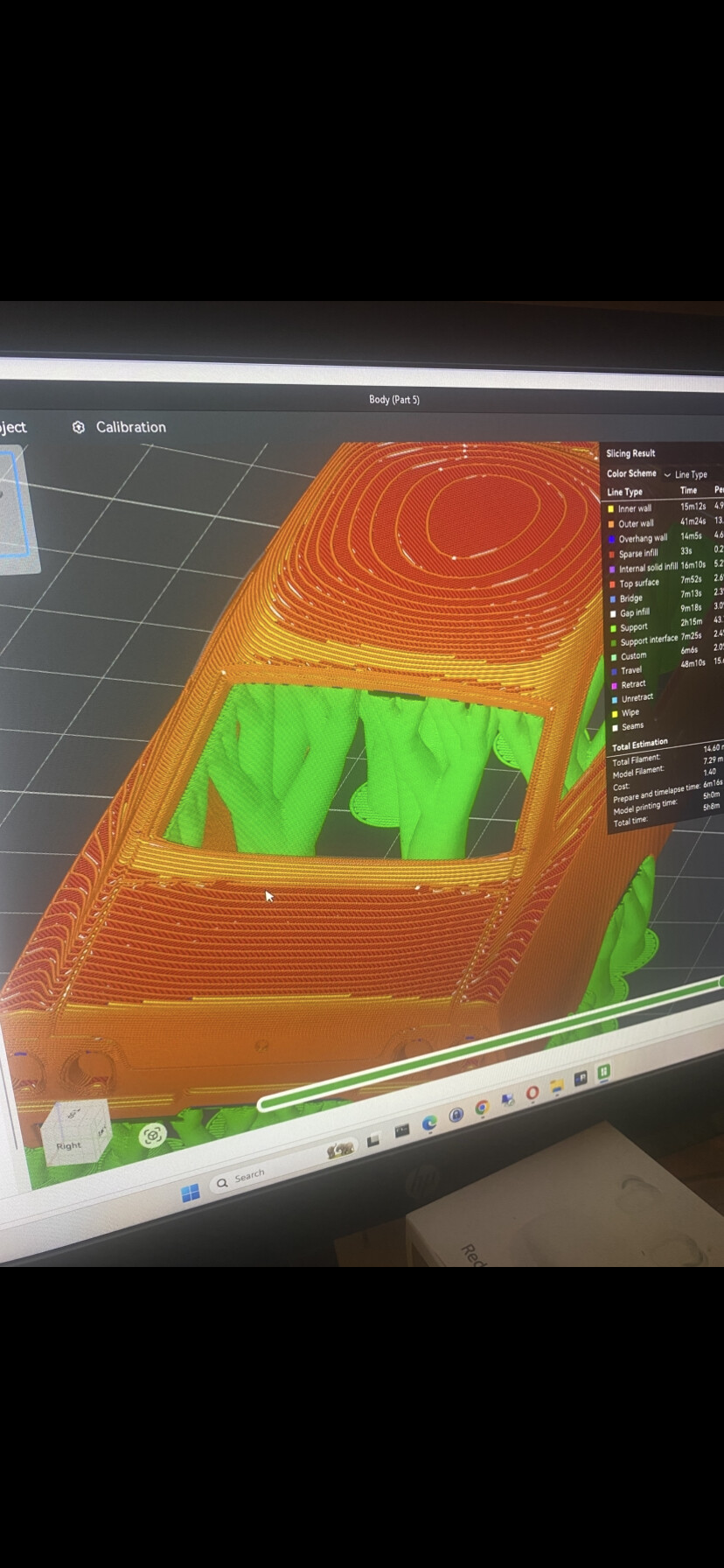

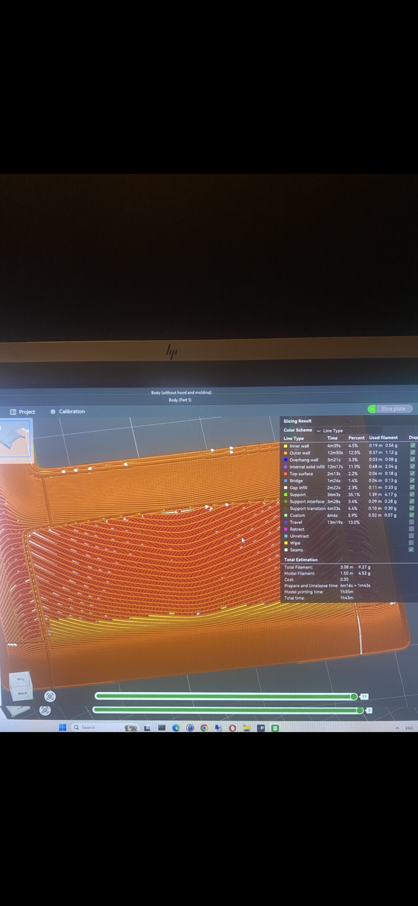

Hello, I am new user here and I have top layer fill issues, it fills strange and I see it in preview in bambu software, pictures attached.
So question how can I fix it?

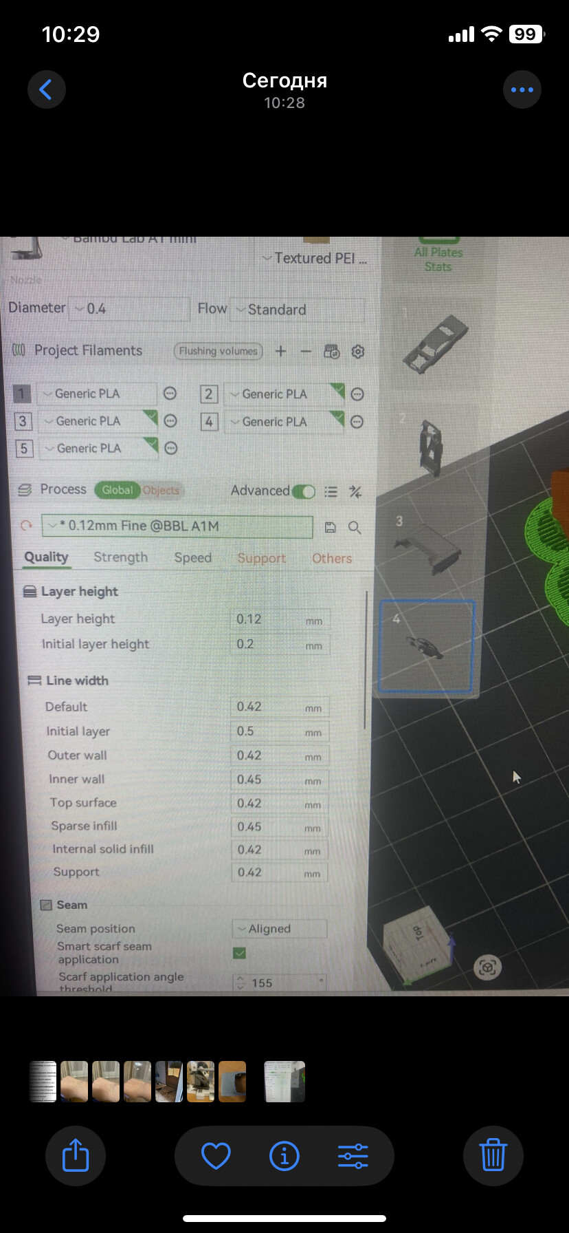

reduce layer height? what is your actual settings?
i’m not sure on an A1 mini, but a 0.4 nozzle can go 0.08 layer height, and 0.3 line width.
Do you think it will solve problem this problem? So this problem is with top surface when it is little bit round
the less layer height, the more line you on low degree surface, it will not “solve” until you go to invisible layer height (like 0.04 with a 0.2 nozzle) but will reduce it
Sometimes using “Concentric” surface for top and bottom layers can help how this looks. I prefer to use Concentric for surfaces, especially if they are rounded.
