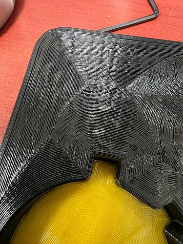

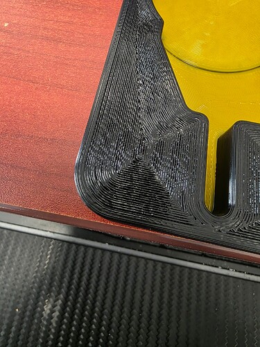

So I just switched to the 0.6mm HF nozzles on my H2D here at work and I printed a quick ABS tool tray. I printed it with Bambu black ABS, 0.3mm layers, 15% gyroid infill with infill combination turned on.

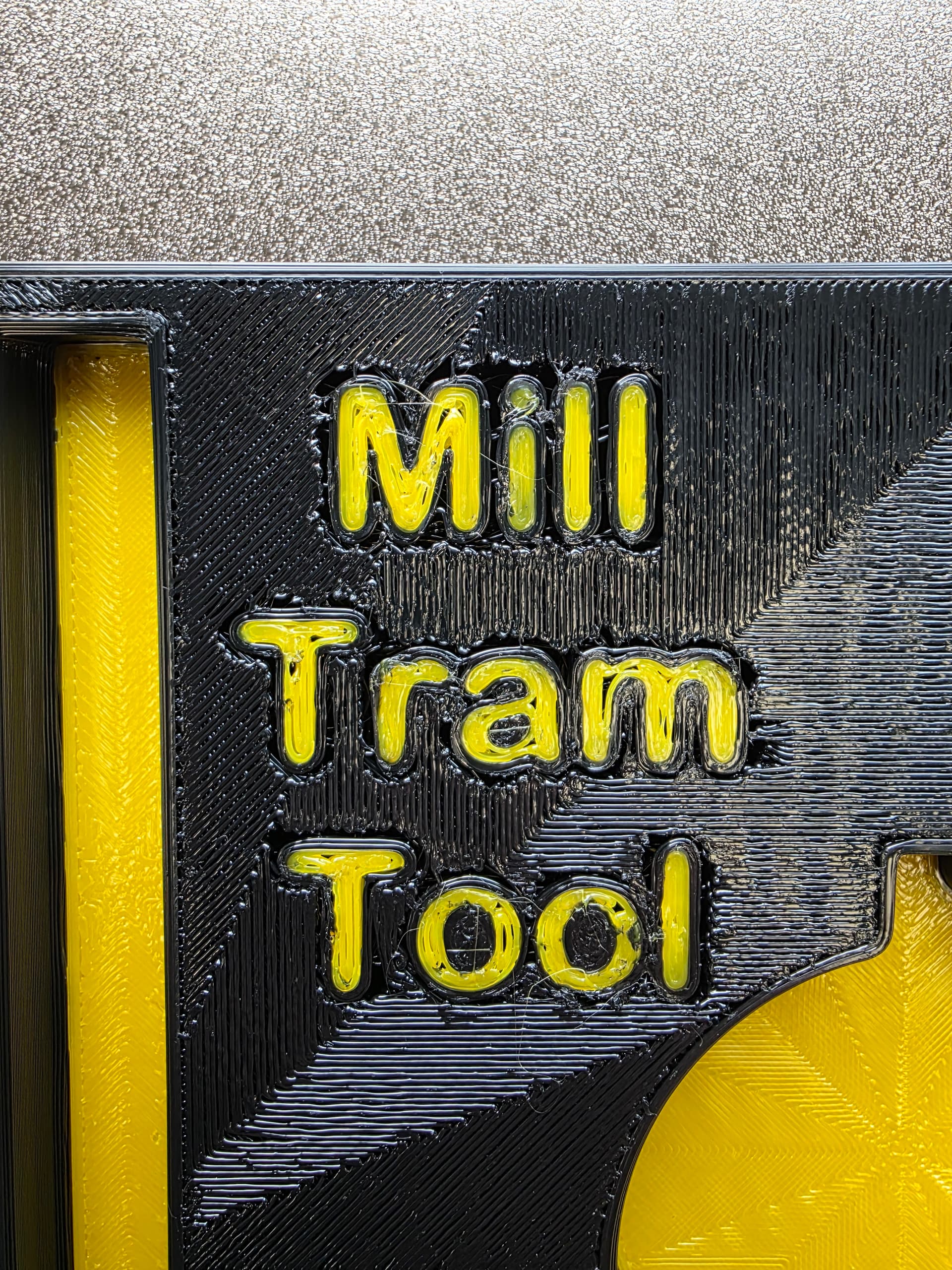

I know the printer did the flow calibration before the print but it really doesn’t look good on the top surface at all. There’s noticeable gaps between the solid infill and the walls in places, especially around the text. Also the text itself looks terrible with what looks like under extrusion. But the yellow parts below the text look great.
Any idea what settings to tweak to make this better? TIA.

I don’t have the H2, but on the rest of bambu’s fleet, when you do a multicolor print, the flow DYNAMICS calibration [not rate] only occurs for the first filament in the file, so you may need to do the calibrations for at least yellow [do both imo], and save it to the settings.
You mentioned bambu black abs, what’s the yellow? Also bambu abs? If so, the same PA setting is likely good for both
To my eye, it looks like some combination of flow rate too low and pressure advance [flow dynamics] incorrect, or the speeds being used are too much for the filament.

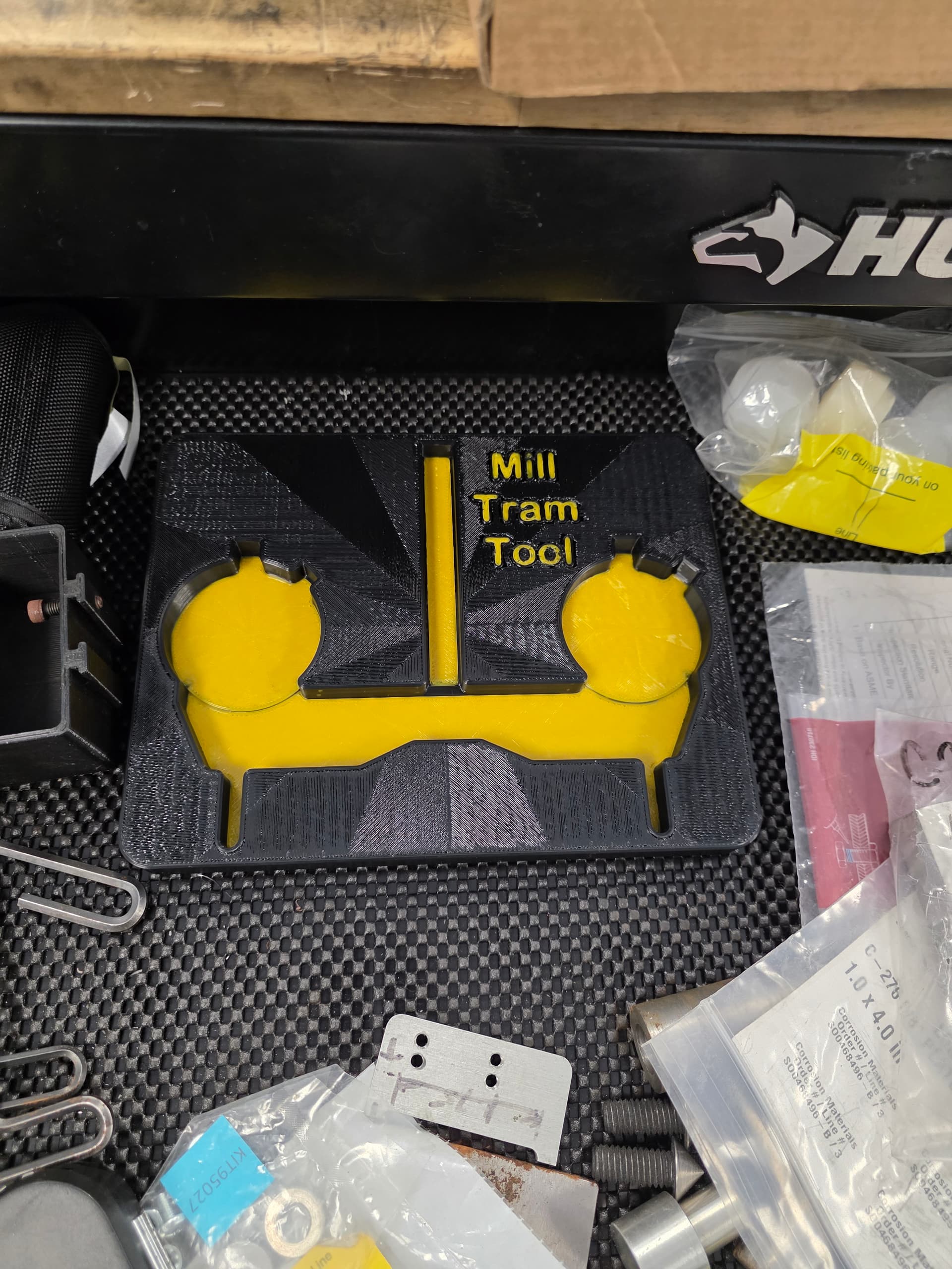

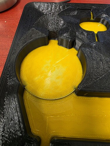

I’ll give that a shot, I’ll also slow it down as it knows it’s got the HF nozzles installed but it also knows it’s not HF filament, so I’m not sure. The yellow is Polymaker but the only issue with that is in the text. The other pads of yellow are solid and great. It’s also the top layer of black that’s not meeting the walls it seems, mostly around the text, but I did see some areas in the top solid infill that look underextruded so I’ll just slow the top solid infill speed down.
I printed it again after I added a feature to the part, but made sure the flow dynamics calibration was set to “on” instead of “auto”. Again the yellow top solid is perfect, the text looks trash and the top solid black looks trash as well. I’m printing it again now but slower.
Well that didn’t work. I slowed it way down, added a third top solid layer and it’s the exact same - infill isn’t connecting to the walls only around the text and the rest of it looks under extruded, although not as bad as before.

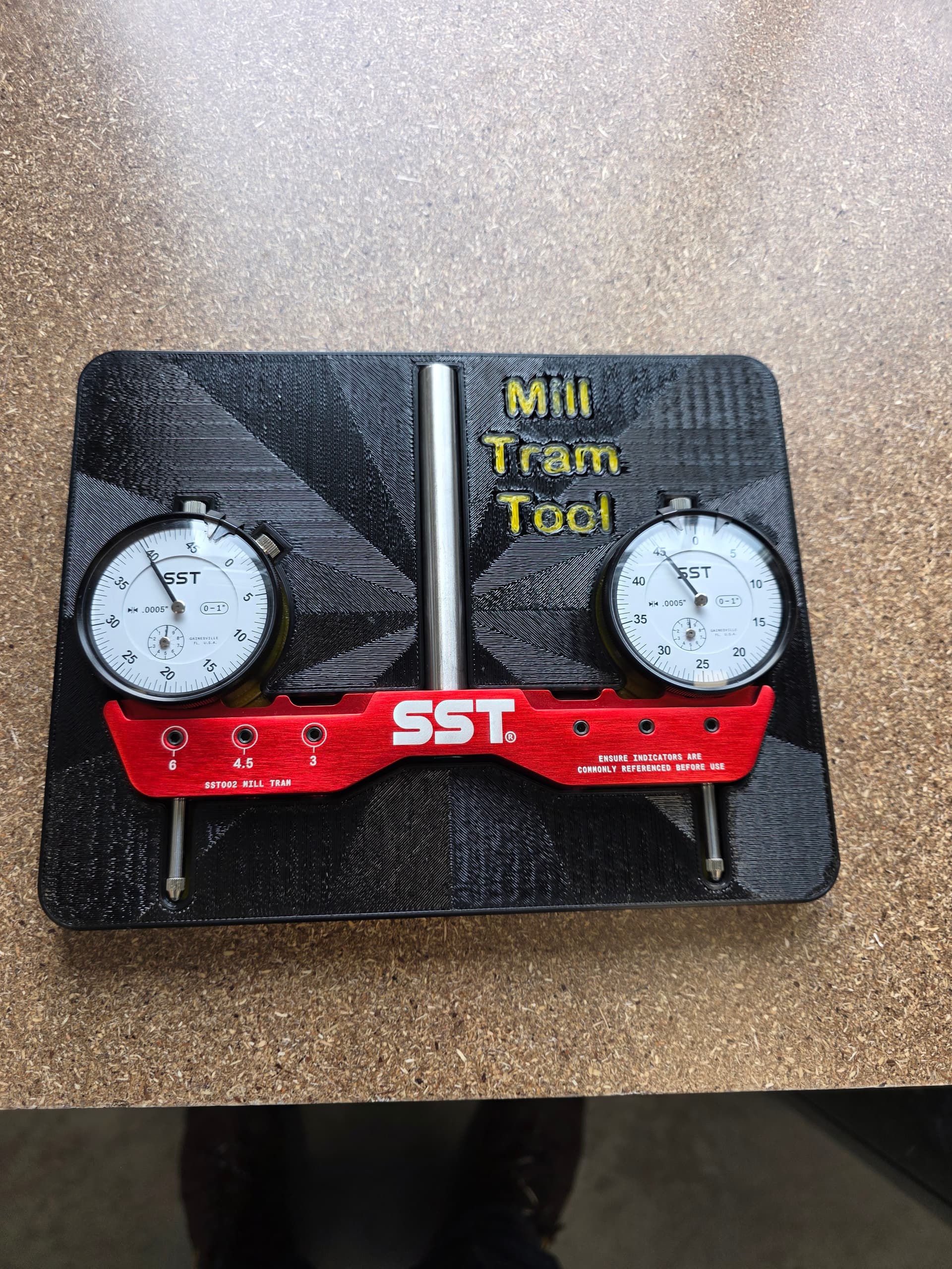

The whole idea of switching to the 0.6 was to print faster. Being able to print thicker layers dropped the time on the prints it was bought for from 11.5 hours to 6.5 hours. It wasn’t needed for this specific print, I just didn’t feel like swapping them back out lol. It’s just a tool holder that’s going to sit in the toolbox drawer, no need for it to look perfect.

I would try narrowing the line width of the top layer. A lot of my top layers with text with the .6 nozzle look crude.
I’ll give that a try next time, thanks for the idea
