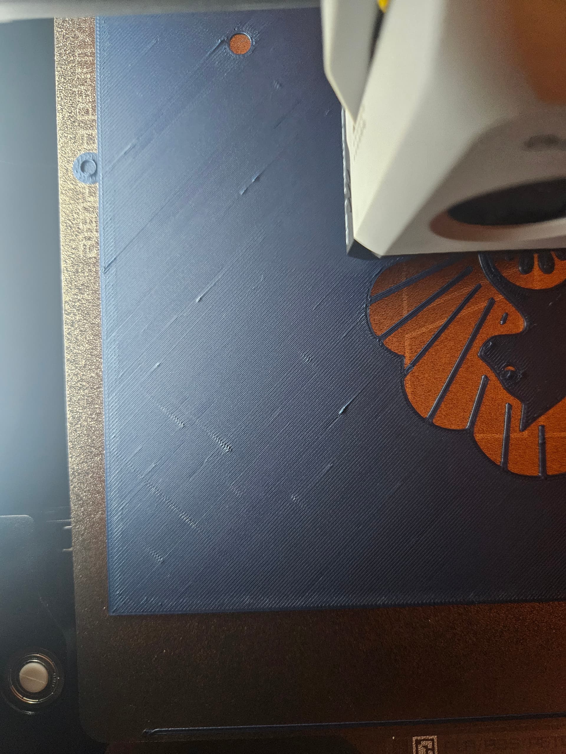

Hi Everyone,
For about a week I’ve been experiencing print quality issues after experimenting with slicer settings in Bambu Studio. I’ve since reverted my changes, inspected the nozzle, and cleaned it thoroughly. Despite that, the issue still persists: my top surfaces are not being laid down consistently. The infill looks fine, but once the top solid layers start, I see gaps/lines instead of a smooth surface.
Is it speed or is it cooling or something else?

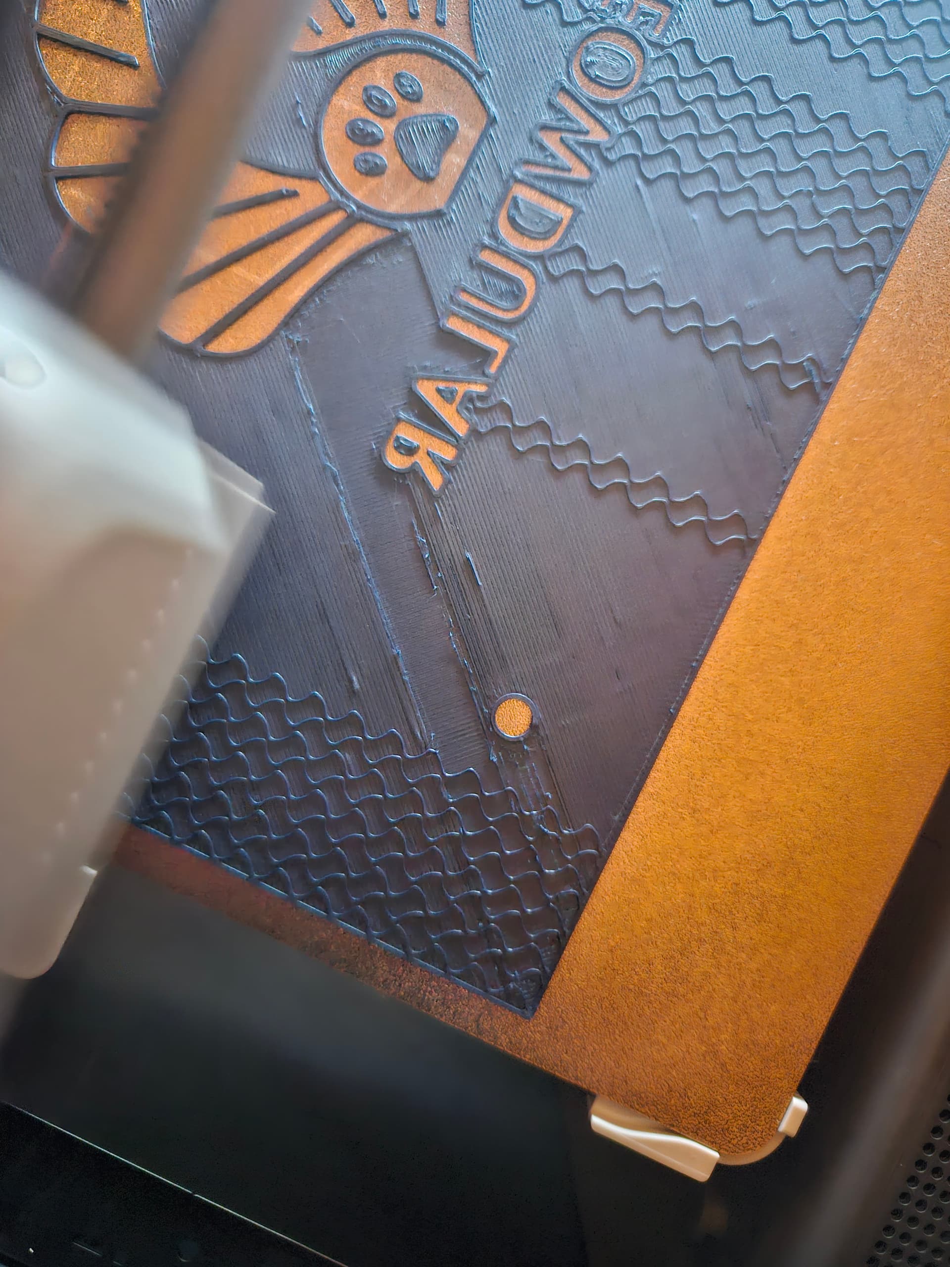

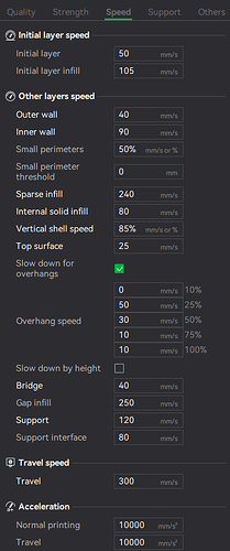

Pic #2 looks like drying problems, and in general I would suspect the 25mm/s top surface speed vs the overall much faster rest of it. Low speed feed could begin to heat creep, you might be on the verge of clog as it takes its sweet time printing that section. Are you printing with the top glass off / door open?

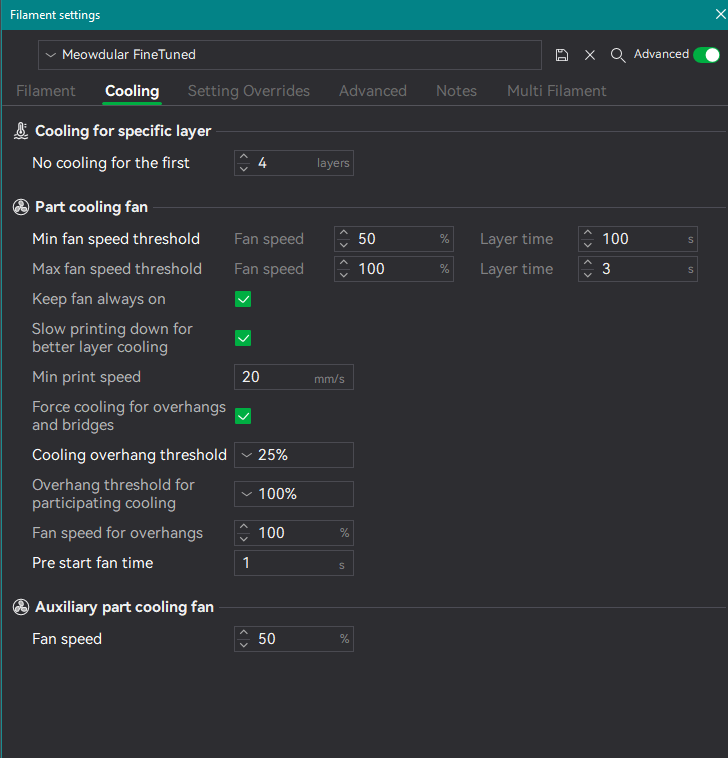

Thanks for your suggestions! I do not have the top or door open. I never had to resort to that. I can turn up the cooling though? I changed it because ChatGTP said this was best to do. The 25mm/s top surface speed is because it did not came out consistent so I thought if I lower it it might work. The print takes up almost 16 hours.

The cooling fan in slicer settings is the one cooling the freshly printed model’s edge. The fan responsible for combatting heat creep is on the heatbrake of the nozzle, it’s already working at max.
I agree w/ the assertion to print slower for better quality but a sustained 25mm (1/10th the machines nominal speeds) is going to do Other Things©, IMO. I think you may need to help the ambient temperature, since your feed rate is fixed low. Pop the glass and open the door does that. Or maybe feed faster than 25. (default p1 profile wants to do that at 200mm/s)
In either case i’d dry!

You may want to grab a cheap hygro-/thermometer and use one of the many holders on MakerWorld to place it in the heat chamber where the camera can see it.
In that manner, you can monitor your chamber temp and keep it at 35°C for (dry) PLA by proping the lid open. It is important regarding heat creep.
Models with fewer, smaller continuous surfaces, no ironing, etc can be printed well with chamber temps of 35-39°C.
I have nothing against printing faster but as you can see on picture one it skips a whole section for some reason… Anyway thanks for your advice, I will print with the door/lid open. See if this improve quality.

Do the top layers look like that in the slicer preview?

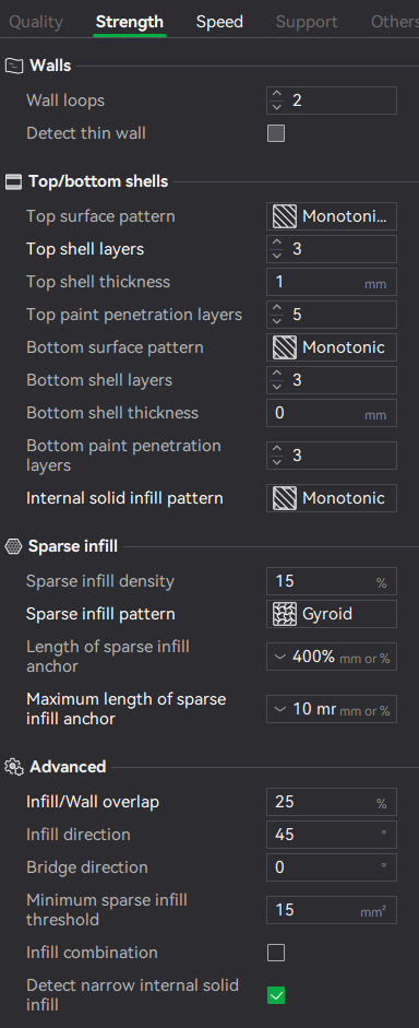

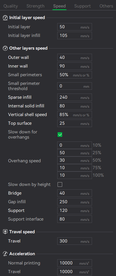

You say you reverted your slicer changes but in your screen capture, there are a lot of changed slicer settings. I’d try reverting everything back to the defaults and if that fixes it, then add your changes back one-by-one till you discover which one caused the problem.
Looks like a partial clog. You don’t mention what size nozzle you are using. Have you tried performing a cold pull?

No the slicer preview looks perfect. And I understand why you would say that, I should have mentioned that I revert back my changes to the settings where previous prints did work. The standard bambu preset was already too fast in the beginning.Yesterday I started a new print with the z hop when retract at 0.2mm and kept the glass door open and this worked
Ah yes, I am using a 0.4 and I did 2 cold pulls that did not resolve it before. Yesterday I started a new print with the z hop when retract at 0.2mm and I calibrated my K factor and kept the glass door open and this worked for now.

Solution I found now was:
K factor calibration
Z hop when retract at 0.2mm
Glass door a little bit open
