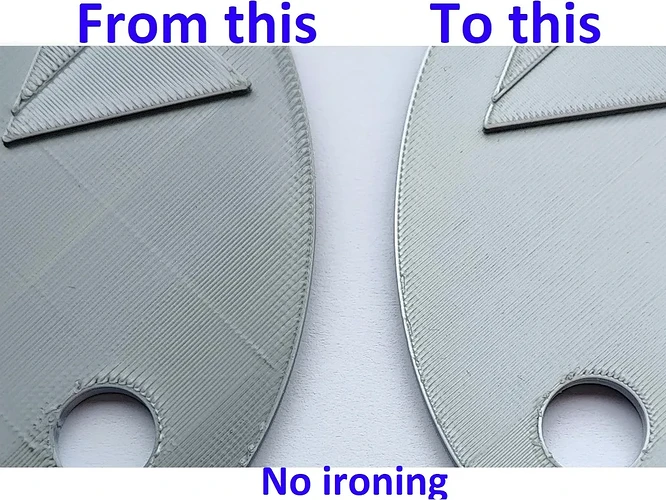

In my quest to get rid of the gaps in my top layers, I found a cool Top Surface calibration thing on makerworld. My top surfaces are better because of it. I figured some may even learn a thing or two about setting up your own test pieces. This doesn’t necessarily fix the gap issue, but does give better top surfaces.
I just figured I would share…

No, that guide was basically tuning top line width, speed, and flow. It was put together pretty good. I was board and wanted something to do, so tuning profiles. I just figured I would share.

They do have an H2 series. I didn’t make it. Just saw a lot of people complaining about top surface quality and figured I would share. The designer did put it together well and for so many people new to 3d printers, it would be a good example of how to change object only settings and understand how you can make your own test pieces.
They do have a little thing towards the end with ironing, but I don’t do ironing. Too slow for functional parts. Lots of other good ironing tests out there for that I would think. I saw uncle Jesse do something a while back.
