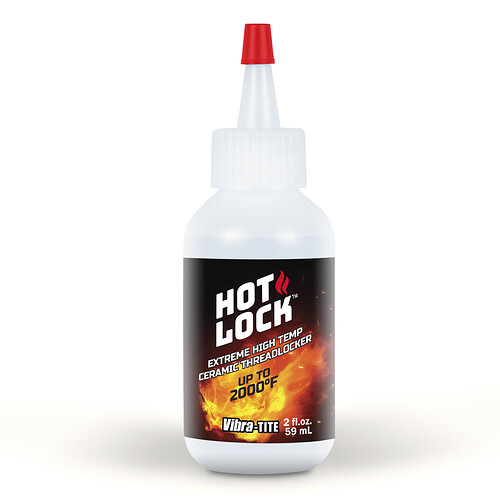

The 4 screws that really want loctite also need to be able to withstand nozzle temps – as they are on the heat block, nestled right next to the heater core. so you can’t just use regular red/blue. Even “high temp” generally available loctite 246 is not rated high enough - 450f/230c. You’ll be spending more in glue than replacements, but I guess if you have some on hand let us know how it goes.
I found Vibra-tite threadlocker rated to 1000C
