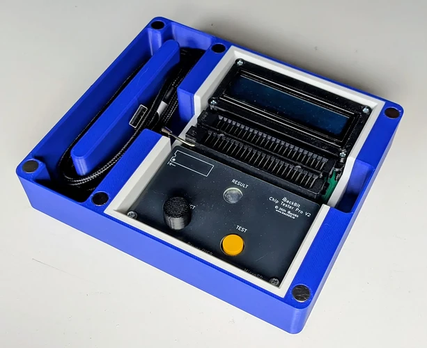

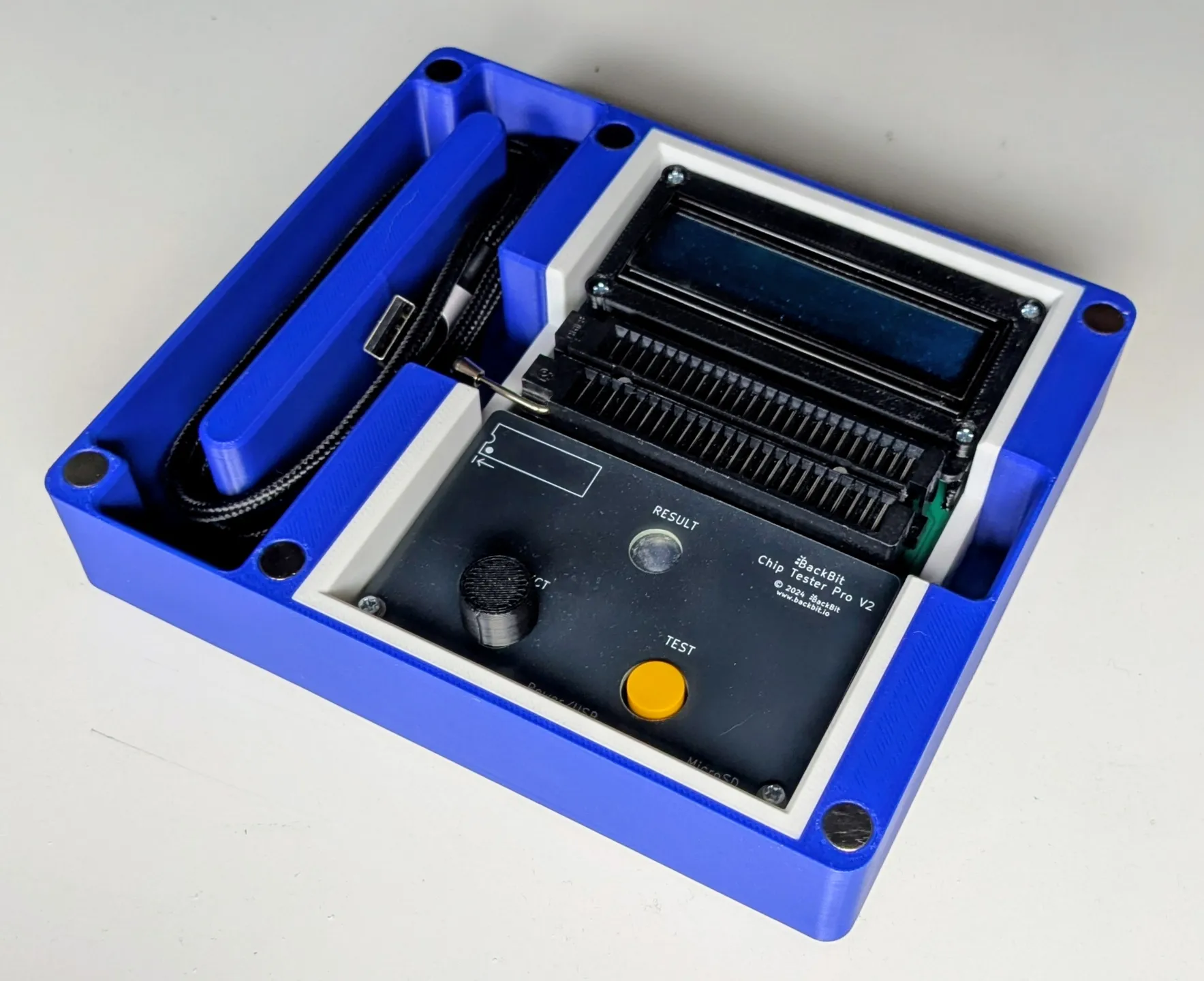

I’m using the H2D and I have printed BBL 85A TPU with several methods, all have worked flawless.
First, standard way - feeding the filament thru the backside TPU entry, 0.4 mm Standard nozzle.
Second, feeding TPU from above directly to the print head - no visual difference but annoying noise level due to missing top lid. 0.4 Standard nozzle
Third, using the BBL TPU nozzles (TPU high flow kit), 0.4 and 0.6, feeding TPU thru backside TPU entry. Got the impression that the print with the 0.6 mm nozzle had have some ‘starved’ spots but might be possible that the TPU wasn’t really dry.
Forth and last, using BBL TPU nozzles, 0.4 and 0.6, the external TPU feed assist and AMS HT (using the TPU outlet) and PTFE tubes from start to end (using an Y-adapter inside the printer to combine standard/buffered entry and TPU entry to avoid changing inner PTFE tubing). Worked perfectly as well, best speed and consistent print quality.
I did a combined print with PETG on left nozzle and TPU 85A on right nozzle as well, printed the TPU part (white) directly into the PETG part (blue) (initial left and right mixup corrected, as mentioned by @cyberang3l , thanks for the info!)

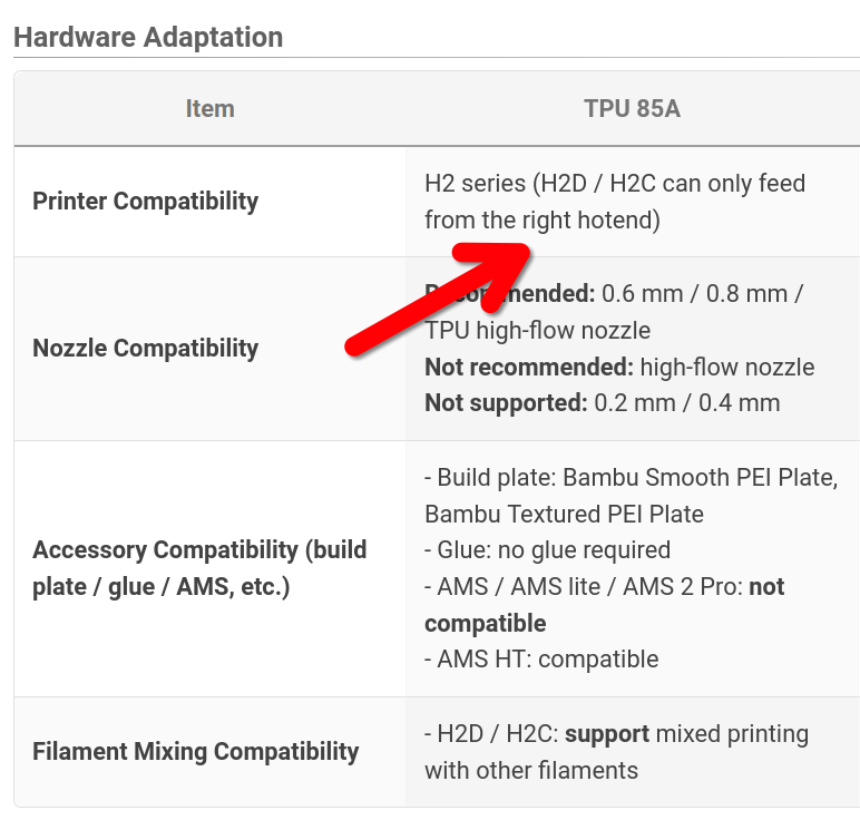

Is this supported? I thought TPU 85A can only be used from the right nozzle based on the information in this wiki page: Preparation for TPU Printing for H2 Series | Bambu Lab Wiki
