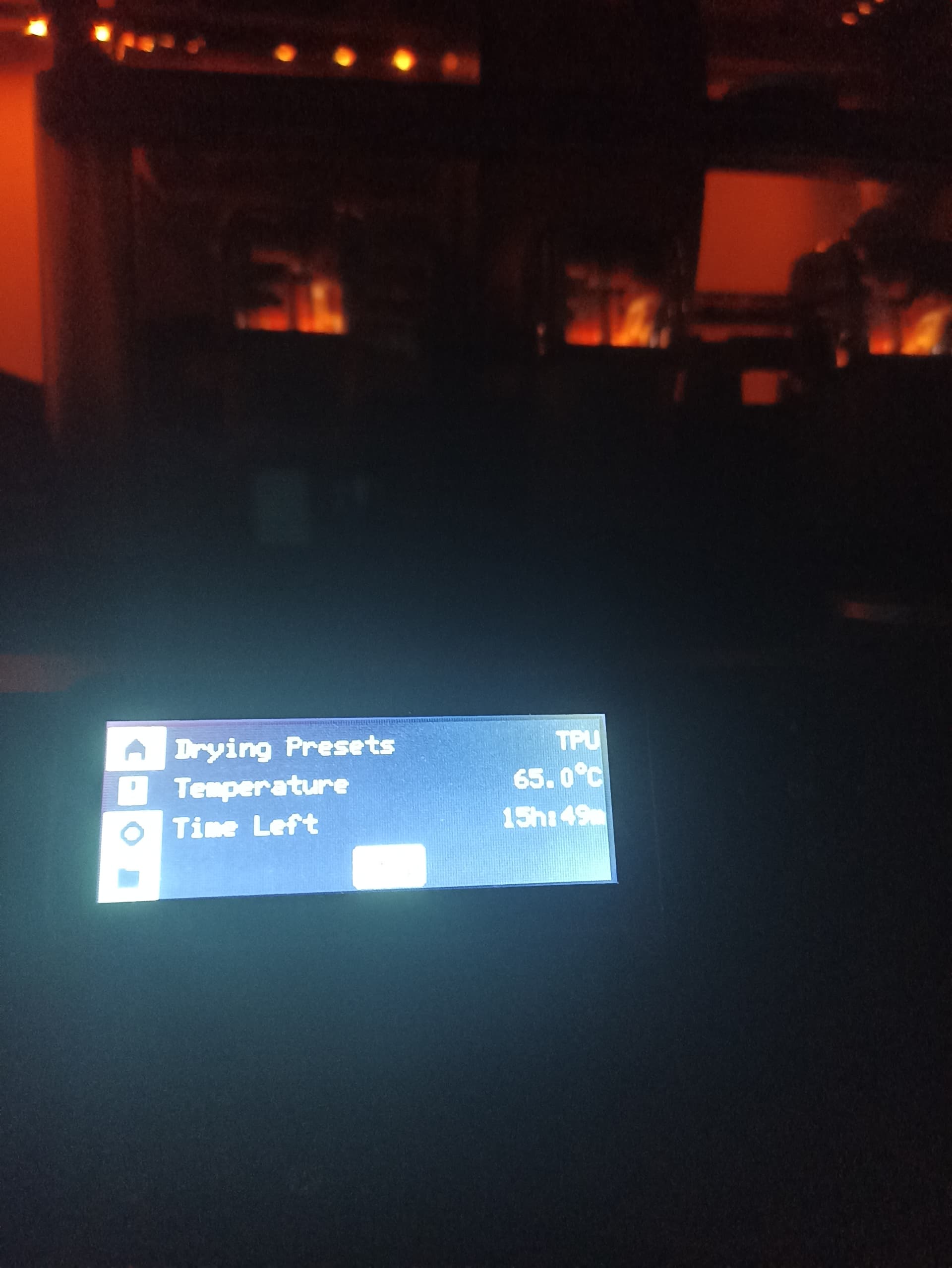

I put it in the AMS 2 Pro, set it to default TPU settings of 75° for 18h then tried using it.

75 ° is tooo hot for tpu drying.

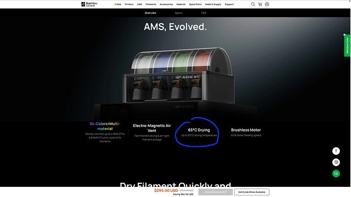

Well, thats good to know, but ill be honest, the AMS 2 Pro doesnt reach 75°.
Whenever I check on it and how much time remains on the disaply it always reads 65°.
I assume it was a miss-type when they wrote the firmware presets for it, or they simply include a thermostat for the unit that isnt actually capable of measuring past 65° and so will be at that temp no matter how much higher you go (which would be a massive design oversight if your unit is actually capable of higher temps).
I also got confused by this. You’re right, the AMS 2 Pro only dries up to 65°. If you want to go up to 75°, you need an AMS HT.

But good thing you mention the HT, maybe the 75° they show in the menu, is in fact a firmware version for both AMS and HT.
