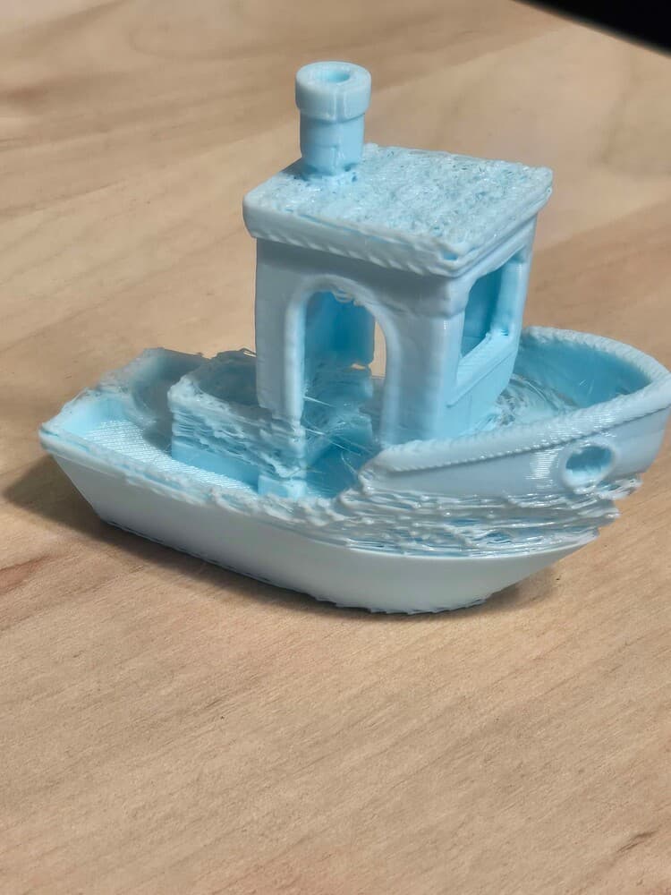

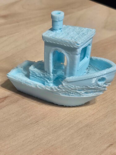

I am using P1S with default TPU-90 Settings at 0.20mm layer height.
The TPU-90A spool has been dried for 8 hours before use, and sits externally on rollers with bearings.
This is the best Benchy I have achieved.
What could be going wrong?

Do you have any indication that the extruder gear is slipping? For example, if you take the filament out, is it scarred? Or can you see the filament spool not rotating as expected while printing?
Just because of the soft material, my guess is the extruder gear (which grips the filament) is not gripping hard enough. This could be a reason that there is ghosting around the print. That is only my suspicion though, and I cannot say for sure that is the issue.
Did you read and follow the printing guide?
Be sure that there are no drags on the filament path. If it is dragging a little, its possible the stretch is leading to under extrusion.
Overall… it does look like a print that is printing too fast. Make sure you are using the correct filament profile.

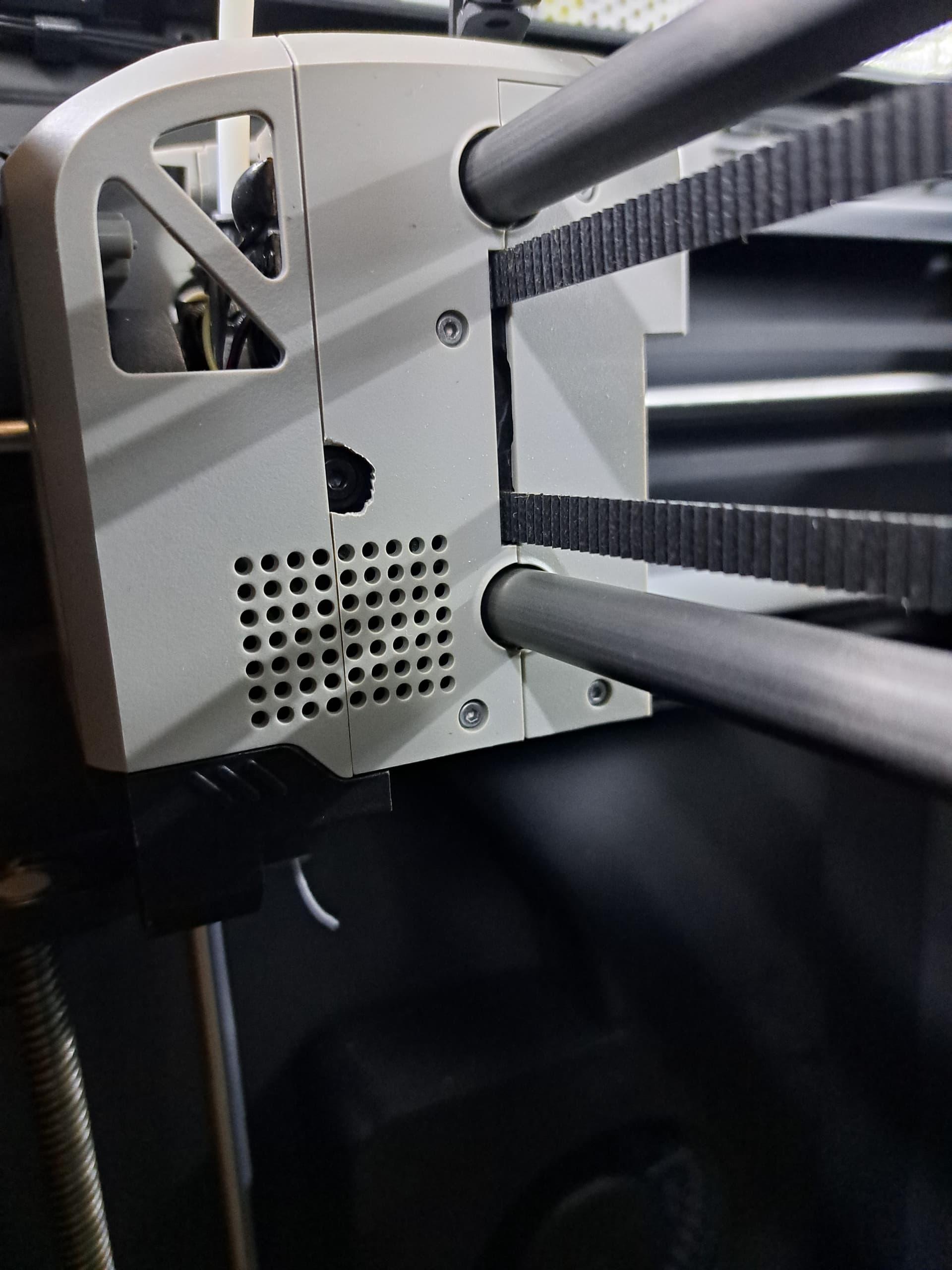

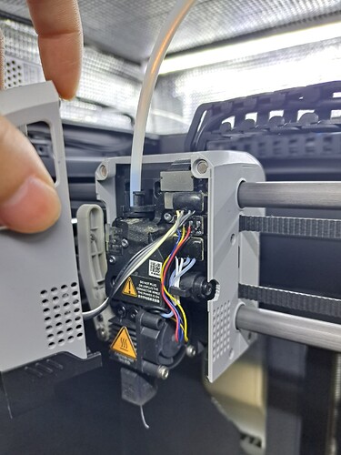

Maybe trying this hard mod to adjust how hard extruder squeezing on soft filament
I could remove the assembly and adjust and reinstall, would you think it is holding on too tight or not tight enough?

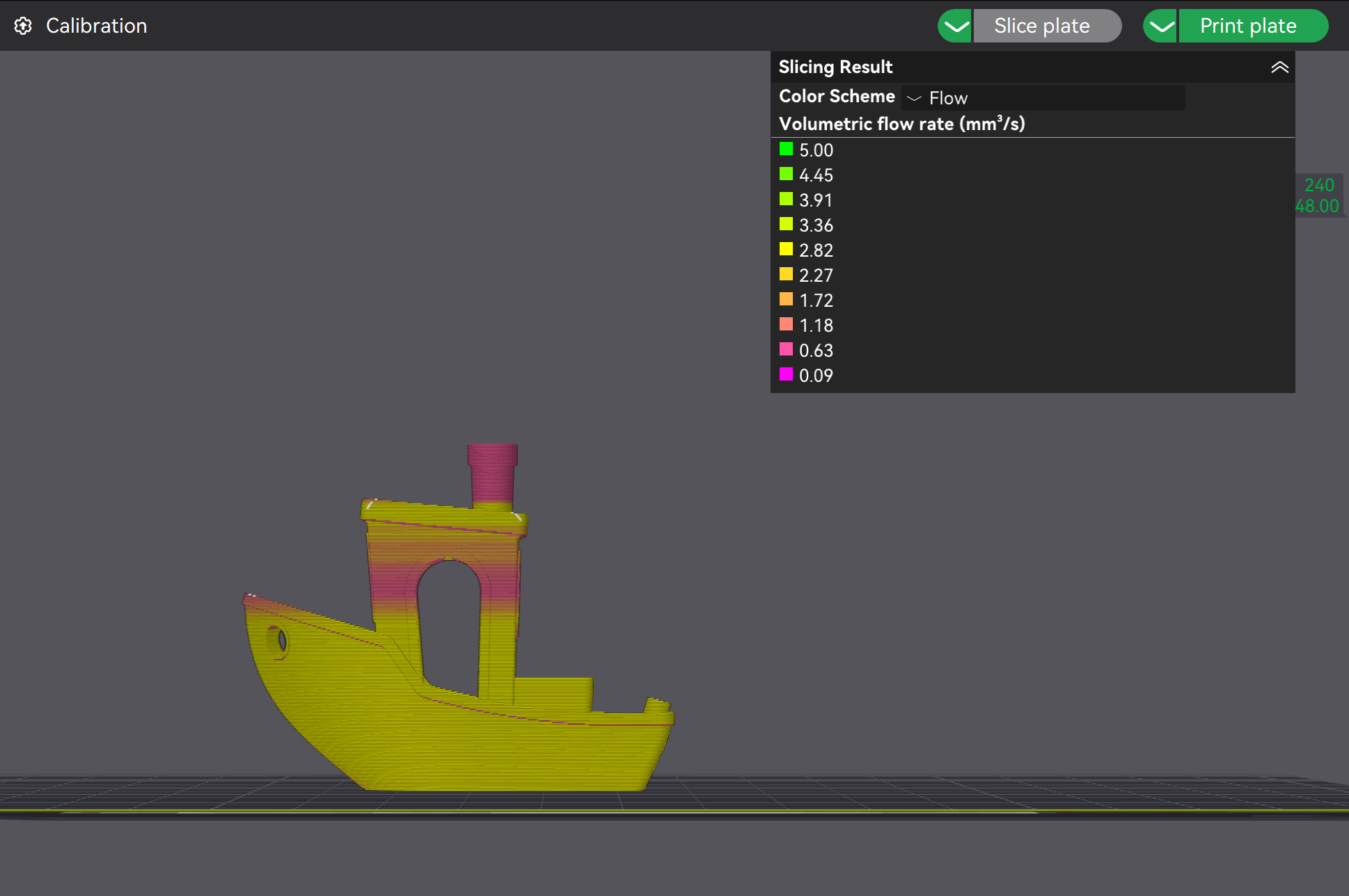

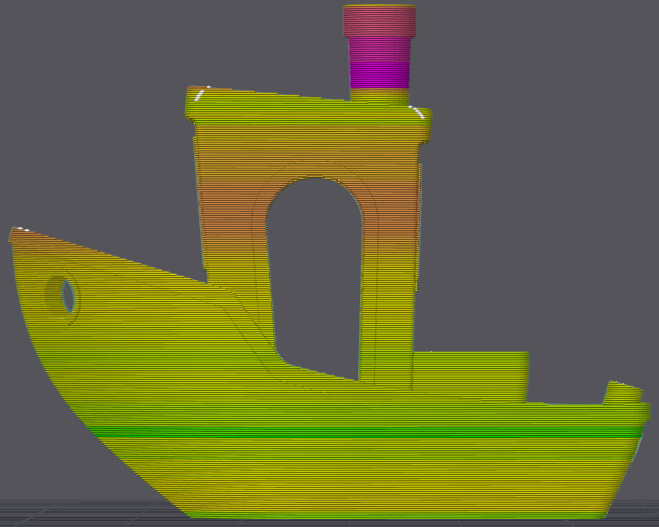

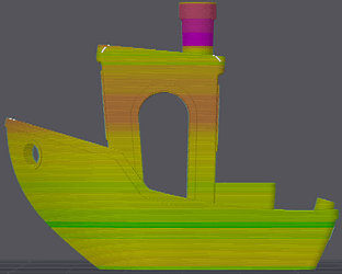

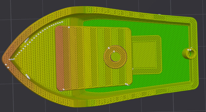

What I find interesting is the layers where the layer time is short, worked the best in your benchy. Oddly, anything in the 20 seconds and lower is printing decent, and anything in the 30 secs+ range is really bad (clogged nozzle-like). I can’t put my finger on a reason for it though. 5-10 seconds difference in the layer shouldn’t make this large of a difference. But I do think this is telling us something, even if it is not the actual problem.
The yellow and green areas appear to correspond to the problem areas where the orange areas appear to be better areas on the print.
It may be just a coincidence, but I tend to not discard these type of correlations and just let them sit in the background of the troubleshooting process, and use it as a cross validation for other symptoms.

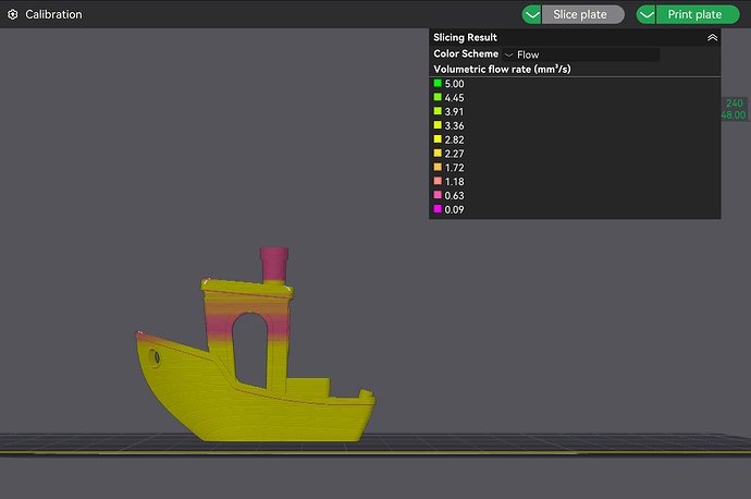

One other thing to try for the sake of testing. Change the filament’s max flow rate to the same value of the sections the worked well. In this case I find the maroon/pink sections printed well, at 0.8mm - 1.2mm/s3. I know it sucks and is not a fix, but I think it could be useful to figure out what is going on.

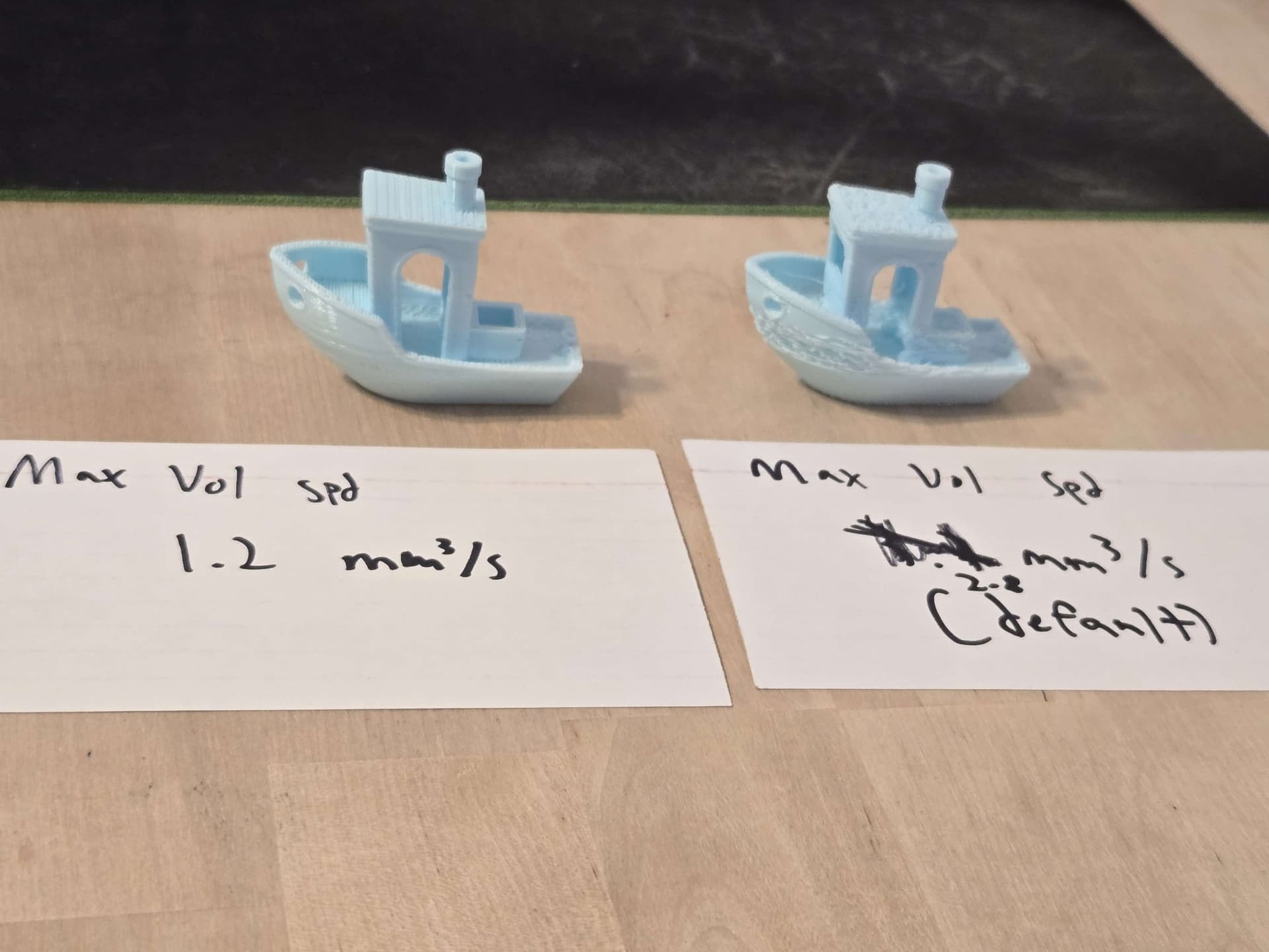

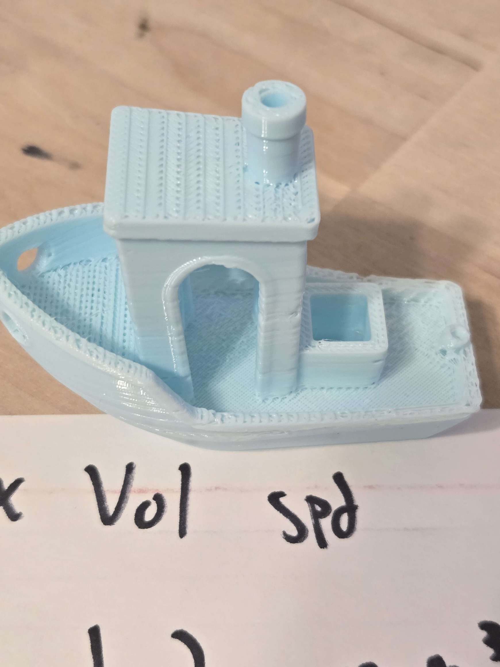

This is very interesting and I have just started a print with the max volumetric speed set to 1.2mm^3/s.
The print is looking surprisingly good!
Its disappointing to have a benchy take almost 3 hours, seeing as how my end goal is the whaleberry shoes lol. However, what isn’t disappointing is how this looks to be working.
The next question is why doesn’t the default 2.8mm work and is there a way to get it to?
After this, I will try other settings and find a sweet spot maybe?
Parkwad-3DBenchy-TPU90A_1.2mms3.3mf (2.5 MB)
^CURRENT (from screenshot)
Next I will try a 2.0mm^3/s to test the upper limit.

This worked out much better.
However, where the layer time increased, it started having the issue again.
The steering wheel also had the issue, along with the base of the chimney.
Would the solution be a different setting, or once again lowering the max volumetric speed?
