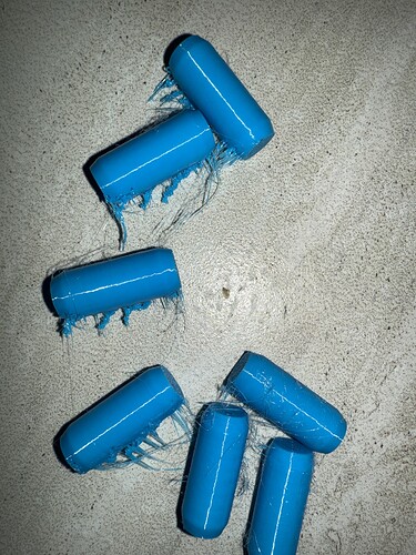

I’ve been having extreme stringing issues with the Bambu TPU 95A HF for a while now. I’ve never been able to get an acceptable amount of stringing print and need to change that. I just tried to print some cylinder shaped objects but the stringing was absolutely terrible and I can’t figure out how to reduce it.
I have the P1S and the TPU has been dried for 16hrs at 65C and all the settings are defaults.
Stringing apart, those type of prints will have better results if printed by object.
You can try dropping the nozzle temp 5 deg at a time until you get the the minimum recommended temp to see if that helps. You can also play with retraction settings.
It is the nature of TPU to string from object to object. That is why one gets the best results printing one object at a time or printing by object as ElektroQuark pointed out.
