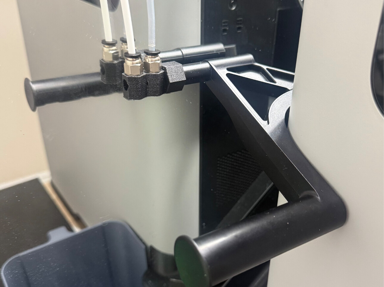

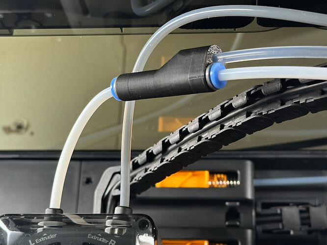

Bambu 95A TPU prints fantastic on my H2D. It’s a pain to route it constantly, I’m working on a y-adapter to fix that… the current process/workflow really seems like an afterthought from Bambu.

As other have mentioned TPU for AMS and the most common TPU 95A print like a dream on the H2D. There are a bunch of solution to make it plug and play and hassle free:
TPU 90A and 85A can be more challenging. For those two bambu has come out with this:
Also there are a bunch of other simpler solutions for 90A and 85A such as this from one of our forum memebrs:
