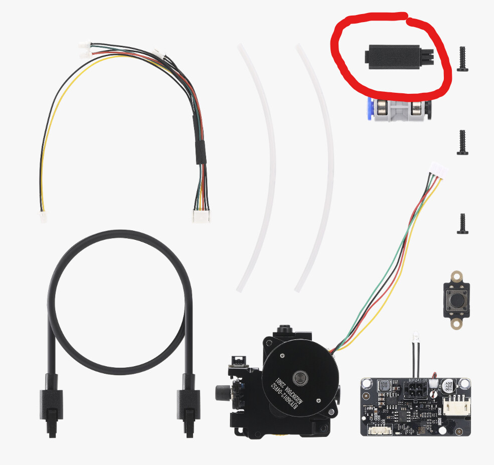

We have a few TPU assist modules. In our most recent one, we damaged the 4pin to 6pin Adapter. We asked to purchase a replacement and were disappointed by the answer:

Does anyone know of alternate sources for this part? I’d rather not make a custom adapter unless it’s my only option available.
I couldn’t find the adapter itself; it seems to be a custom-made connector. The demand for 4-to-6-pin adapters is likely to be extremely low. However…

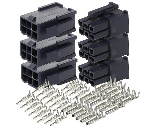

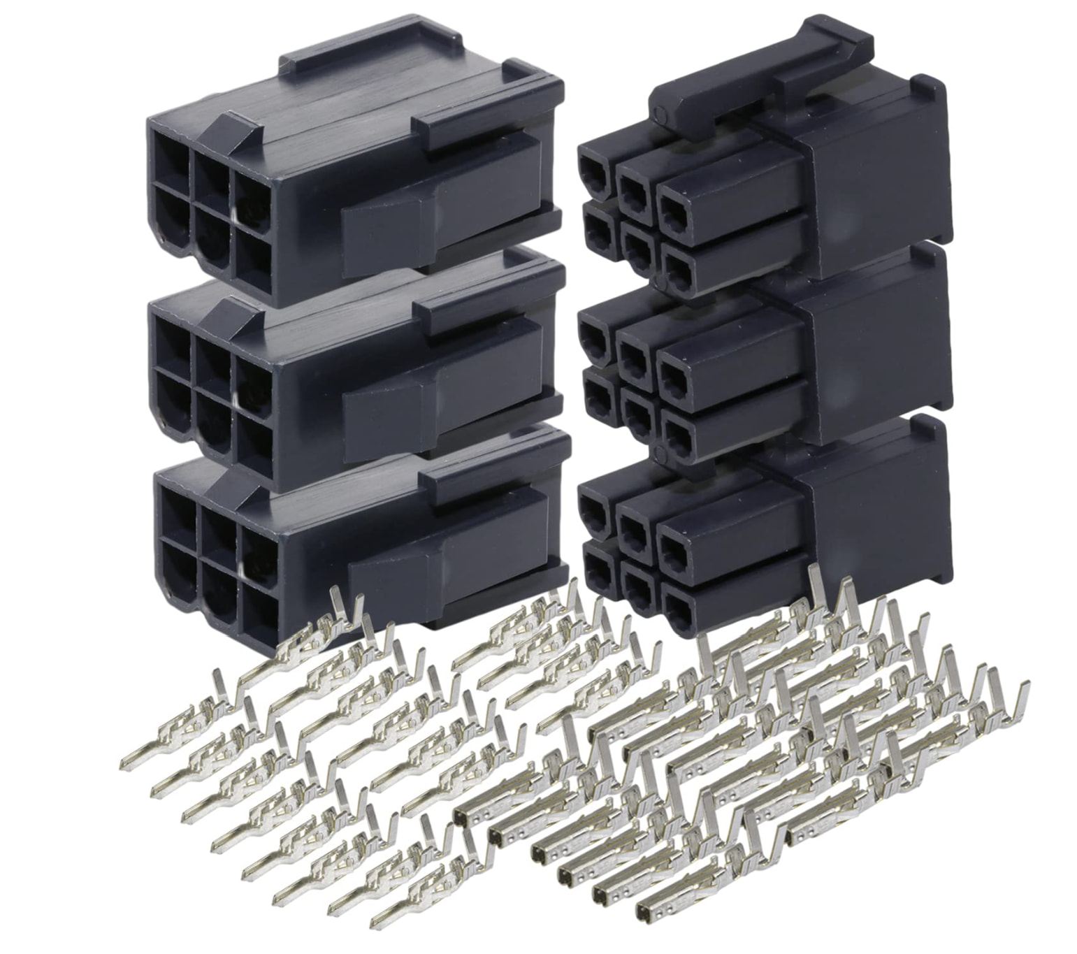

Are you able to open the adapter somehow? Those should just be standard Molex pins that you can easily swap out, actually. No guarantees, though… or is the entire adapter broken?
The cheapest option would probably be to buy a 4-pin Bambu Bus cable on AliExpress, cut off one end, and attach a 6 pin Molex connector to that end. That’ll cost you about 10 dollars. Then you’ll have a whole cable that looks neat without any adapters.
Can I inquire as to how you damaged it? Perhaps it can be repaired?
