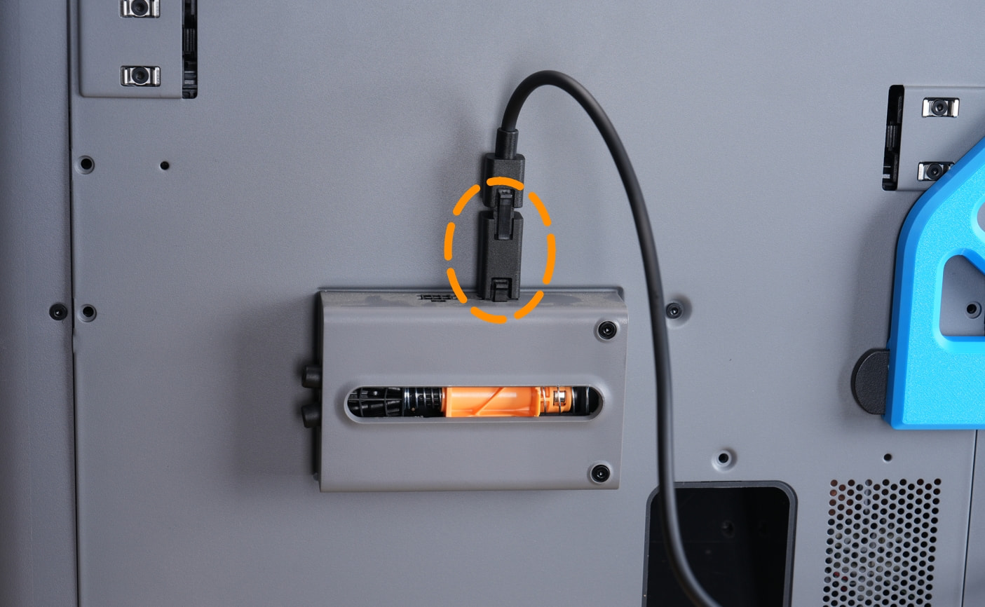

You are supposed to use the included adapter and plug it in here:

To install a buffer you need to remove a rear panel and the socket is a flat cable and not a 4 or 6 pin socket. Again, there is no visible external socket.
That’s precisely a filament buffer it’s connected to, but that’s a piece of hardware that needs to be purchased separately.

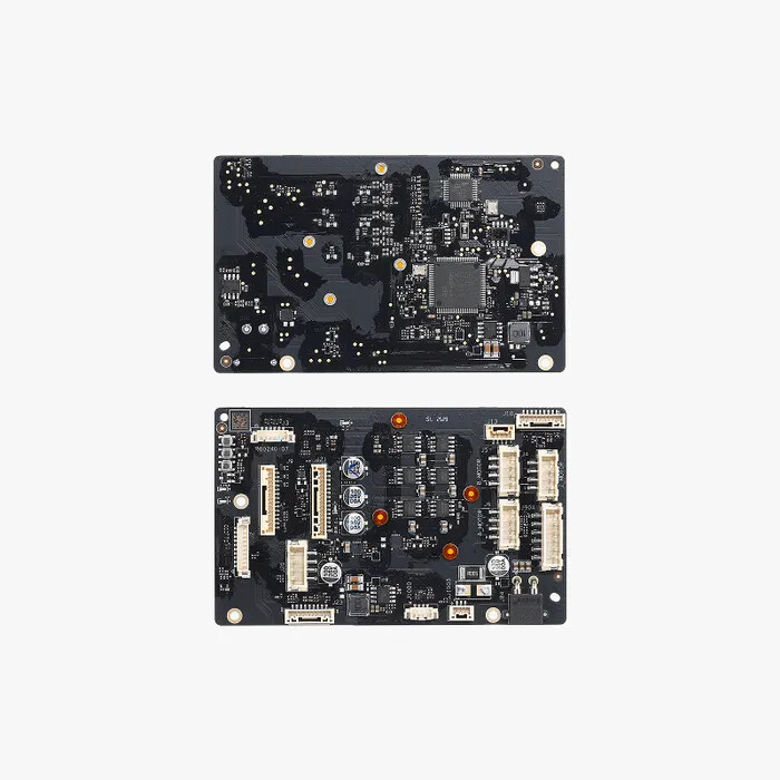

Or if you’re handy with soldering and modifying you can try to tweak the connections to make this board work. The buffer is connected to what apperas to be a 15pin JST-GH connector from the printer and this board has a 12 pin but as you only need 24v and ground, that shouldn’t be too hard.

After a long and repetitive exchange with Bambu Lab’s technical support chat bot it turns out that you need to remove the rear panel, plug into the main control board where there’s a designated 4-pin socket and then pass the cable through a hole in the rear panel and put the whole thing together again. Sadly there’s no description for this particular printer. Thank you all for your suggestions

there is no 4 Pin connector on the P2S main control board

please be aware, that there is no 4 pin connector on the main control board, the P2S does not have one, there is no other way besides using the buffer, the chatbot might have started mixing things up with the H2 series or other printers but i can promise you there is no 4 pin connector there
the buffer is the only option to connect 6 pin or 4 pin (with an adapter) device to the Printer
