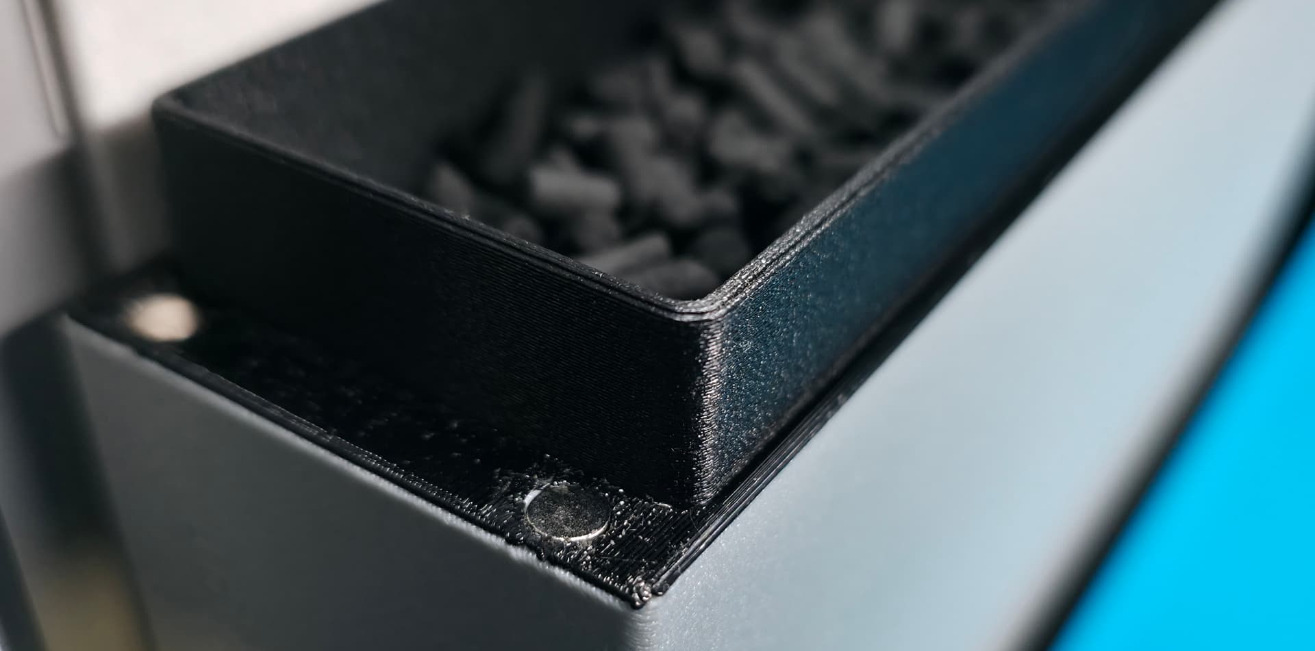

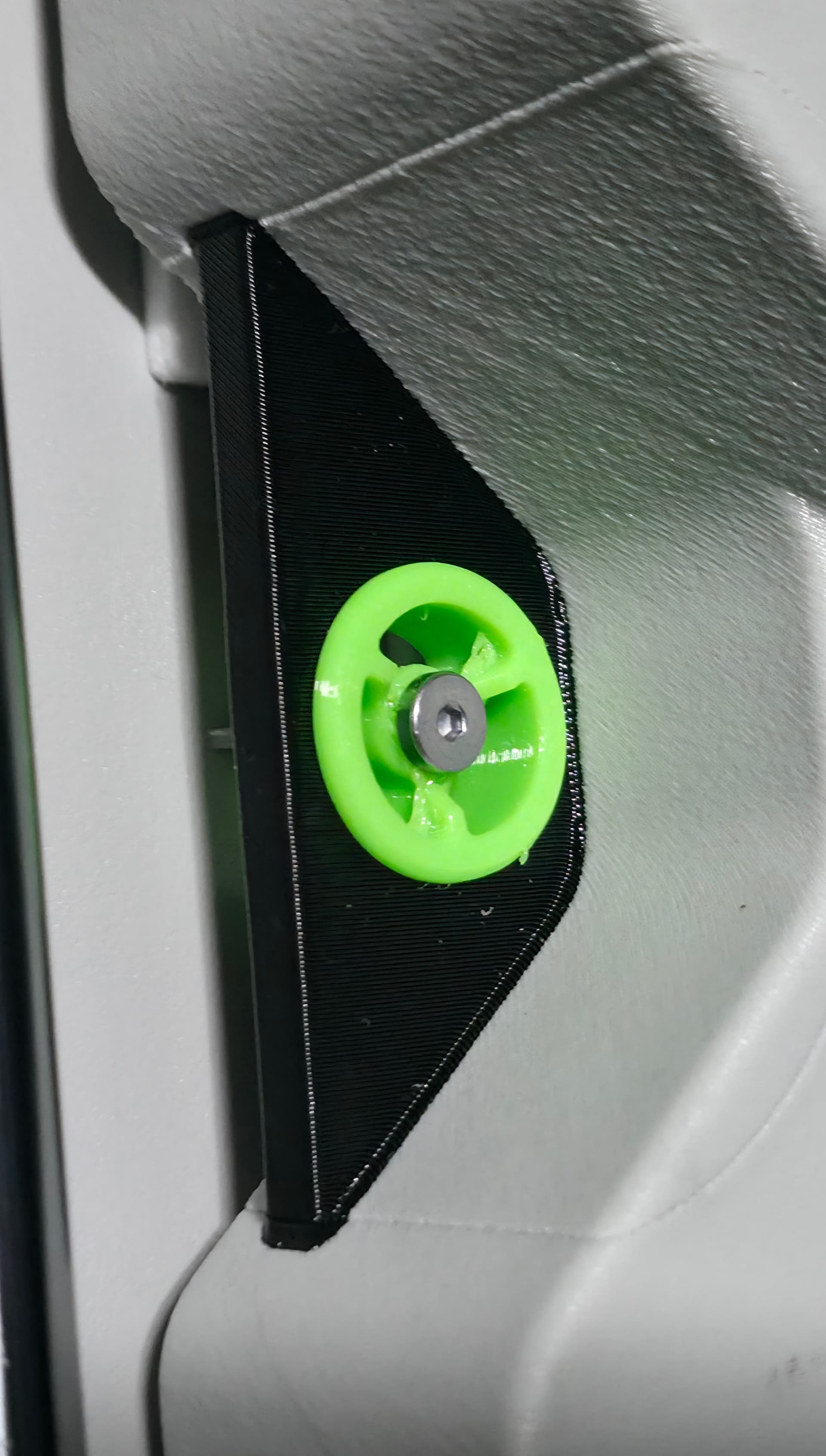

If you can use ASA-cf, it should be easy. just underheat the chamber a little. Ive never tried it with non cf asa, but these below are 95a/ABS-GF mix. I believe I ran the chamber at 45c. Maybe for non cf, just add glue, if its not the tpu touching the bed first. If youre worried about layer adhesion, run the asa 5c hotter
Green is tpu
Black seal is tpu
Black and Green are tpu
