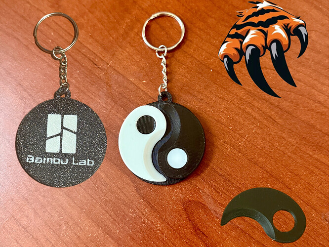

I did find a few good uses for it:
I also use it is some dual material H2D TPU prints, 95A + TPU for AMS. When I need one part of the print to be more stiff.
