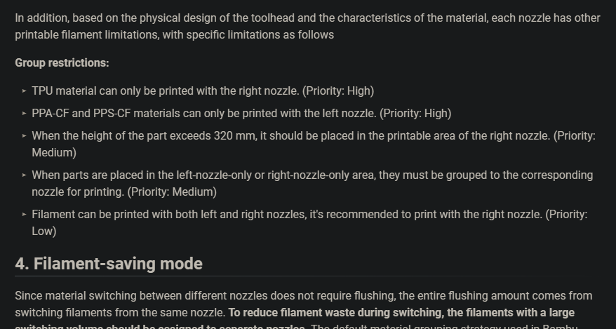

on the wiki
they mention TPU need to be printed using RIGHT nozzle
and they talk about TPU material so all TPU, for me that also include TPU for AMS

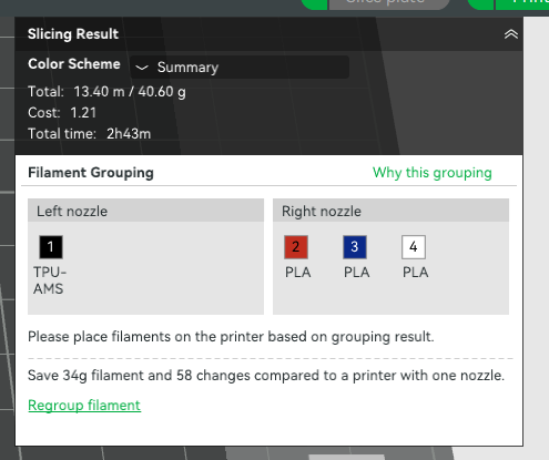

so why does studio tell me i can print it with the left nozzle ?

TPU for AMS says right in the name “for AMS” meaning you use it in AMS without using the bypass hole or any other restriction like right or left hot end. Its 68D almost as hard as PETG and PLA.
I understand this can be confusing at first but when “TPU” is mentioned it will mean 95A majority of the time. TPU for AMS and 90/85A will be referred by their full name as they are a specialty TPUs.
Bypass port on the AMS HT is for 95A and PPA/PPS, but its pretty much a glorified external spool holder at that point. Its mainly useful if you live in a humid environment and have a super long TPU/PPA/PPS print, so you can dry and print at the same time.
TPU FOR AMS is relatively stiff for a TPU, and it handles the buffer inside your printer without any issues. It’s also not brittle, so it’s unlikely to break due to the PTFE paths of either the left or right tool head.
However, for TPU 95A or softer, it’s recommended to use the right nozzle, as the left tool head moves during printing, which could cause problems.
Indeed its not only recommended its restricted in the slicer and printer firmware. It wont let you print TPU from left nozzle.
