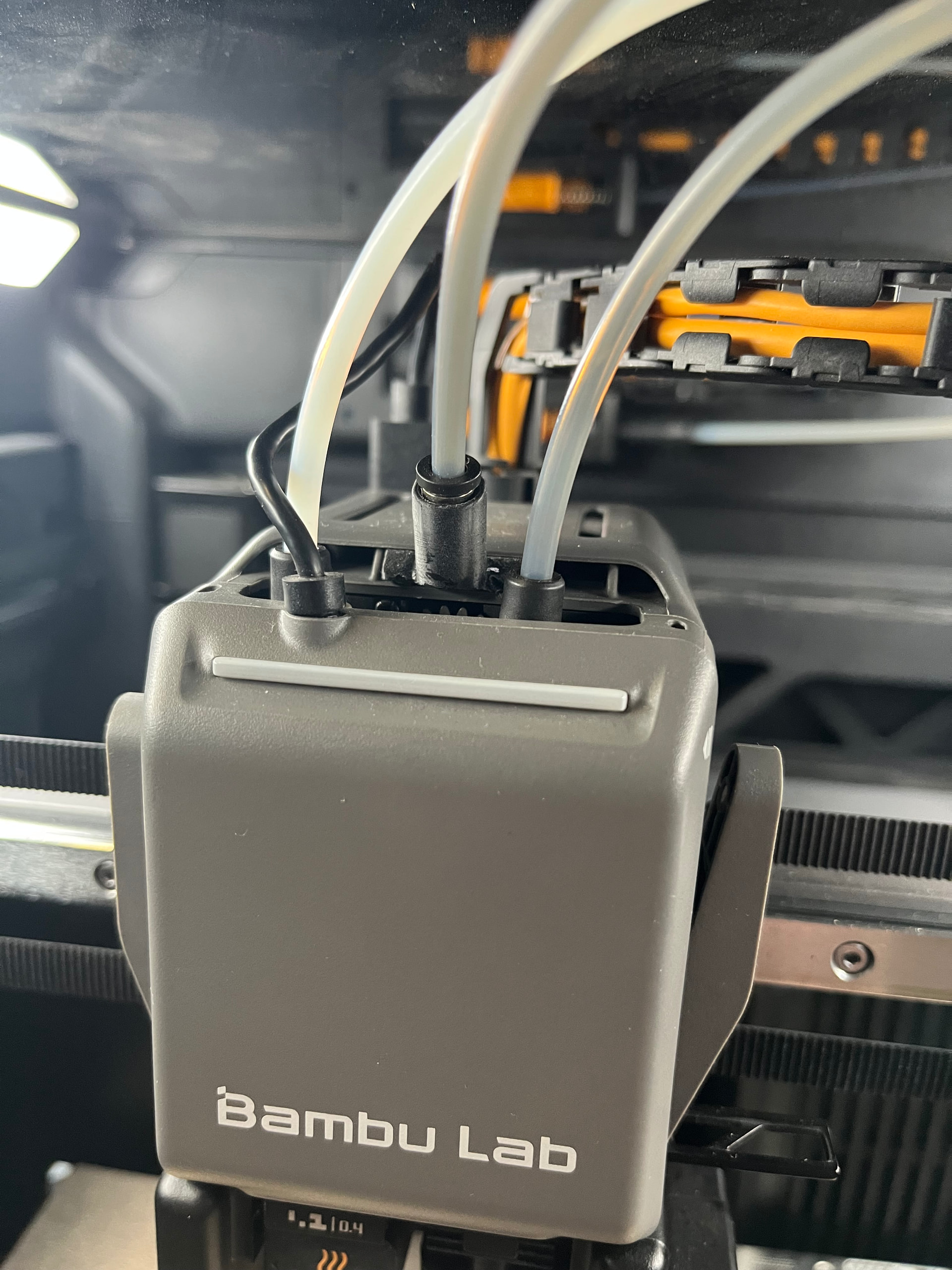

Here’s what I use. I did not want an extra adapter in the chamber on the cable chain as some did. I don’t print TPU too often so I just swap my PTFE at the toolhead when needed.
Is that some kind of a two-to-one adapter? It looks like it’s mounted to the toolhead.
Are you using the TPU assist module?
No, it’s just a resting post that clips on the fins in the middle of the toolhead. It just includes a clip connector taken from a 4-in-1 adapter to keep the TPU PTFE tube in place.
