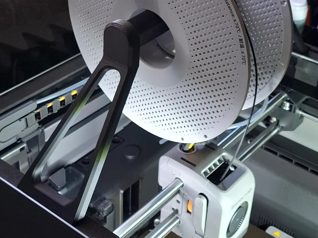

Direct feed into the extruder using a top mount spool is my go to. It just works the best.
You could run it through the port on the top left. They key is to try and get the filament path as short as possible.

Print a top mount spool holder. I know that you do not want to remove the ams, but there is no reliable way to print tpu without it.
Agree, however i would qualify that anything softer than 85A needs to be top mounted

In bypass mode, yes. TPU for AMS can be used in both AMS Pro 2 and the AMS HT in standard mode. TPU 95A, 90A, 85A can only be run in the AMS HT in bypass mode and fed into the printer directly or with the TPU helper. Anything less than 85A must be directly fed into the printer. Using the TPU helper, you are mimicking some of the AMS HT features.
I use BambuLab 95A HF (it’s also a bit harder than regular 95A) and I never print from AMS. AMS compatible TPU is even harder. If it’s TPU, it should be flexible :slight_smile:
