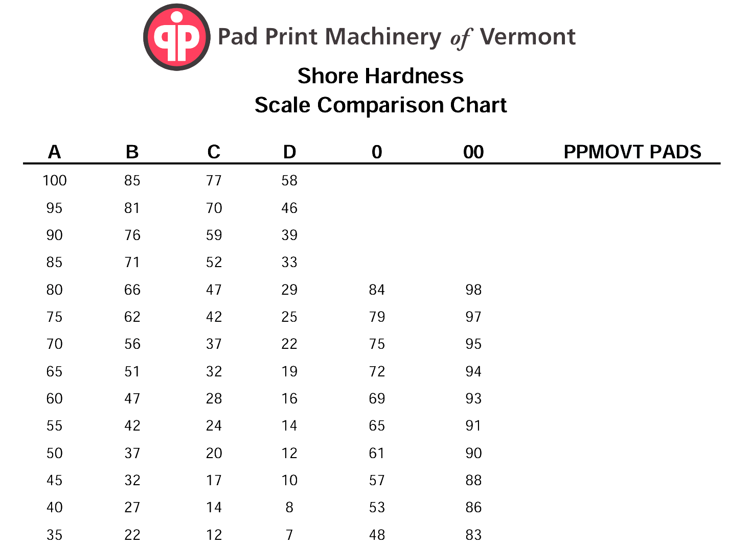

Unfortunately, it does not say whether A or D. But only TPU 58 Shore - Transparent
If it’s A, it will be soft and elastic, like a rubber band.
Considering this chart, 58D isn’t that soft. Is it a crazy spaghetti-like 58A?
58a is like cooked spaghetti, while 58d is like the uncooked one come in from food bag :stuck_out_tongue:
