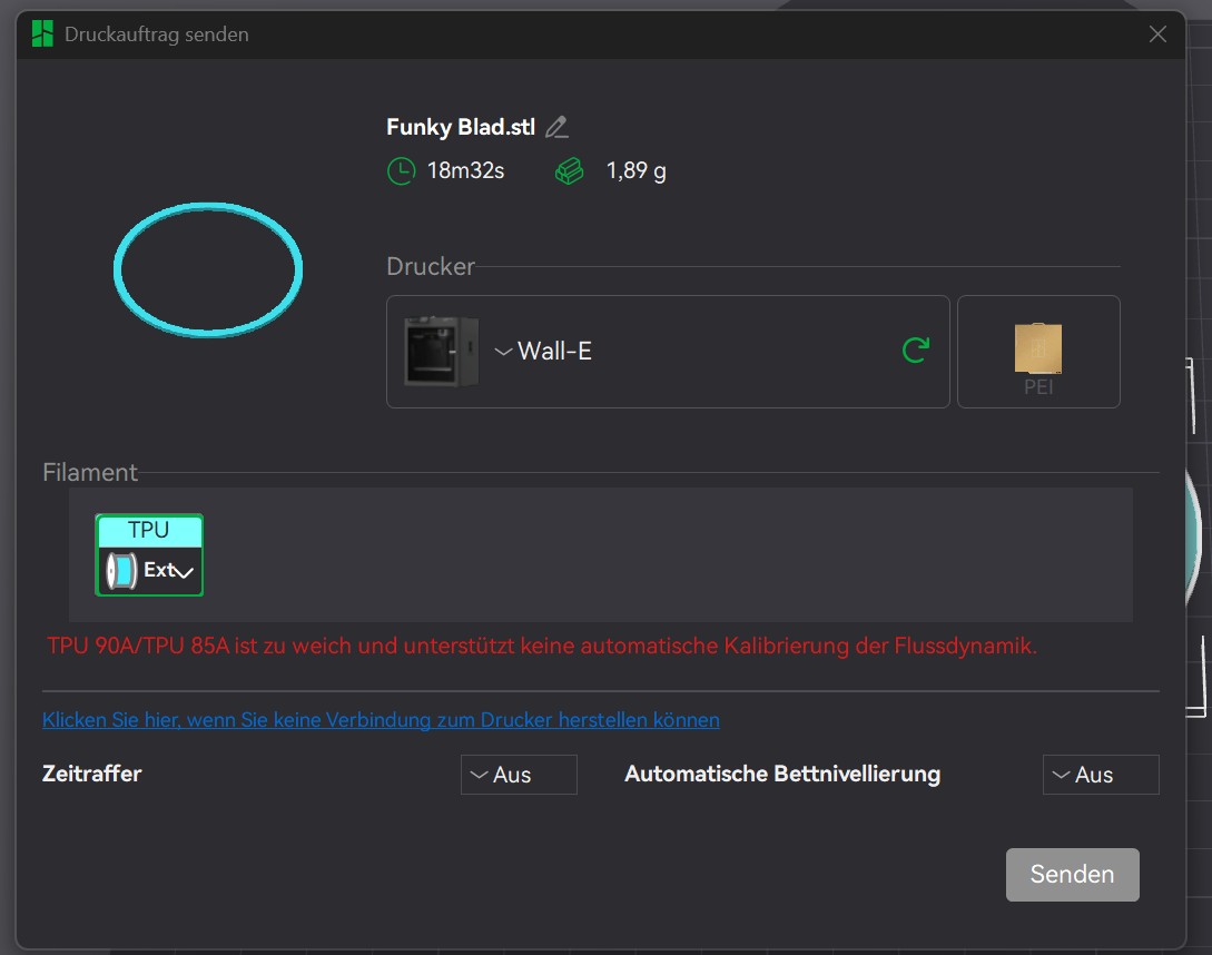

Hey everyone, I’m currently trying my first print with TPU85a, and it’s turning out to be quite a challenge. I’ve followed all the necessary steps: installed the 0.6mm nozzle, removed the PTFE tube, and fed the filament directly into the extruder. However, my P1S tells me that I can’t print TPU90 / TPU85 because it can’t perform automatic calibration with this filament. But the P1S isn’t able to do that anyway, right?! How can I bypass this message?
Best regards!
I have now downgraded to Bambu Studio 1.9.5 and overwritten the TPU95a parameters with those of the TPU85a. At least it’s printing now. But this can’t be a solution. Does anyone else have this problem?
