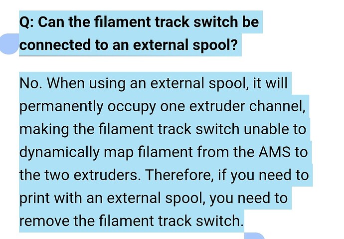

I have a roll of Bambu Lab blue glow for a project. I have the X2D with filament track switch and AMS2 Pro. When I load the glow into the AMS it throws multiple warnings that glow will hurt the AMS gearing and to use the external spool. I cut my PTFE tubing and inserted a splitter just for the glow and when I insert the filament manually and ask it to load from the sternal spool it throws an error asking me to remove the filament track switch. So I unplugged the filament track switch and tried to load from the external spool in the touchscreen menu again. It then says No track switch detected, insert filament track switch to continue. So I go back and forth plugging and unplugging trying to follow on screen instructions and it’s just a paradox. It’s asking me to use the external spool and every time I try to load filament from the external spool it asks for the track switch. If I plug in the track switch and I ask to load from the external spool it tells me to remove the track switch.

Yes. The printer is still seeing the FTS, that’s why it thinks the FTS is still connected.
Unplug your AMS from the FTS, unplug your FTS from the printer, plug your AMS directly into the printer.

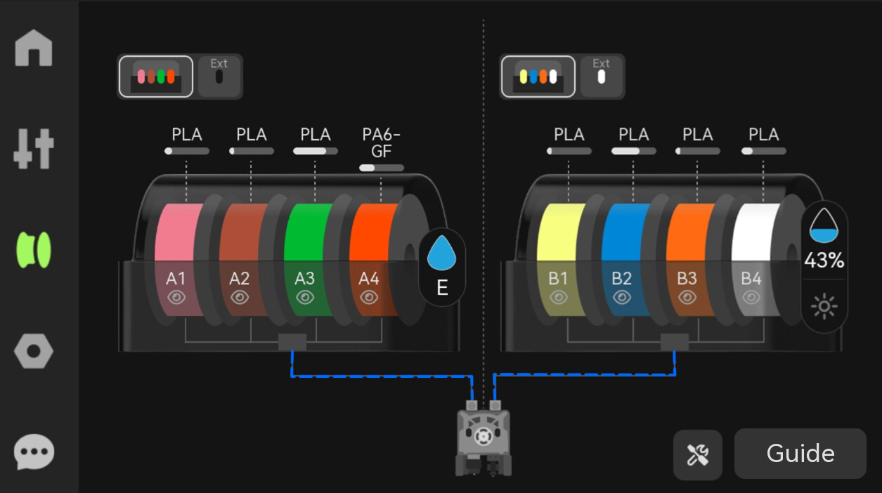

Ok. Fully unplug the FTS from everything, and then turn the whole printer off and back on. Can you post a picture of your filament setup screen after that’s done please?
It’s in the middle of printing right now but that is a good idea. Maybe it won’t let it go until the boot sequence rewrites the map without the FTS being there. I’ll get back to you.
