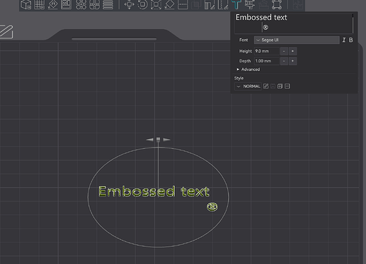

What I am unclear on is how you are representing the symbol. Is this pre-rendered STL? If so, then you’re at the mercy of the technology which may not have the resolution you’re looking for.
On the other hand, have you tried using the text function and letting the slicer render the font? That might have more resolution and would be scalable over a much broader size albeit at each magnification you will have to scale to the next nearest point size.
Here’s how that might work. NOTE: not all fonts in the library have the “Registered Trademark” ® symbol. In this example Segoe(default) does.
In your use-case you would add the ® symbol to your trademarked logo as an assembly, but it would print at near-perfect resolution. Or at least as perfect as the printer can resolve it.
Here’s the 3MF file to see how that was done.
Embossed text.3mf (81.0 KB)

The challenge you’ll find when converting vector formats such as SVG, is that once you bring them into the slicer, the slicer converts them to a Mesh and that’s when problems occur when you try to scale. If you don’t scale the model before importing it, the results are much more faithful to what’s in your design system such as TinkerCAD but as you probably seen firsthand, that’s a lot of trial and error work.
Here’s what I might suggest.
  1. Do all of your logo work is vector-based format you are most comfortable with. NOTE: If you’re trying to convert a pixel-based bitmap to a vector format(SVG) in lightburn, you’ll never get the same resolution as you would in the native file.
  2. Once you have the vector format SVG file, import that as an independent object and then add the Registered trademark as a separate object.
Here’s how that might look:
Th advantage here is that you’re leveraging the vector scaling benefits of the slicer’s own font library for the registered trademark thus not relying upon external scaling and for the logo, you let the slicer scale that independently thus giving you the greatest chance of scaling without distortion.
Embossed text.3mf (449.8 KB)
