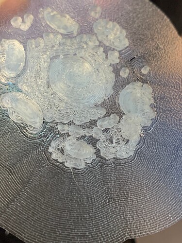

Translucent pla issue
On the initial few laywers theres these small areas of the model that are seperated at first. these little pieces are coming dislodged during the print. any way to adjust the setting to keep them from dislodging?
Dry it.
It will not behave like normal PLA. It needs to be very much dried like petg and it’s always a lot more runny/goopy. Do some calibrations, possibly lower your temps a bit. A flow rate and temperature calibration is more or less essential alongside drying the heck out of it. 50C for 8 hours if you’re doing your drying in a proper dryer/air fryer/food dehydrator and 60C for 12 hours if you’re gonna do it on the bed.
Really make sure your plate is clean as is your nozzle. This stuff is a huge pain to work with.
