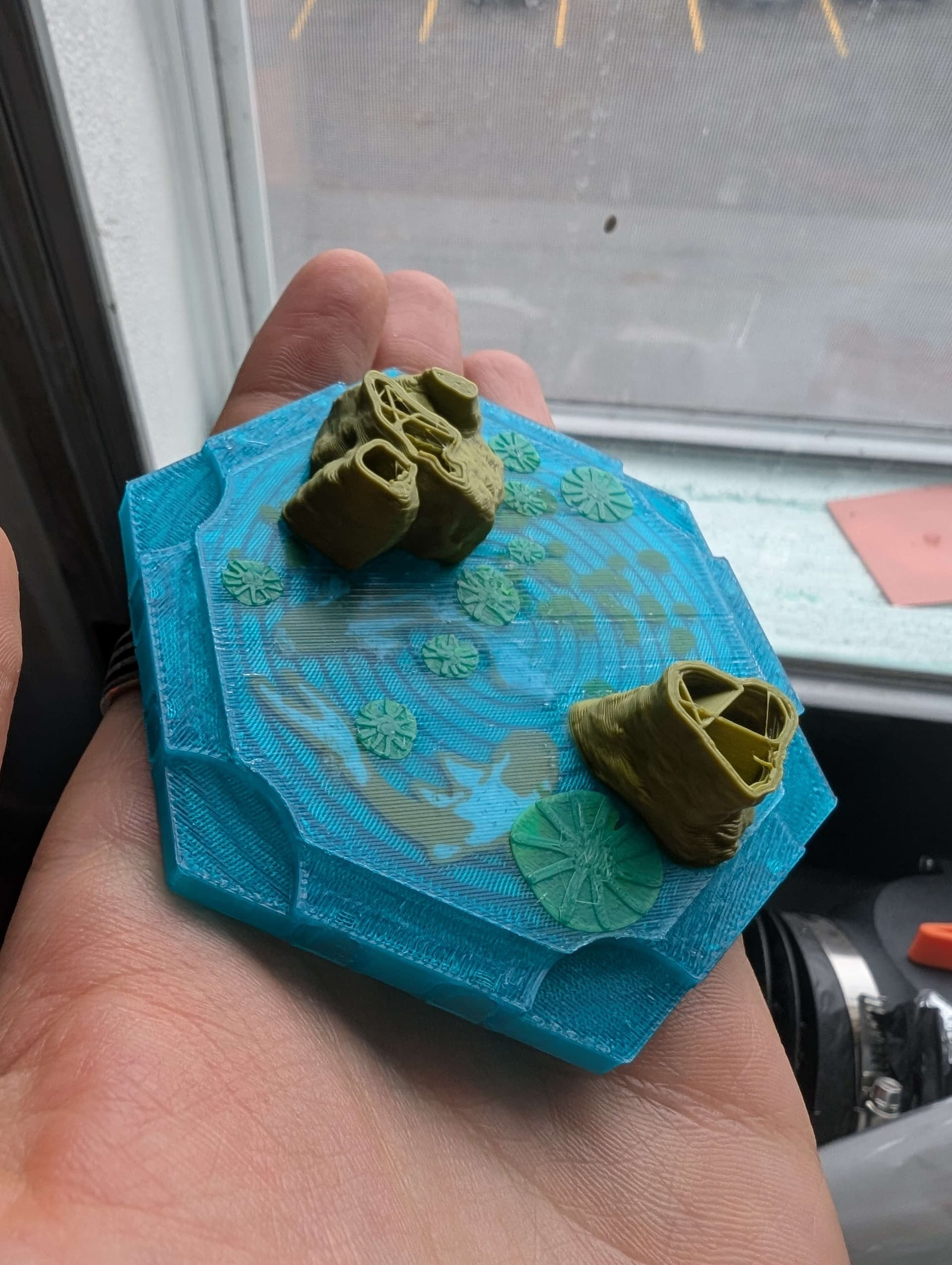

Hello all, sorry for making another transparent filament post, but I have read every forum post and am a bit stuck.
Here is my print! its so close to working, I get nice areas of i would say almost a perfect finish, but then i have these random bits that stick out.
I am doing exactly what the wiki says, plus ironing at 7% (and 20mm/s).
I have also tried to change my extrusion on my filament to 1.02 to try and fill in space better.
Any ideas for what could be causing my problem?
Ironing isn’t perfect, it’s never going to look 100%.
So would it be better to try this without ironing?
Trying that rn we’ll see.

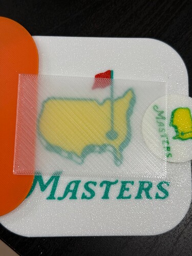

Have you seen this? It is one of mine after experimentation.
It was created before the recent PLA Translucent launch.
I have printed a lot with the new material and have not experienced your results.
I rarely use ironing with any filament, although I have done so for a pending model. That is due to the complications of screw holes, which change the direction of flow and make it look weird.
This is one of a family of models I designed that used the new filaments throughout.

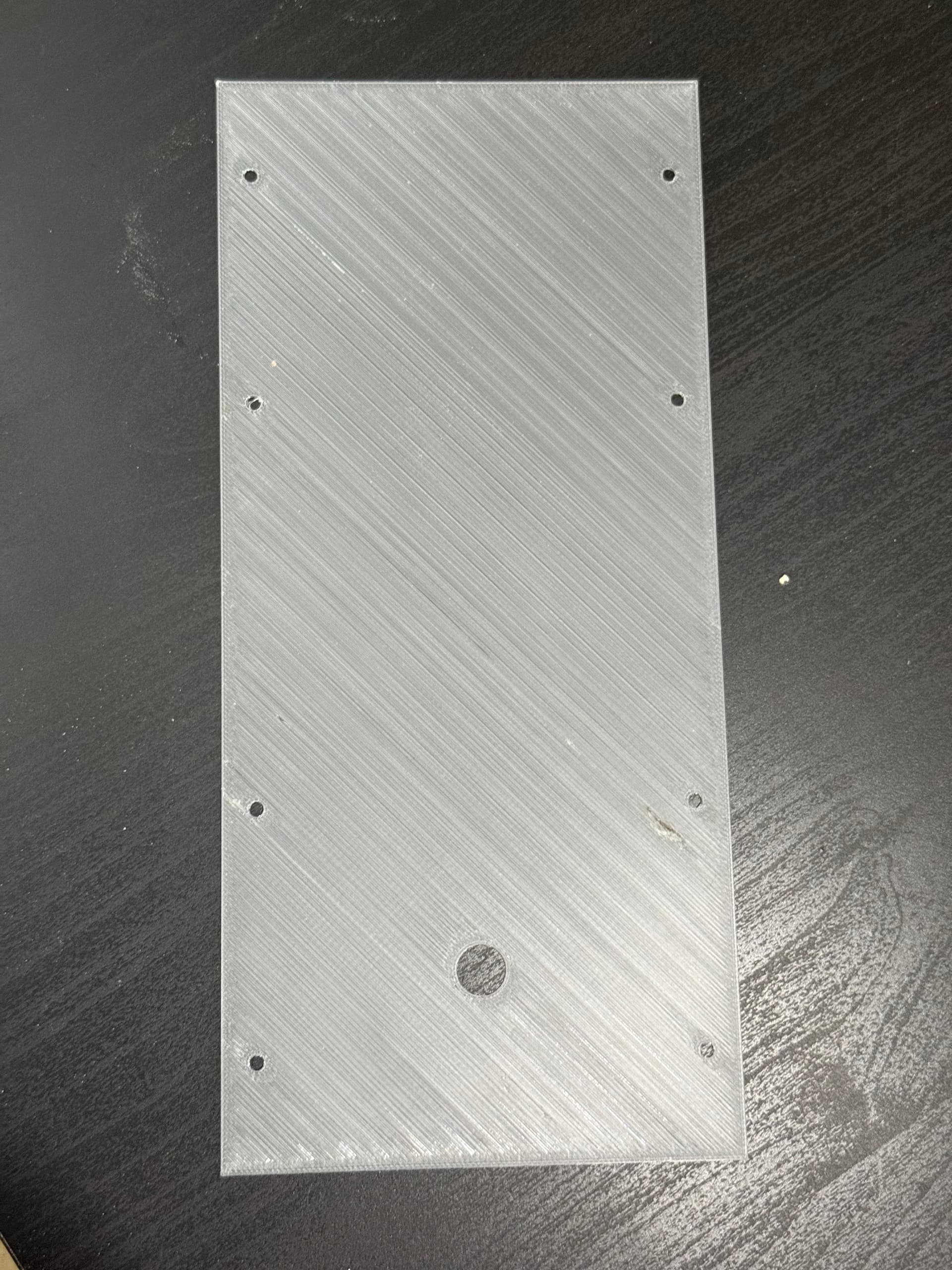

this is without ironing, it seems we have the same finish (ish?) where you can still see layer lines
WOW your speed is high haha, im running the whole thing at 20mm/s
You will always see layer lines.
Ironically, with translucent filament, it becomes more obvious.
The objective is to mitigate it.

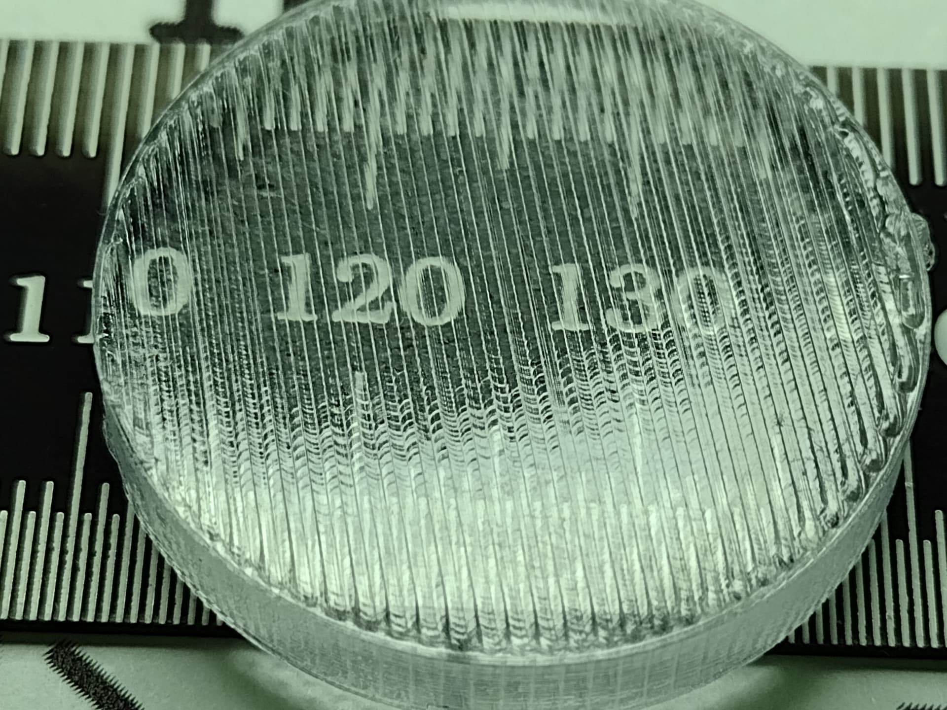

So if I understand you correctly. You read through “all” the posts on transparent printing and you would like to know how to go from this:
to this:

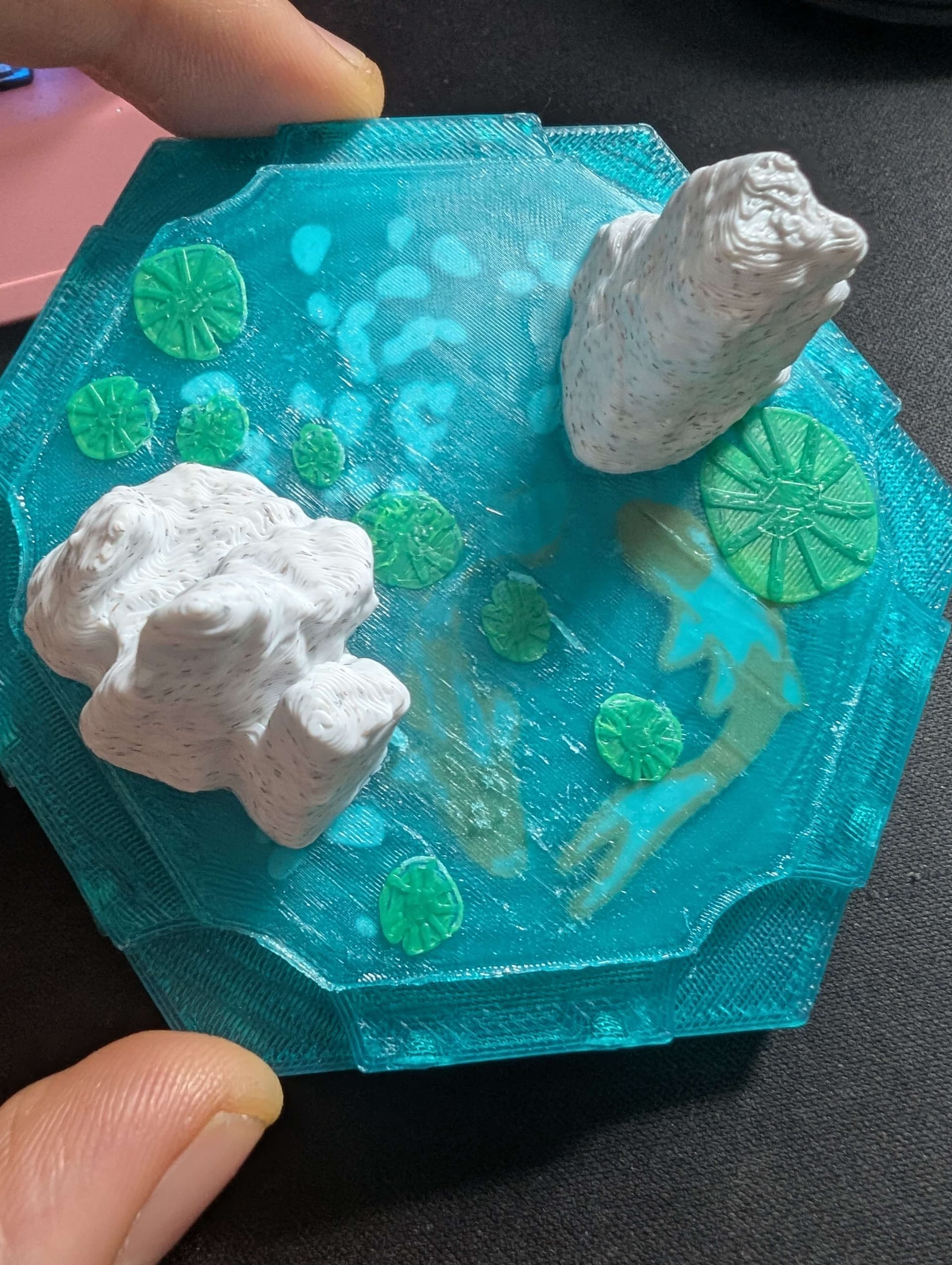

Perhaps just some trickery on my end in calibration.
I am exclusively using bambulab translucent PLA, the darker blue version.
Without knowing which ones you actually used, I can only guess at further improvements, but, I imagine my earlier answer is still the best outcome.
