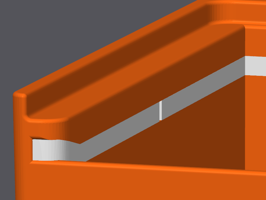

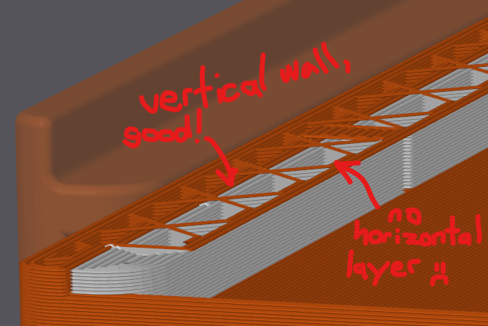

I have an STL (proprietary, so cannot upload it here), which is essentially a hollow box with a shallow groove running around the top edge (I’ve sliced it to make the groove more obvious in the image below):
I have another STL which is the negative of this groove, which I’m able to successfully add as a separate part, placed in the correct position, and set it to Support PLA (with the intent of popping it out when the model is printed):
The problem I have is that when it prints in this configuration, although the side walls of the groove remain intact, the top and bottom layers of the groove are missing (as shown in the sliced image below, taken 1 layer up from after the groove ends). Note the back wall of the groove is in place, but the infill transitions directly from one filament type to the other, without any top / bottom layers where the filament changes and the groove ends:
What I’m looking for is some way of forcing the parts to print all their walls / layers, so that I can just print this insert part out of support material, and then pop it out after printing, leaving a fully-formed groove behind. I’ve tried printing with automatic & manual supports enabled, but printing this part out of support seems to be far simpler & more efficient…
Oh, and yes - the main STL definitely includes a top layer to this groove :smiley:

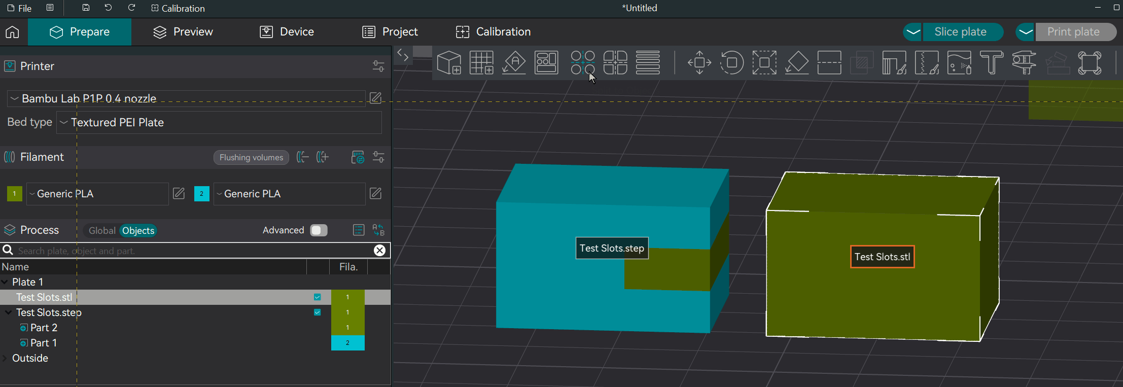

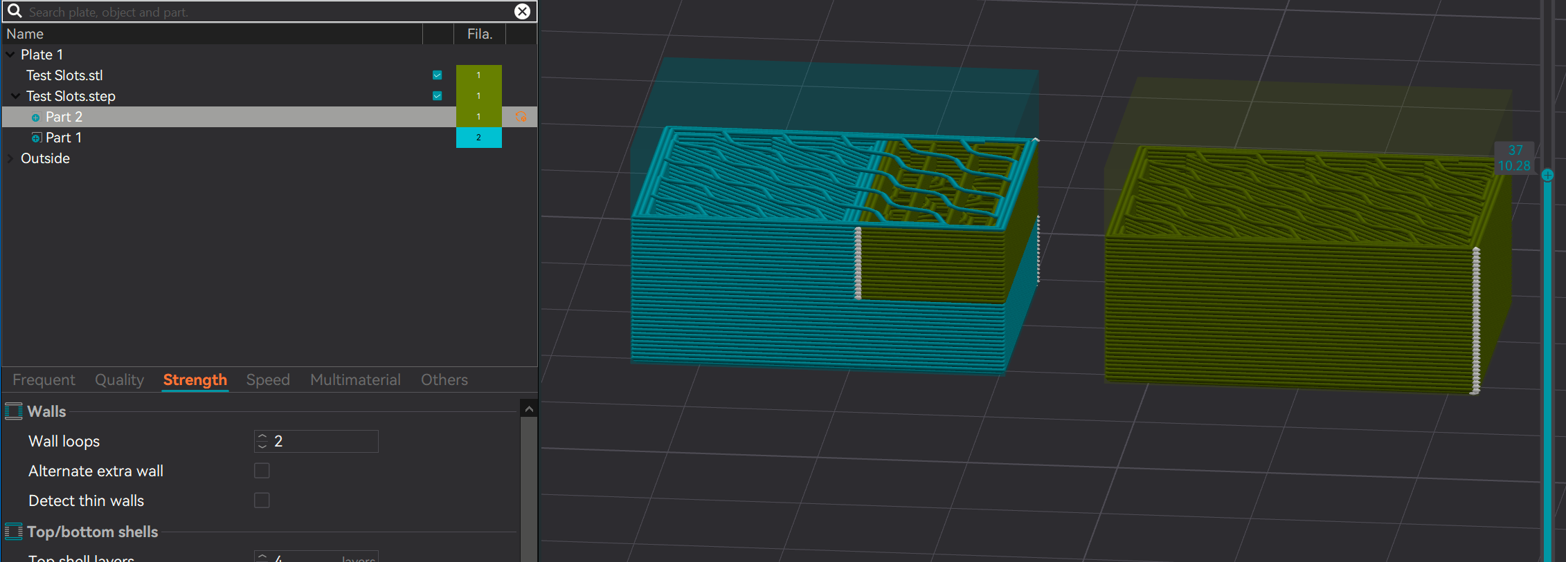

Here’s an illustration. I created a simple cube in CAD with a rectangular notch similar to what you described. I exported the model twice: once as a STEP file and once as an STL.

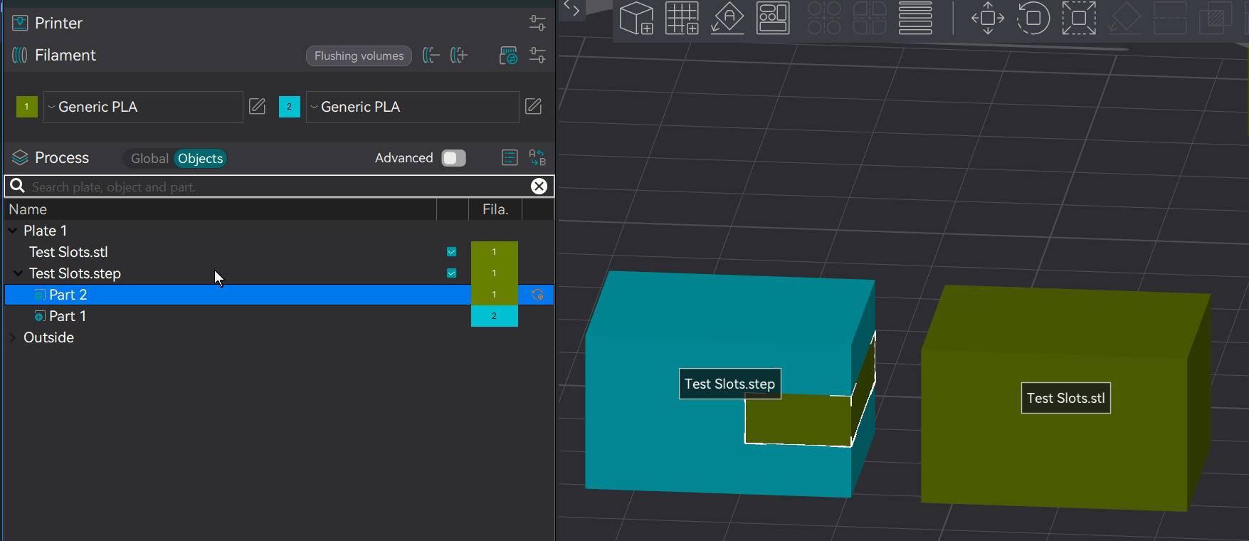

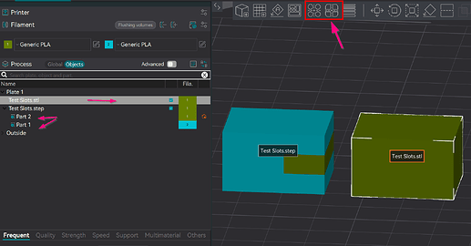

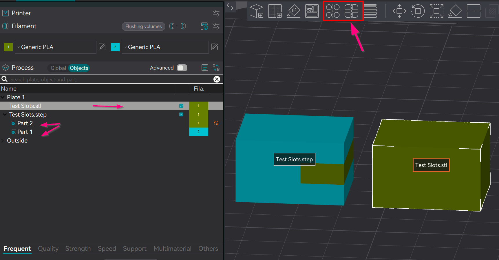

You can see in the screenshots below that test slots.stl has hidden associated objects that don’t appear in the preview, while in test slots.step, those objects are fully visible:
A “blink” comparison might make it more obvious that there are invisible structures in the STL model — they just aren’t visible in the left-hand pane.:
orca-slicer_RZqiBs6Xxu

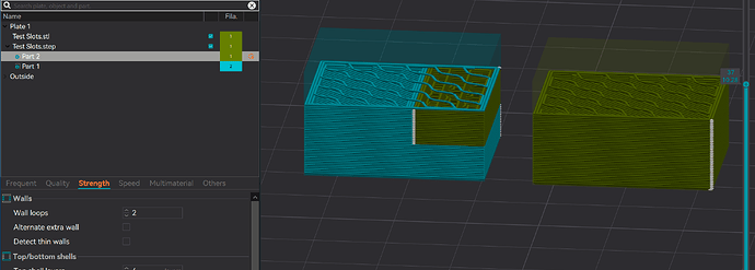

The key observation is what happens when slicing — we get the same type of artifact that I believe you’re encountering with your STEP file:

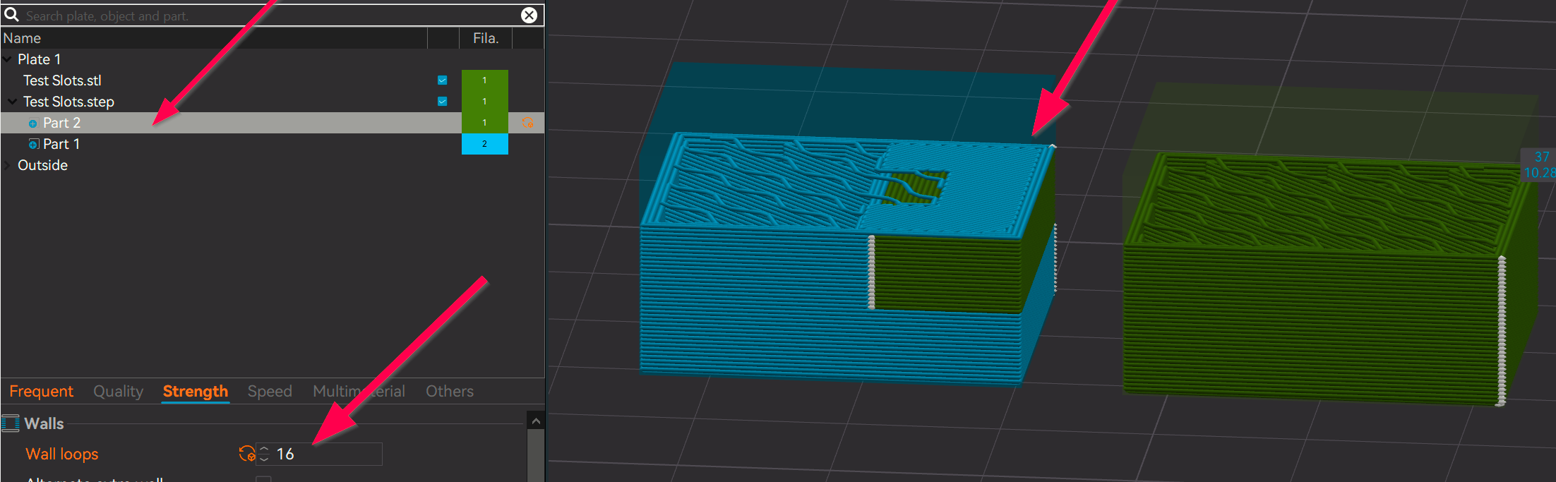

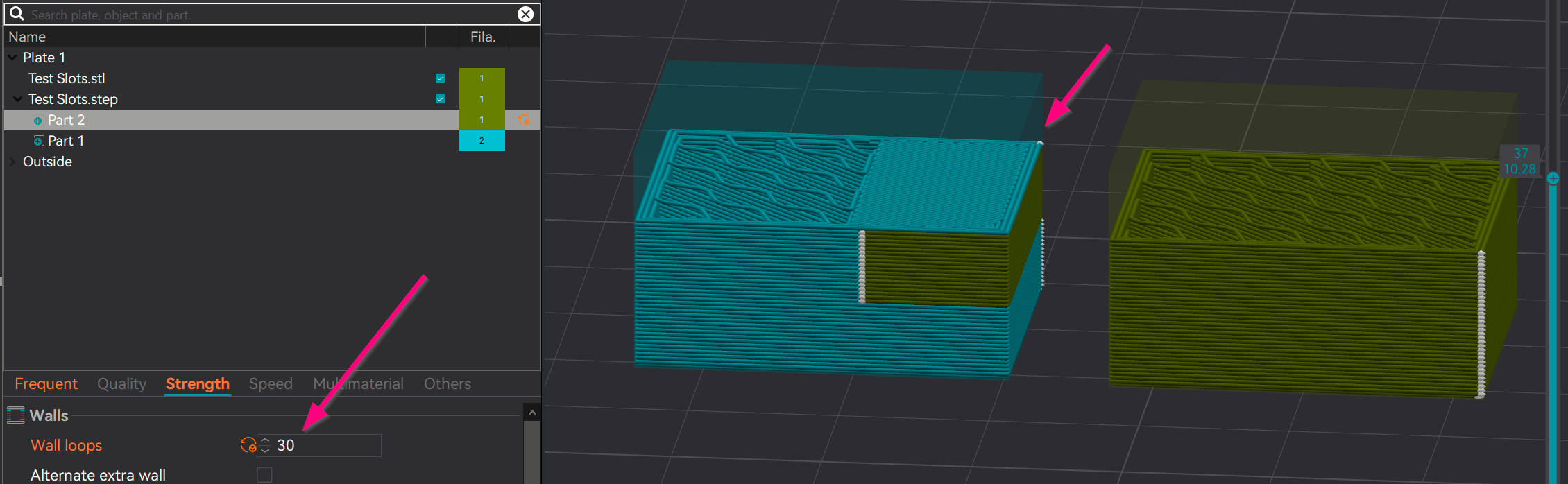

If you still have access to the original CAD file and can export a STEP version, try increasing the number of wall loops. This seems to resolve the issue by reinforcing those weak boundaries. Here’s the progression:
Default
16 Wall Loops
30 Wall Loops
