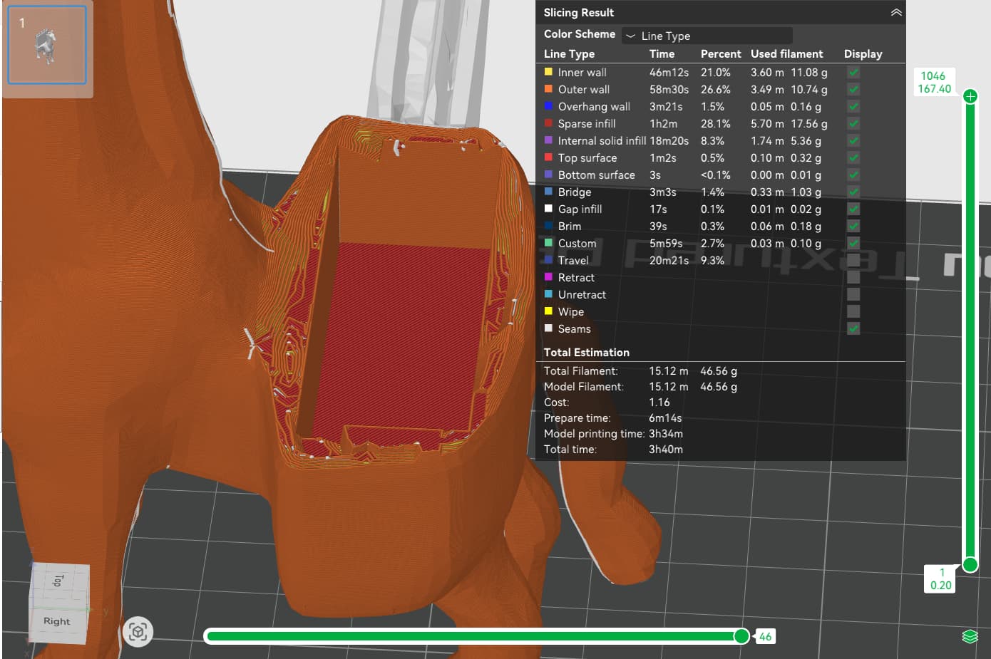

So my friend asked for a giraffe that is a business card holder for his desk. Im not close to done (so its still pretty rough), but one thing that immediately concerned me was: when I add parts or negative parts its no longer deemed as like “solid” I guess. The walls in the pit are solid and walling off the infill making it look clean, but the floor and the “ceiling” on the bottom is still not “topping” off. Even if I add a cube part inside, the top is still just infill paterned. Img to show:

How do I fix this?

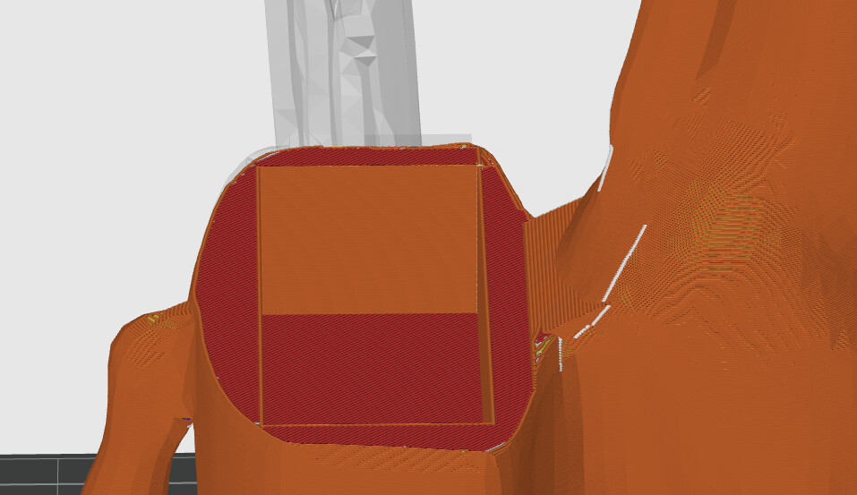

Im referring to the parts like in the crevis the floor is still the color (in the slicer) of the infill and some on the top surrounding the crevis. Ive smoothed it out, but yet its even more infill color. I am worried its not seeing it as solid.
Are you concerned that the red area is infill?
If so, then you don’t need to worry, as that’s just the color the represents the top surface printed layer.
Ah I see, thanks for helping. Sorry Im still getting the hang of all the FDM lingo. So the only reason its different color is because it is actually topped off and the rest is just walled off correct?
Yes, that’s correct. The orange in the picture are walls and the red is the top surface. If you were seeing infill, it would be a much darker red.
You can drag the right scroll bar to see the sliced model layer by layer. This will let you get an idea of what the various line types are.
