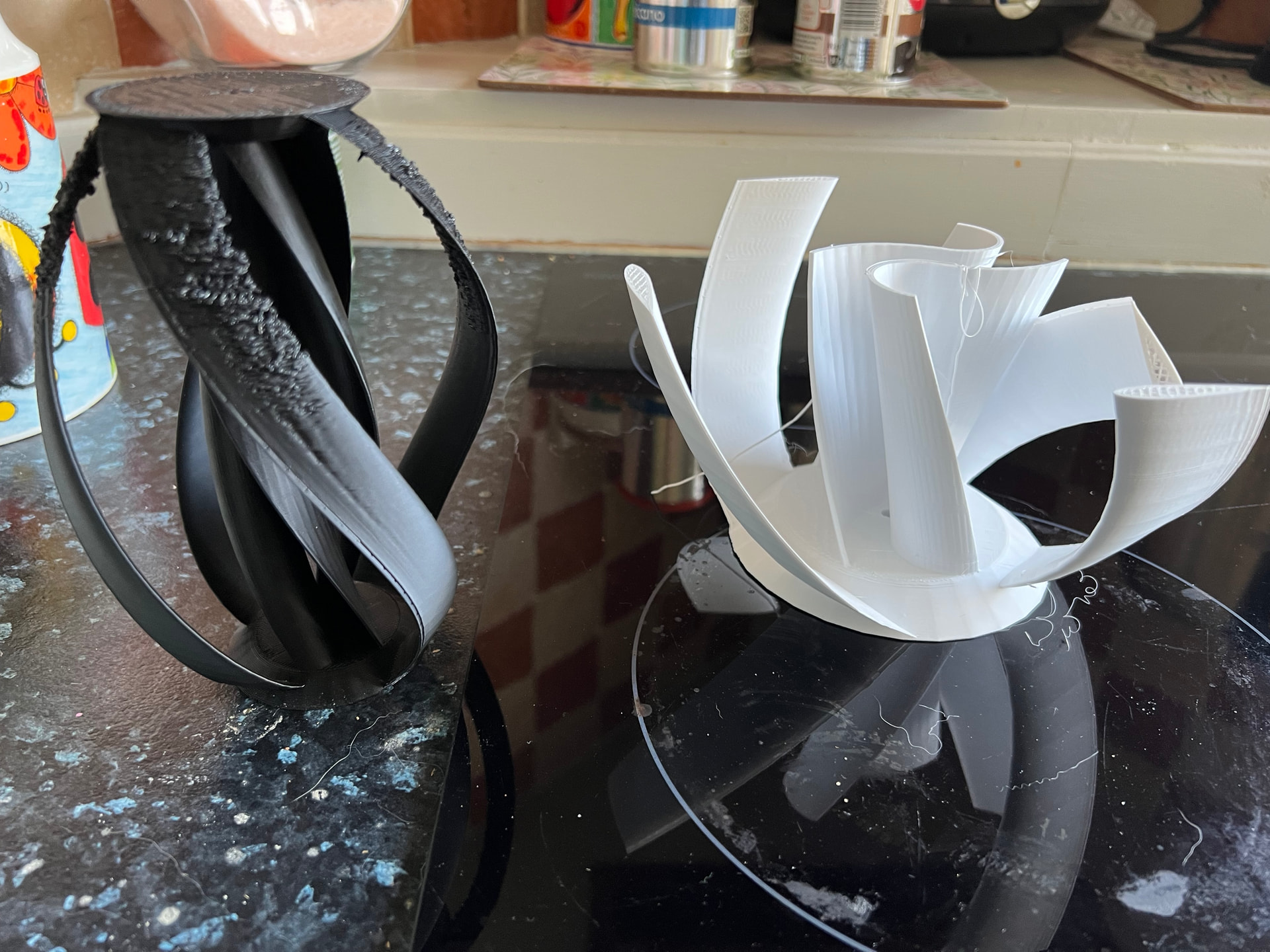

Apologies for the delay. I printed a small version (1 plate) and I have noticed that at the same or similar height that the print quality starts to be bad. Can anyone suggest what is wrong with the model or printer? I am baffled by this one.
Pic below: Small model in black pla +, larger version in white PLA +, both printed with generic PLA + profile. Supports were used where necessary.
Those pics do help:
  1. Really dry filament!!!
  2. Use the paint-on-support tool to check overhang angles in 1° steps. Design for overhangs is often applied in 2D but in 3D, overhangs can increase when angled. => Need for supports.
  3. Long cantilevers => Decrease speed with height, may need “wipe on retract” and/or additional supports for stabilization.
  4. Avoid curling at all cost => See 1., warm build environment, low layer height, slow printing
