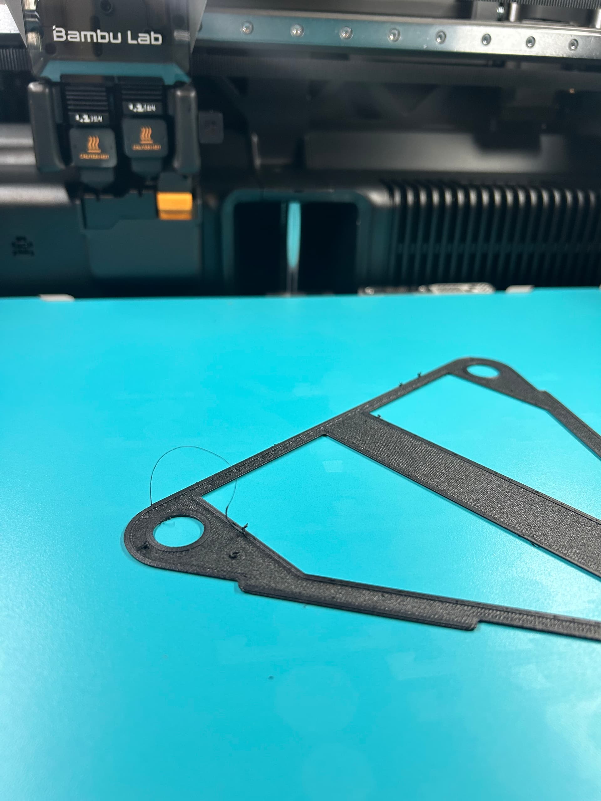

Anyone have recommended settings or experience with Eryone ASA-CF? I keep getting build-up on the nozzle that falls off on the print.
Buildup on the nozzle is often caused but moisture in your filament. How are you drying your filament?
Silly me. I just printed it out of the package assuming it would be dry enough because any that I buy have been dry enough out of the package. I did notice the vacuum seal wasn’t good on this roll so there must have been a hole for moisture to enter! I dried it and it’s printing fine now :slight_smile:
