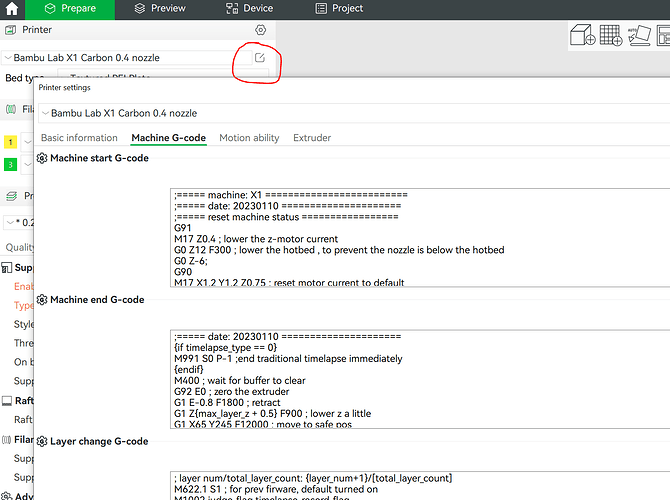

it is probably to melt filament on the tip, like any build up that could mess the bed leveling. Maybe is unnecesary on the X1 since there is no proper silicone wipe area.
I imagine the heating will be defined in the start g-code of your printer, check here:
I do not have that menu choice. If I click in the printer, it just brings up icons of printer choices. The tip heats, purges and then wipes. At that point the heat reduces and the head cleans on the extreme back edge of the plate. Then it moves to center and for some reason, heats up for a few seconds and then backs off. Then it bed levels.
