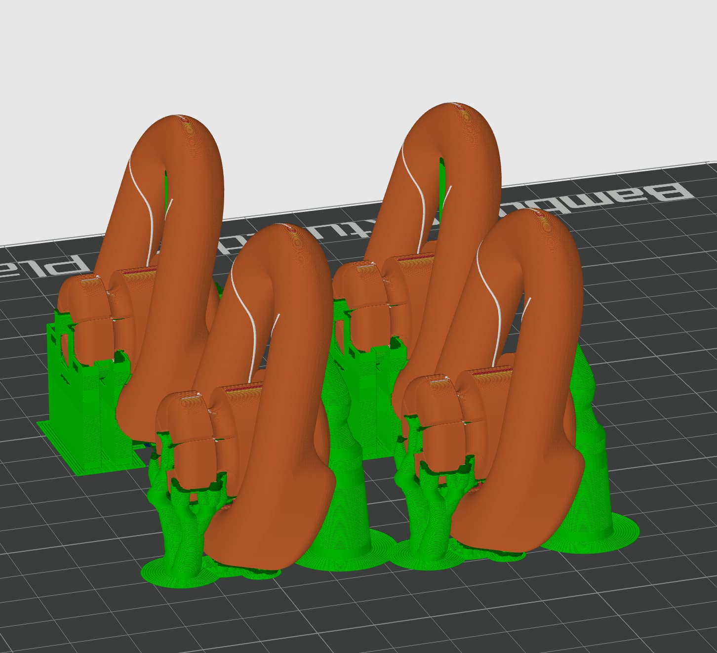

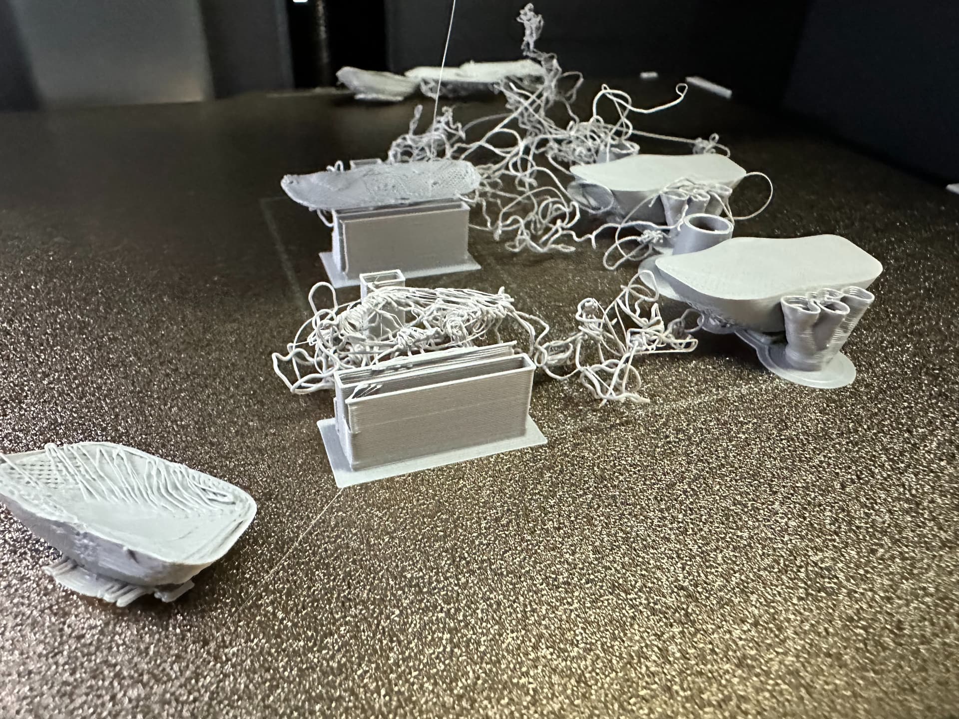

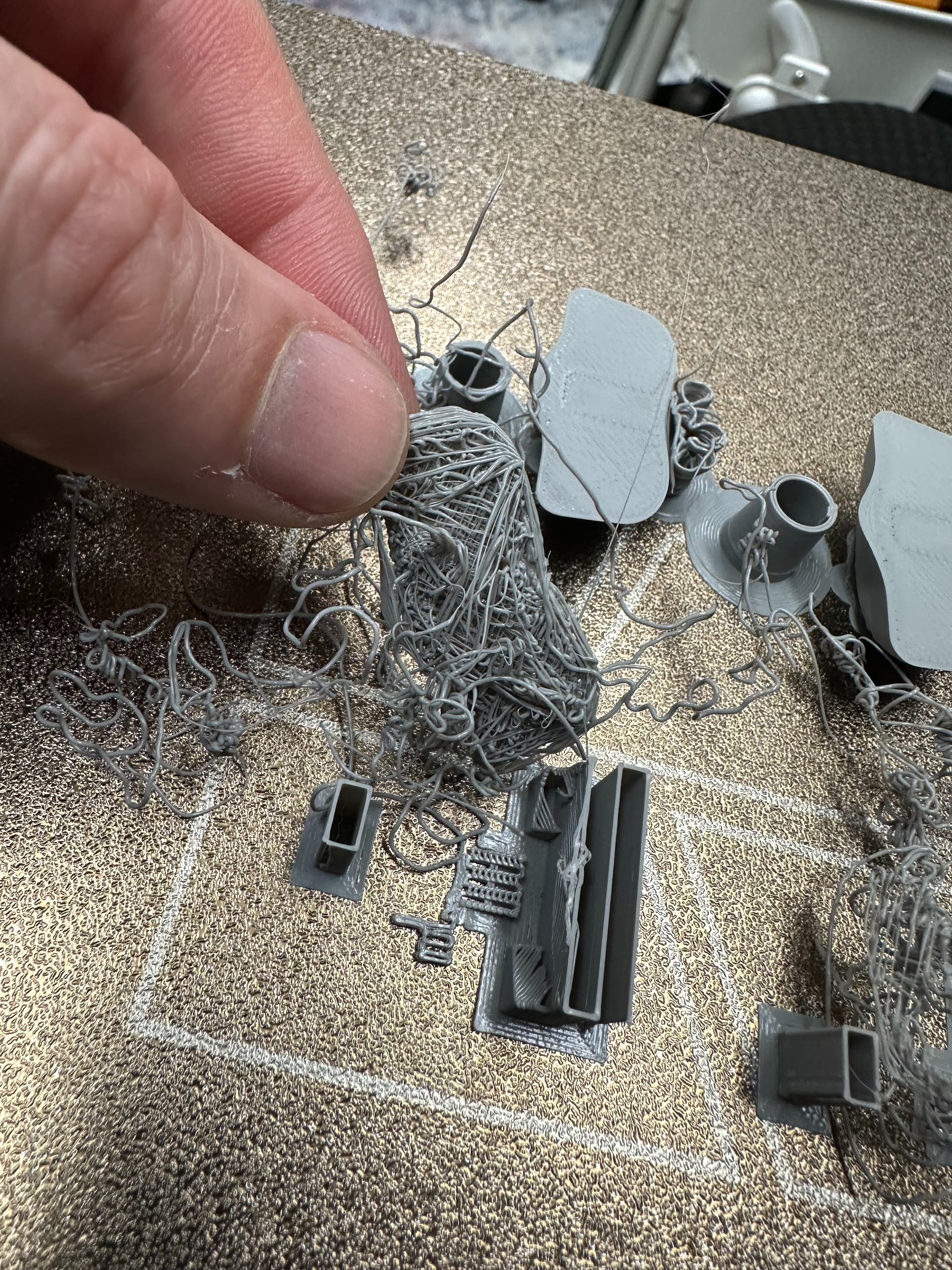

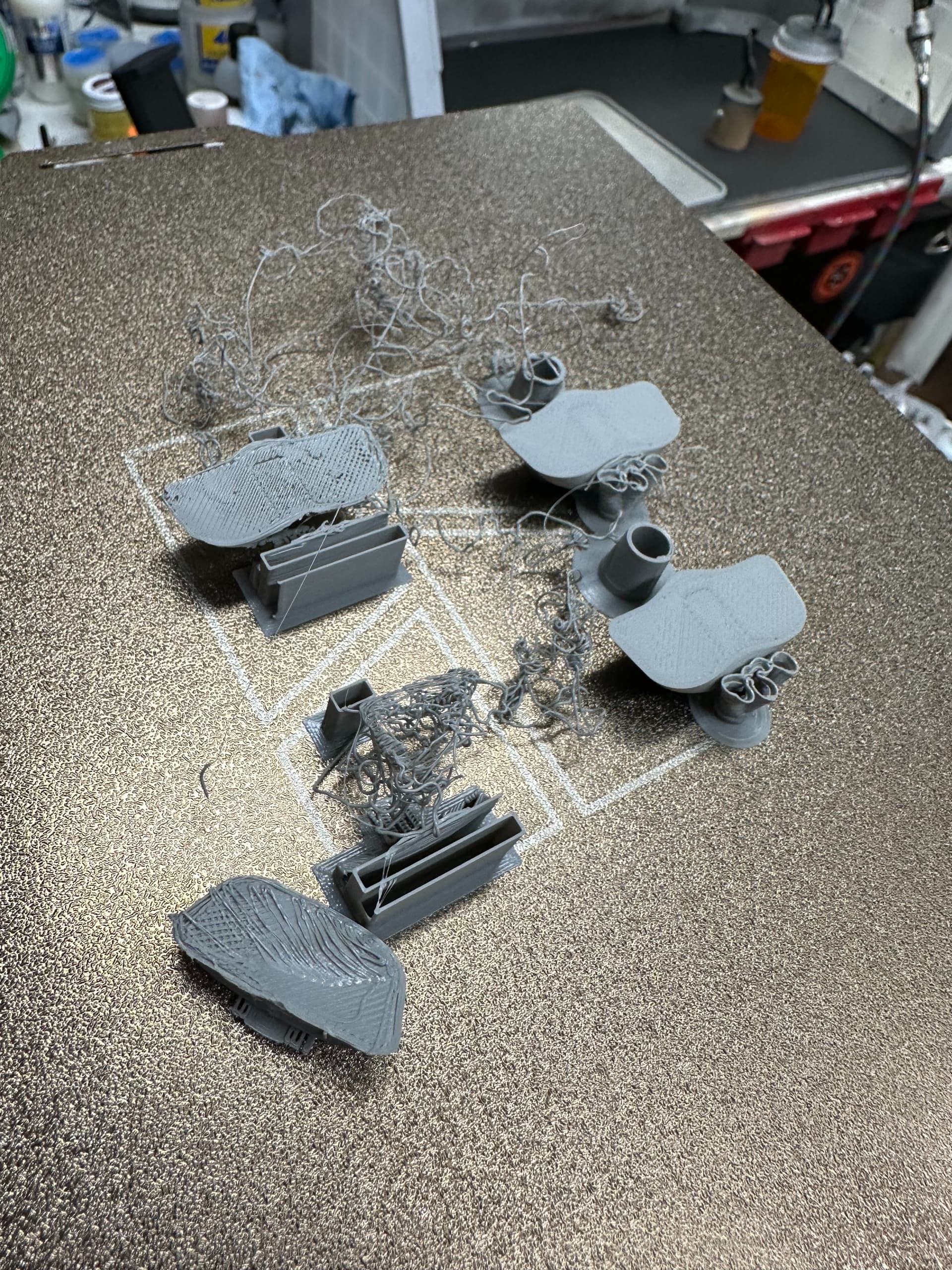

I have setup my new PS1 and printed three test models (the included Benchy, Clock, and vase). All three printed stunningly perfect. I’m trying to print a model of my own and it’s failing in miserable fashion. I’m not even sure where to start to try to solve this. I used the Bambu Studio auto support feature to add supports. I’m using the gray Bambu PLA basic.
Any idea what’s going on? It seems unique to this model since the other models seem to have printed fine.
(I’m brand new to FDM printing but have been doing resin printing for a while now. Let me know if there’s more info to share to help troubleshooting)
Thanks!

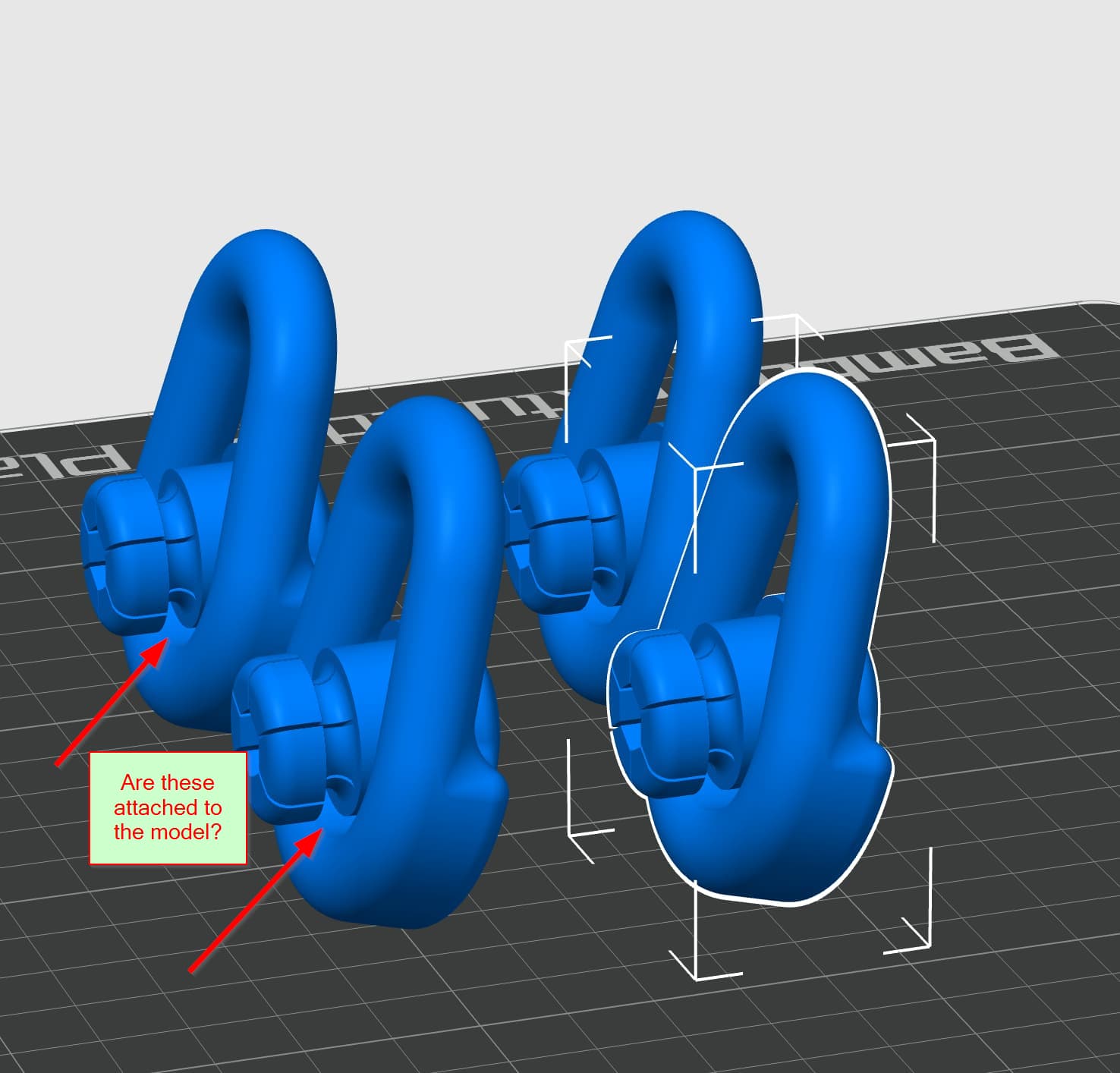

The way you print them, you’re totally relying on the supports to hold them on the plate. The area of the models contacting the plate is very small, actually just one point. I would rotate them 90° and retry (and uncheck prime tower)

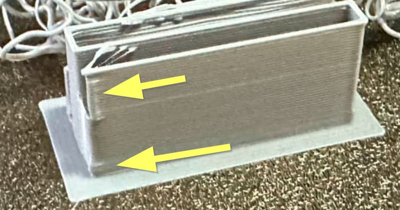

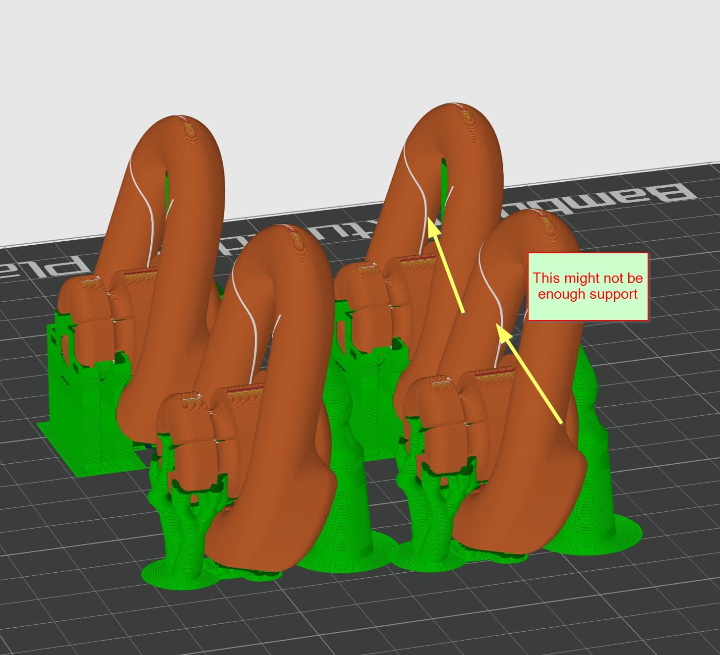

@philch is correct. You’re supports are insufficient to the task. As a result, you’re going to invite layer separation.

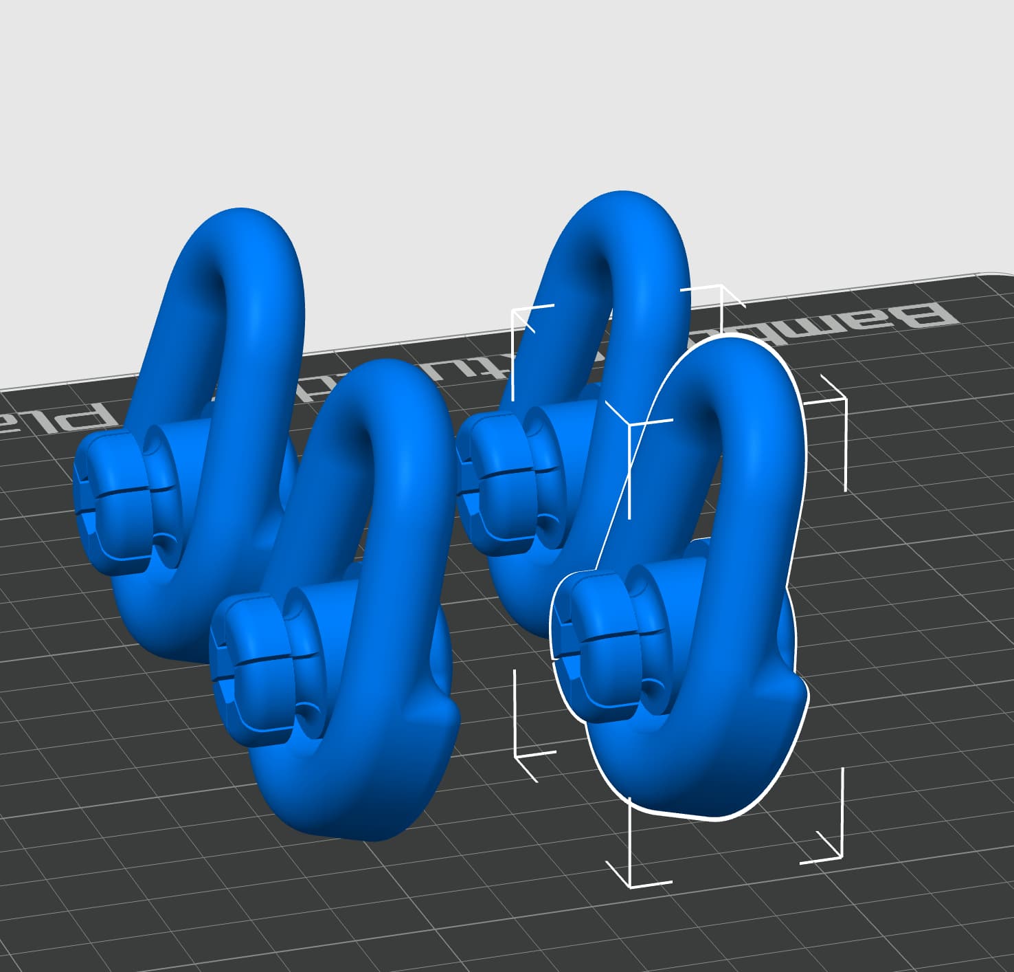

Can you provide another screengrab showing a 30-45 degree offset so that we can see the front of the object indicated by the red arrows. I can’t tell by the model but is that a floating object or is it attached. If it’s attached, it doesn’t look like there is a lot of connective material which would also induce layer separation.

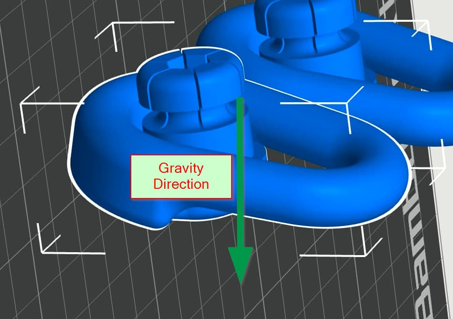

Model orientation
You may want to experiment with orienting your model so that the model lays down in such a way as to minimize height. Then use supports to ensure that you’ve got enough material to hold up the model.
I see that you’re experimenting with both standard and tree supports. This model if laid flat should do well with standard supports. One tip I might add is to increase the support separation from the default of 0.35mm to at least 1.25-1.5mm. This will create a greater gap between the X/Y distance of the supports making them easier to separate. You can use the same parameter for both tree and standard supports.

If it’s Matte Bambu gray PLA, that stuff is pure garbage. In fact, I’ve long abandoned all Bambu Silk and Matte filaments because they simply do not perform well. In the case of silk, they have even been shown to damage plates. Furthermore, the Matte grey filament, which I keep in my “problem child” cabinet for experiments, just doesn’t bond well even when dried and tuned. I’ve found that PolyMaker Matte filaments perform better put I still leave nothing to chance and manually tune the profiles. Also, different colors have shown to perform differently as I found out with Bambu Matte Black, Red and Gray, all are totally horrible filaments for producing parts. I think their use-case is for artistic models, not functional once.
If it’s standard Bambu PLA, have you tuned your filament? You can’t simply trust the defaults. I’ve wasted many a spool proving that theory. :enraged_face:
I’m seeing a lot of things I don’t like in the supports that indicate that the filament hasn’t been either dried properly(yes, even PLA) and/or not tuned properly. The flow looks wrong. Tuning would prove or disprove this theory.
