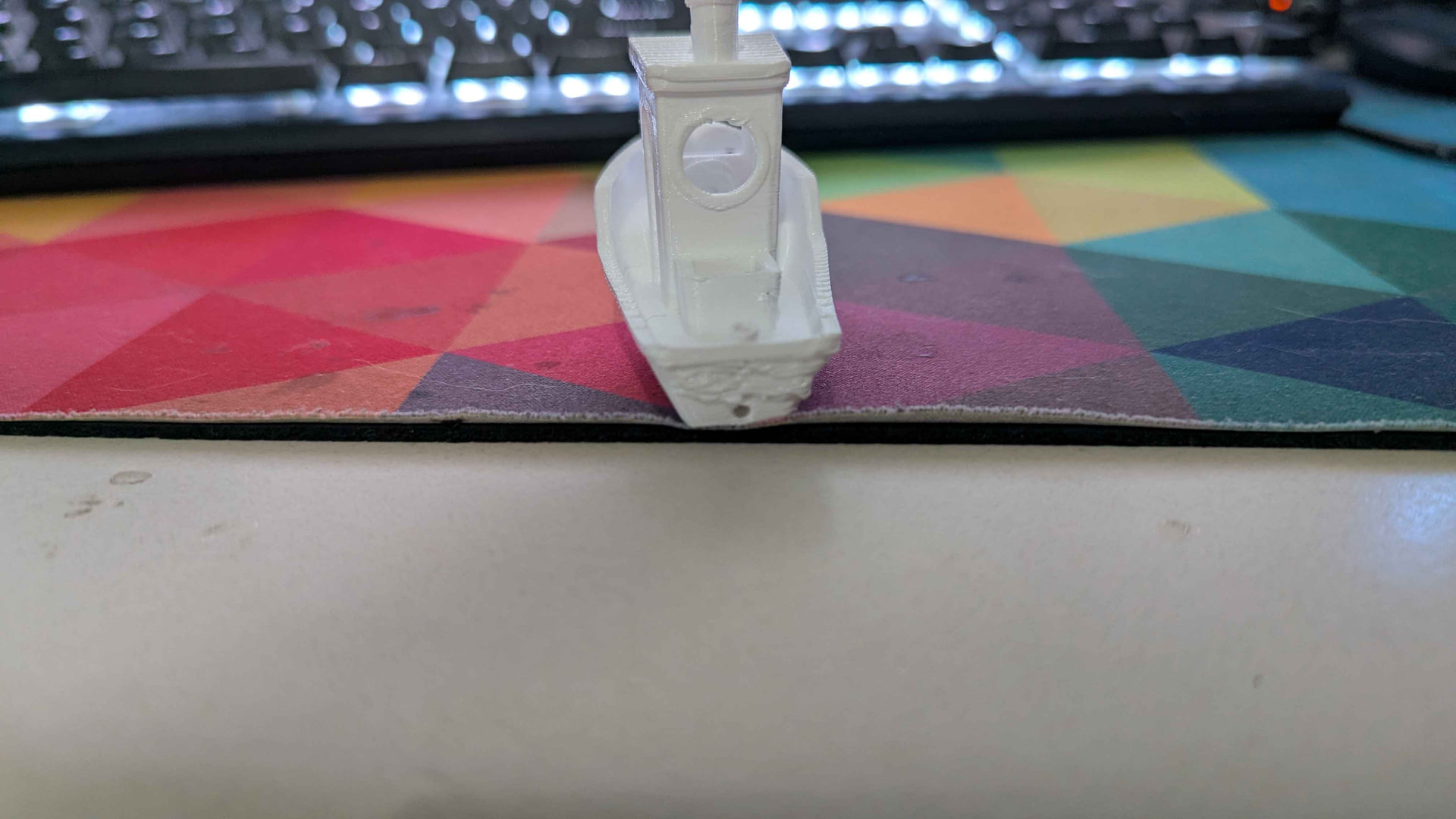

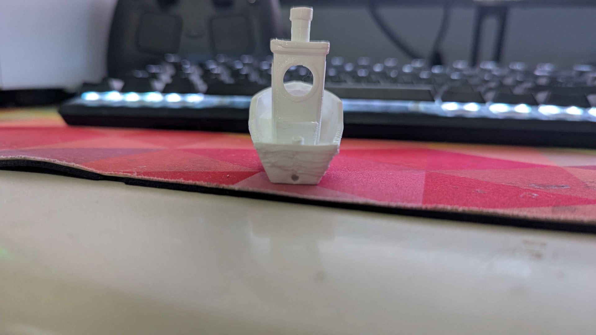

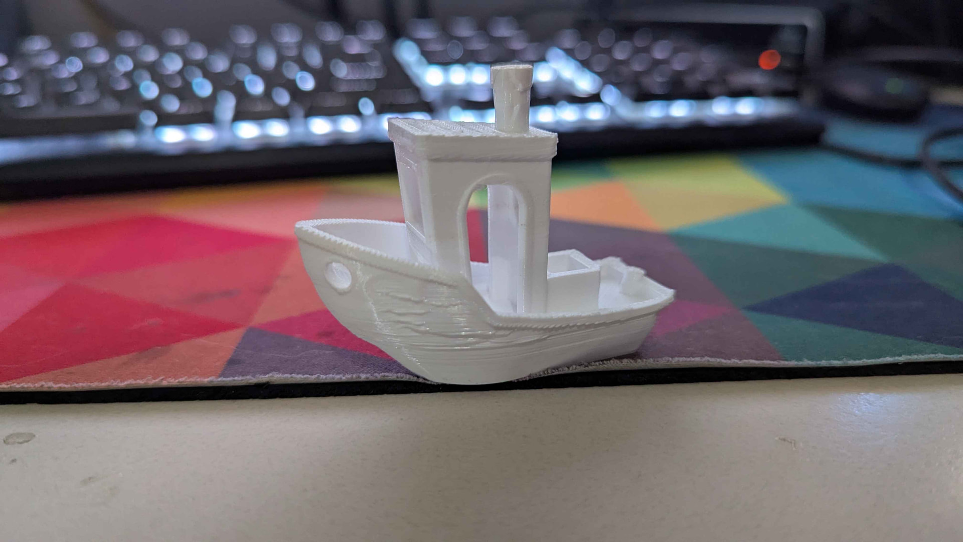

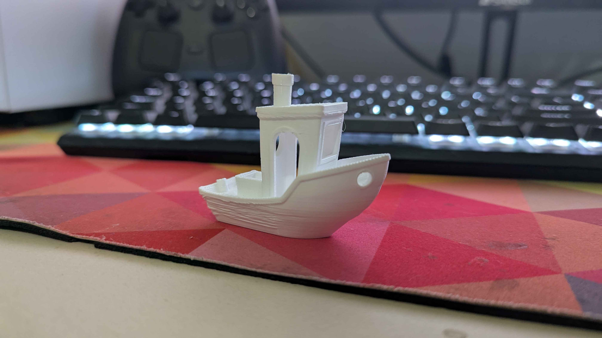

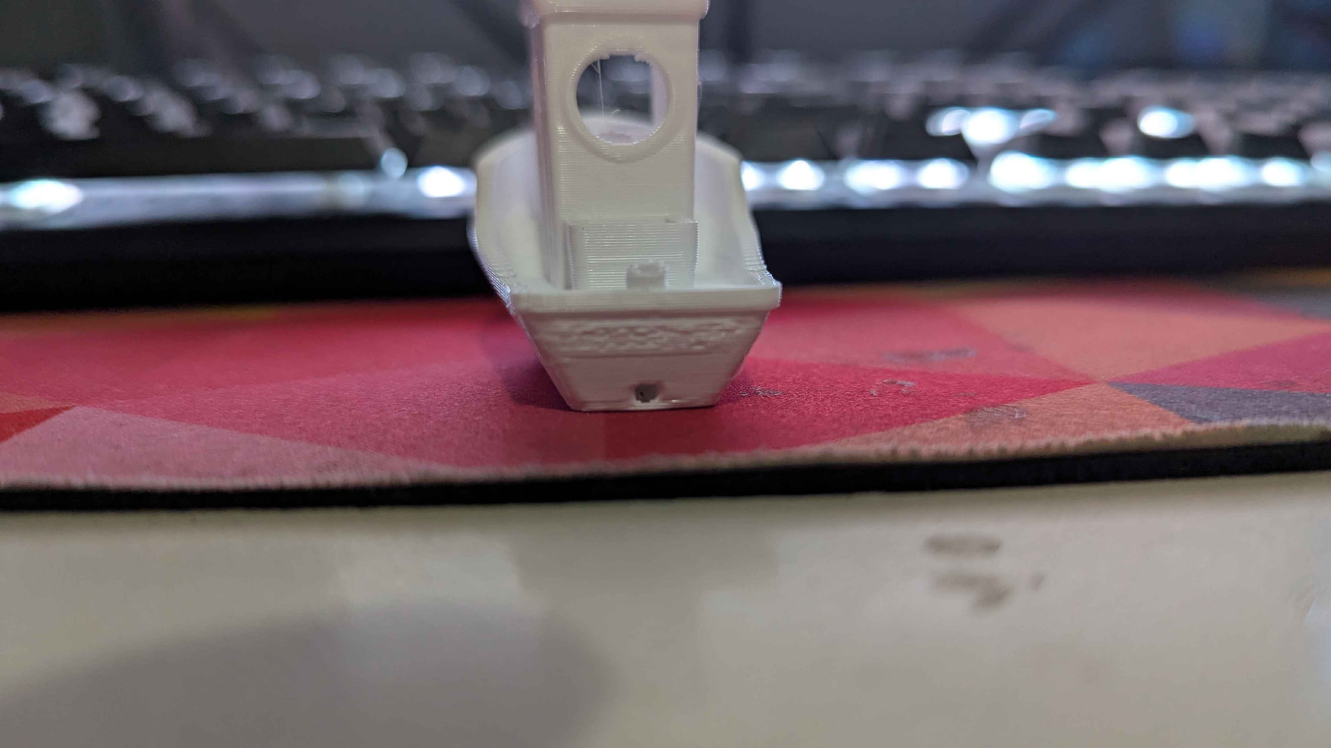

Troubles with printing Benchy
Are you drying your filament? How? (Details) PETG is known to grab water and have that water cause problems.
First of all, the important question:
Did you use the Benchy that’s stored on the printer - which is intended solely as a speed benchmark and not for quality - or a Benchy from, say, MakerWorld, which strikes a balance between quality and print speed?
The choice of Benchy often has an extremely large impact on the print result.

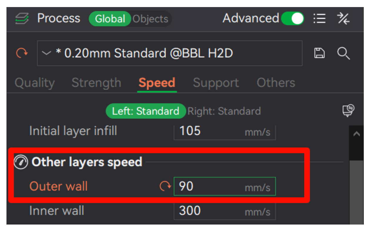

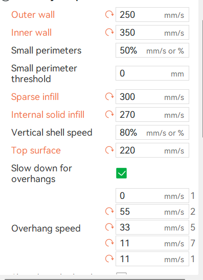

Your values seem to differ significantly from what Bambu recommended. How did you determine these values? Your outer walls: 250 mm/s. Bambu recommend 90 mm/s.
The flaw looks like “surface local under-extrusion,” as described by bambu in the wiki:
…and as MZip already mentioned: PETG almost always needs to be dried.
Yeah, I normally just put it in the dryer and print out of that, but for this specific model I forgot to start it. However, the problem still occurred when I was printing with fully dried filament. I’m using this dryer to dry my filament.
I Used the Benchy from Makerworld. I selected the P1 petg file
I don’t fully remember why I changed the speeds. I think that I thought that it was over-extrusion for some reason… But whenever I go to click the orange refresh thing it sets it to 200 so I just assumed that that was the speed that I should print at. I will go ahead and put the speed at 90 and see what it does. I also found the flow ratio which was lower than what bambu recommended.
I’ll give an update whenever it finishes printing

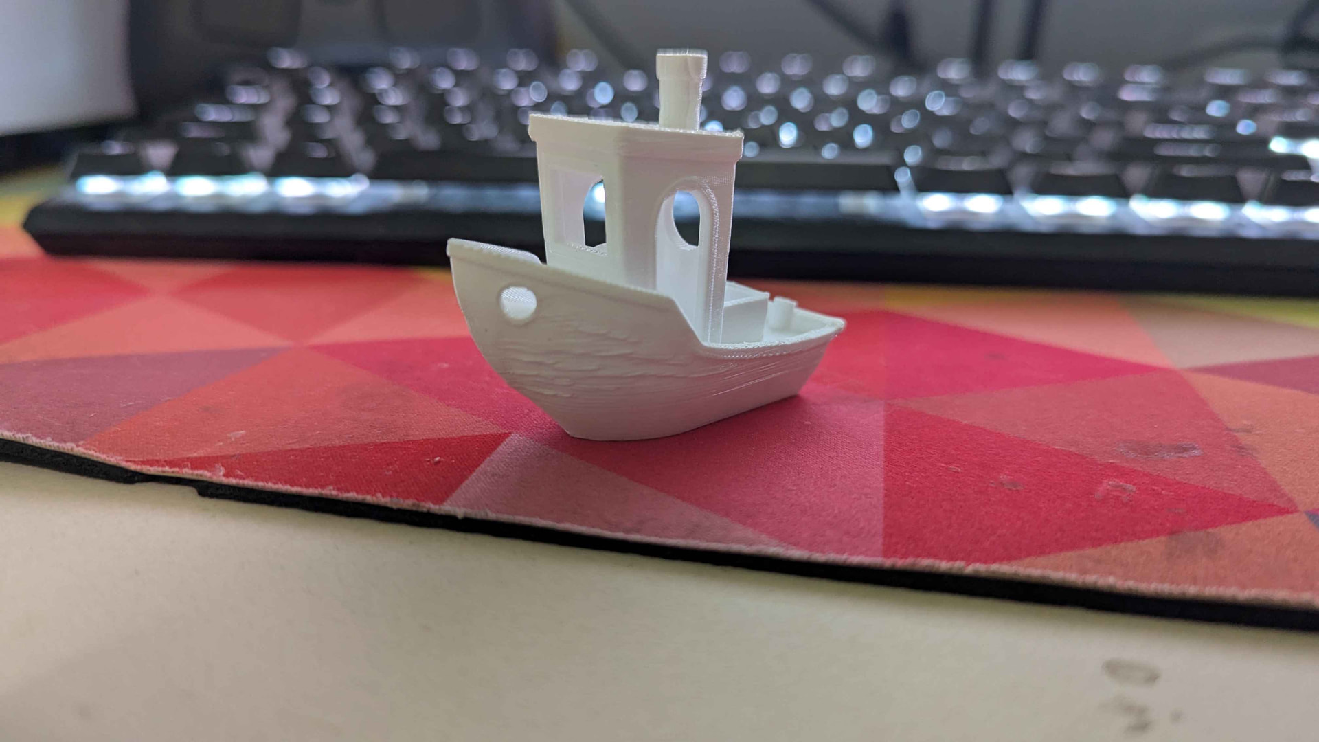

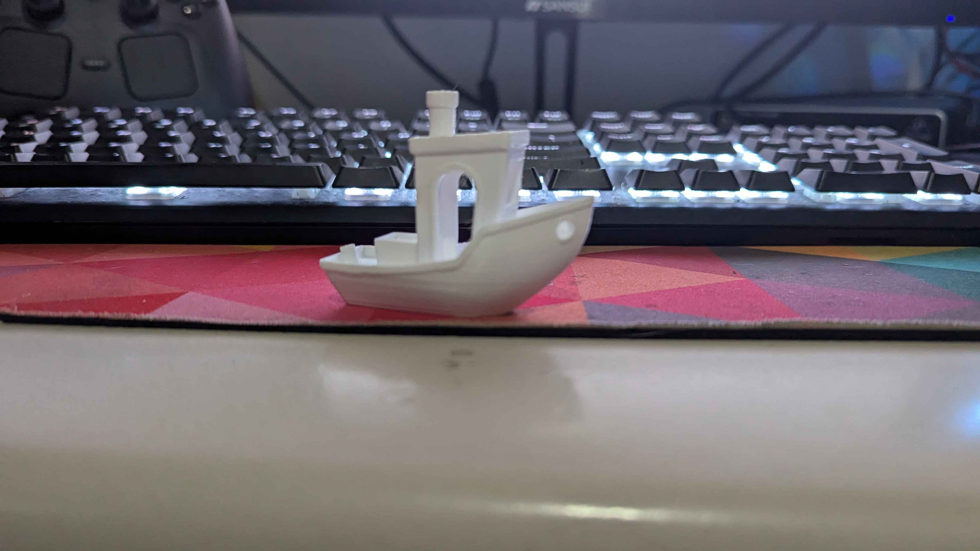

So, I printed another benchy and it turned out the same, maybe a little better, but still not very good. do you have any other suggestions or see any problems with the settings I just changed that I should change again?
What speeds did you change? For PETG Basic (and similar) I usually set all speeds 80mm/s unless they are already below this.
I also use 12mm³/s for max flow while not opening Pandoras Box of cooling. I just change those to match the generic PETG profile.
I usually also disable z-hop and occasionally need to enable “wipe while retracting”.

I changed the other layers speeds. my outer is 90 and inner 300 currently

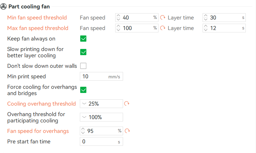

these are my fan speeds

My PETG experience comes from the original release of PETG Basic rather than todays variant. But PETG does reward going slow. I’d recommend going down to 80mm/s for all speeds (except travel) that are higher. I may be a bit conservative, but I prefer a good, slow print to two bad, fast prints.
The fan settings look familiar. But I am on hol’s atm and can’t check. Not sure about the overhang fan settings though.
Also, make sure to change the default sparse infill setting from Grid to Rectilinear. The photos don’t show such defects, but PETG sticks to the nozzle like Romeo to Juliet so try to avoid crossing patterns.

IMO your speeds are way too high for regular PETG. I dont use bambu’s PETG so I dont have a good opinion on your temp or other calibrations (you say min 235 max 260, ok, but whats it set to?) but after slowing down, if its still a little loopy on the roof, drop temps slightly.
I have to assume that you are using BambuLab ‘s PETG basic filament, rather than some other manufacturer.
A lot has been mentioned already, but unless you are running a high speed variant, you aren’t likely to reach those sorts of speeds.
Otherwise, trying to use a Benchy meant for PLA could also be causing issues between print profiles, filament profiles, etc.

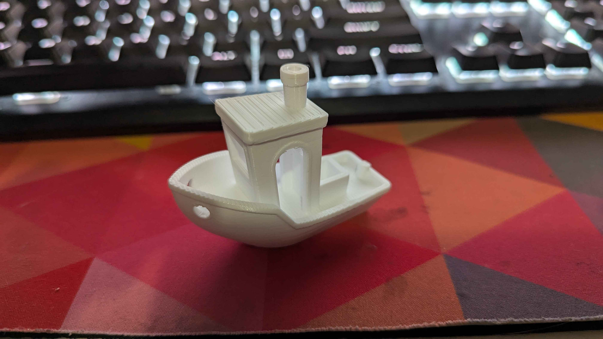

I’d suggest downloading this Benchy, which I’ve been using across numerous different filament types with great results: Benchy Optimised For All Filaments - Free 3D Print Model - MakerWorld
Grab the PETG Basic profile, and try that without changing any other settings.

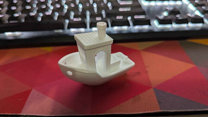

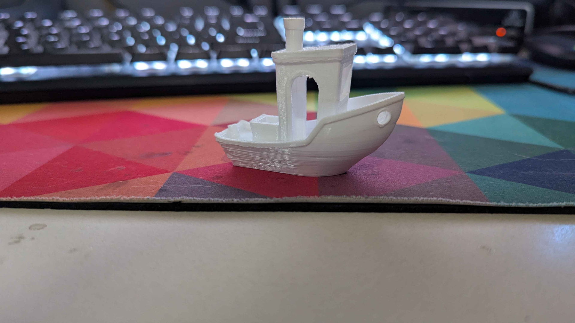

I did that and it worked. I don’t know if it is the file that you sent or if it is the fact that my part cooling fan wasn’t working for some reason. I don’t know when it stopped, but I think that that would have been a large part of the problem. But now it printed pretty good.
it isn’t the absolutely perfect but it is a big enough of improvement that I am fine with it. Now I have to find what to do with all of the benchy that I printed
Huge improvement! Also good to know you were having some issues with the cooling fan.
