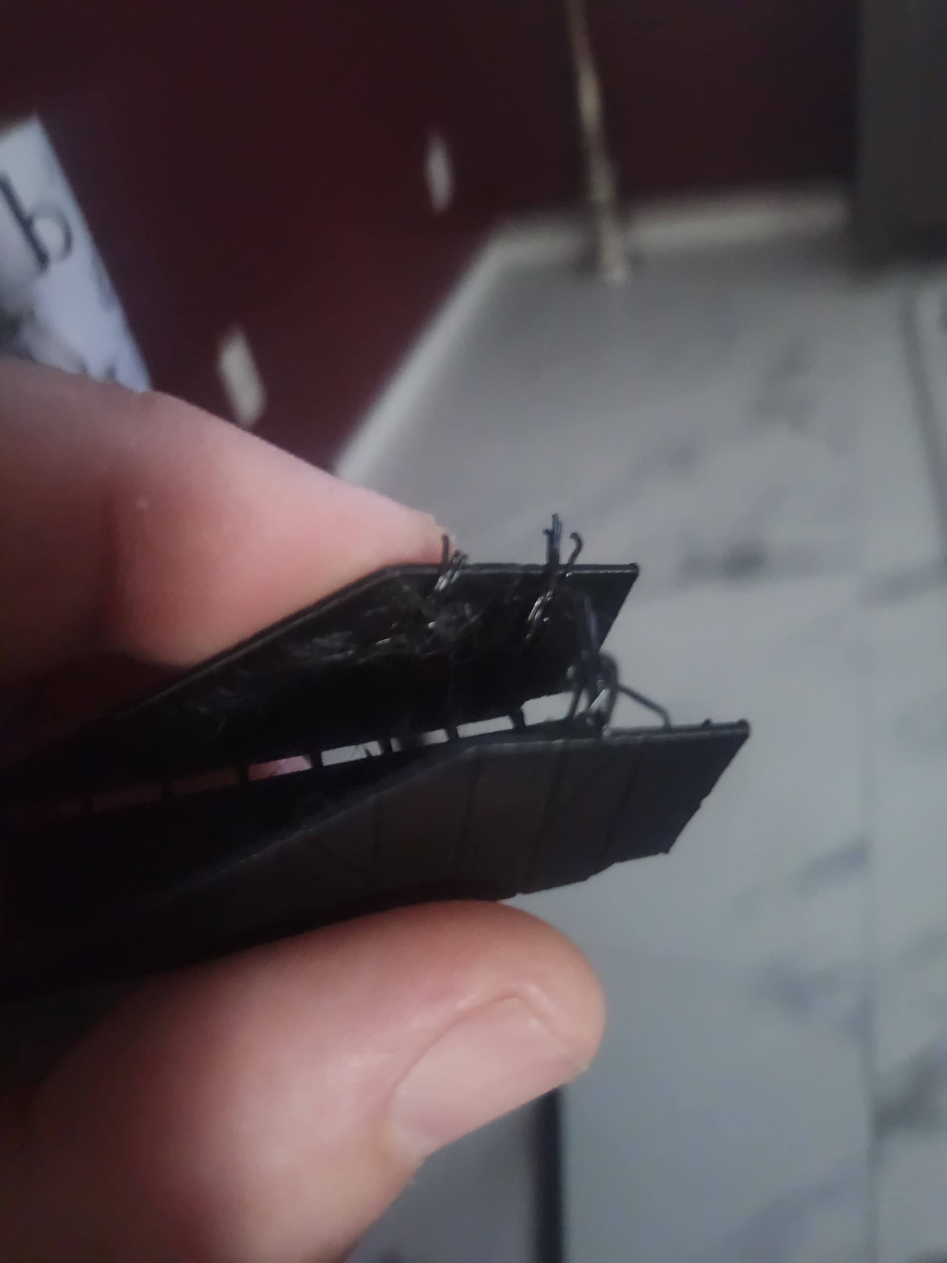

Howdy, we’ve been trouble shooting the problem for 2 days now and have replaced the nozzle, extruder, ceramic heater, fan and just put in a brand new role of Bambu Silk Silver filament all with the same unwavering results. The odd part is I have printed a ton of silver silk previously with no issues. The only thing I haven’t eliminated is the file itself. It’s the silver portion of the fins on the Space X starship.
The rest of the starship printed flawlessly. The print takes 27 minutes and I just need to see if the file creates “worms” on your end as it does here because I’m out of ideas on this end.

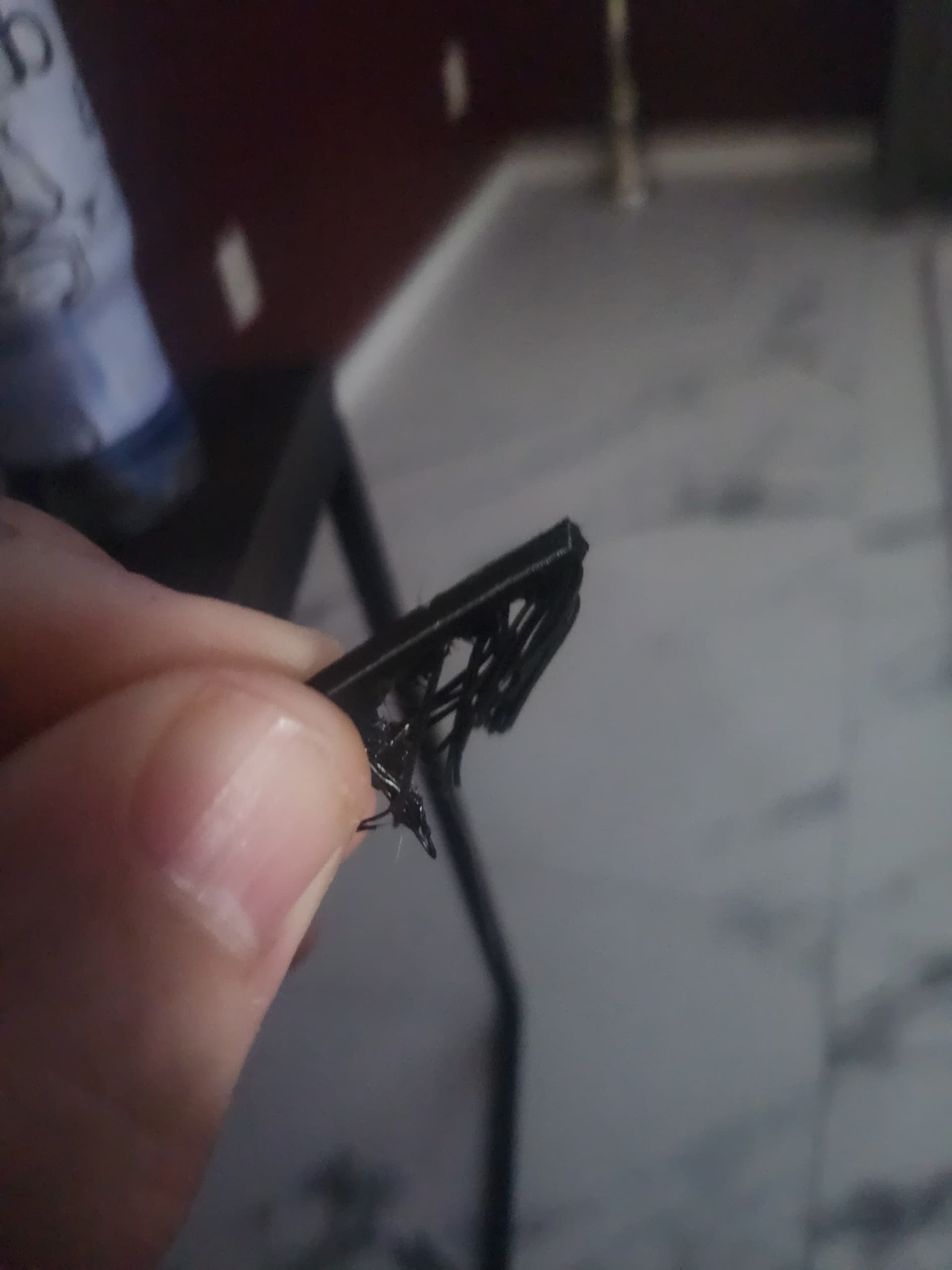

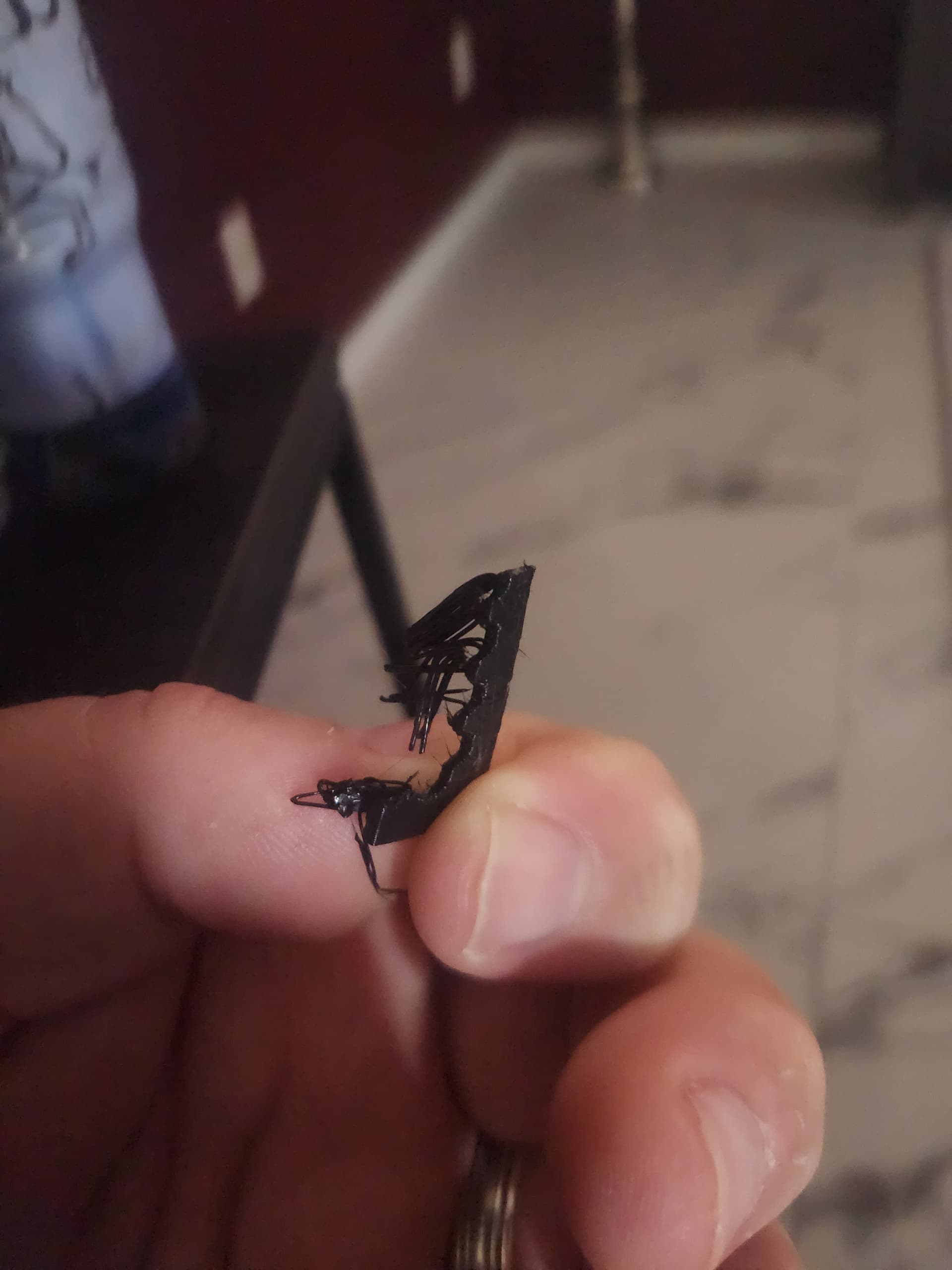

Well now I am really flummoxed. I just printed the parts in black PLA, figured I would airbrush them so I could complete the build and this is how they are coming out in black. Basically, the entire print head is brand new so I am truly at a loss.
Are you able to print the part with another filament?
Figured it out by reading through oodles of forum posts here and over yonder. The file I loaded, for some reason on that one plate had dramatically increased the print speed for the filament.
I lowered everything back down where it belongs and all parts have printed beautifully.
