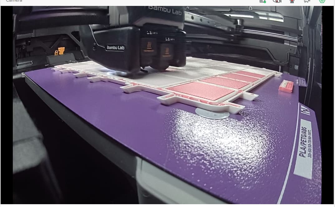

Luckily not during the prints, but afterward I get these long oozes coming out of each nozzle. That means it’s even oozing past the flow guard. Isn’t there a slicer setting to add extra retraction at the end of the print, or must I do it all myself using g-code? Surely everyone is having the same experience, so shouldn’t this be fixed for everyone rather than each of us coming up with our own solutions?
Here’s an example:
You can see that both nozzles have oozed after the print was finished.
Is that PETG?
Also, never seen that purple plate before, what is it?
It’s PETG in one nozzle and PLA in the other. I’m using the PLA for the supports on a PETG print, but it could just as easily be the opposite. It’s a perfect fit for the H2D’s capability.
The purple plate is a kdeavi. It’s similar to a cryogrip, but about half the price. Some people prefer it. I bought it to test, but it turns out I prefer the cryogrip for getting a perfect first layer over the entire build plate. However, for smaller print models, like this one, the kdeavi works just fine for me, and so I save my cryogrip for the truly big prints.

At least on mine it looks as though the flow guard isn’t pressing up enough against the nozzle. So, that would perhaps explain why both nozzles are oozing during the after print instead of only one.
Curiously enough, though, the left nozzle isn’t oozing during the print, even though the picture shows it isn’t completely capped off. That’s probably because I increased the filament retraction to 1mm from the default 0.4mm.
That flow guard is pretty delicate. It doesn’t take much to bend it out of alignment. What’s worse is that if it bends down too far, it can start colliding with the print.
This looks tricky in my opinion.
As you mention, a little lower and it hits the part.
Is this position this way, because it’s bent? Or is it just not nicely positioning anymore during a swap?
I read threads about the nozzle blocker not moving smoothly into place.
Eighter way, lets hope it’s not messing up your job halfway.
That nozzle blocker is bent, bend it back and problem is solved, even a new nozzle blocker need to be fitted to really do it’s intended job.
Yup. For unclear reasons, it kept dipping low and lower, until today it finally did snag and caused an unrecoverable layer shift while printing. No loose screws, so unclear why it happened,.
I followed the wiki youtube which presents its particular way of bending it flow blocker (nozzle blocker?) back into position, and it was easy.
