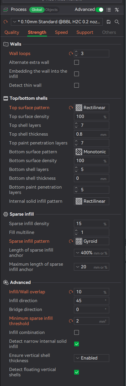

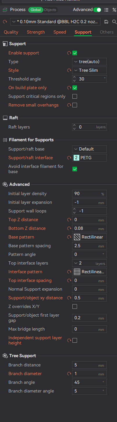

Hello:
This is my first posting looking for guidance on settings to print out ttrpg minis.

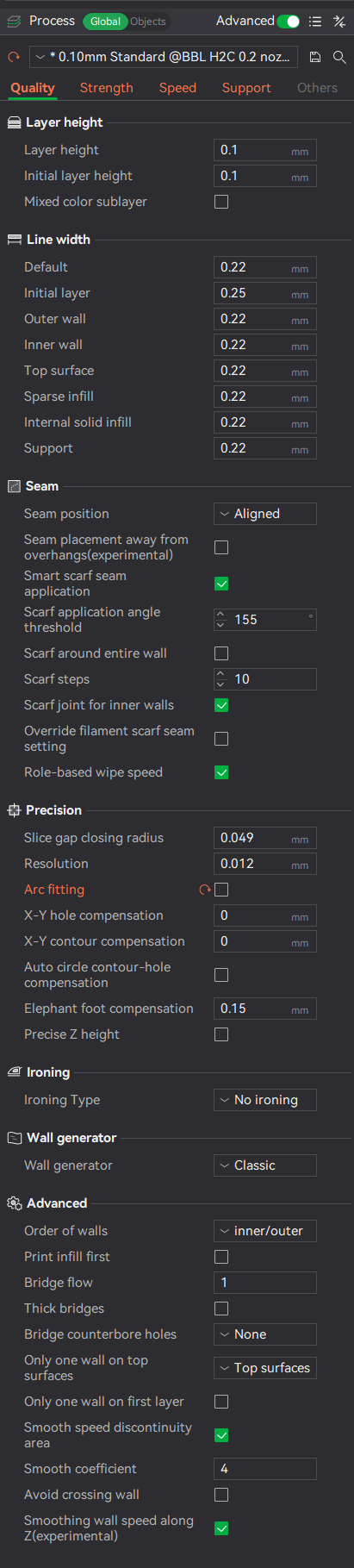

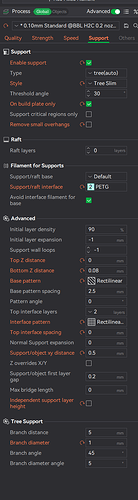

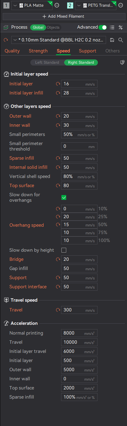

I have using 2x .2mm nozles on my h2c.
I have bambu mat pla and bambu petg for interface supports.
I have tried to use a combination of settings from these 2 videos (primarily the first)
https://www.youtube.com/watch?v=G1EAzfAMzmk&t=1028s
https://www.youtube.com/watch?v=gzFu-NMo9uo&t=560s
However when i get to about 45% I get spaghetti everywhere.
I am going to try and attach the .3mf file.
Does anyone see settings I need to change since this is an H2C (and not a Bambu mini A1)?
Are there any settings you can see that may be contributing to why this fails?

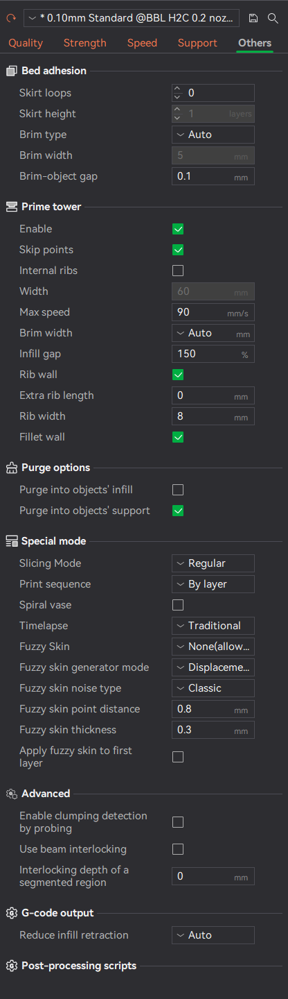

I enjoy printing miniatures as well, so I’m happy to share my own experience. Just to be clear: this is only my personal perspective - everyone will have their own approach, and there are plenty of ways to reach the result you want.
Generally speaking, I wouldn’t use a textured build plate. It’s a bit of a jack‑of‑all‑trades — it can do many things, but none of them particularly well. With miniatures, I’ve had far more failures and odd issues on textured plates than on smooth ones.
I also wouldn’t print a figure at a 45° angle. Either keep it upright at 0°, or lay it flat on its back at 180°. Printing at 0° tends to give you the most reliable, trouble‑free results, while the 180° back‑side orientation keeps any visible marks on the rear of the model, where they’re easier to hide.

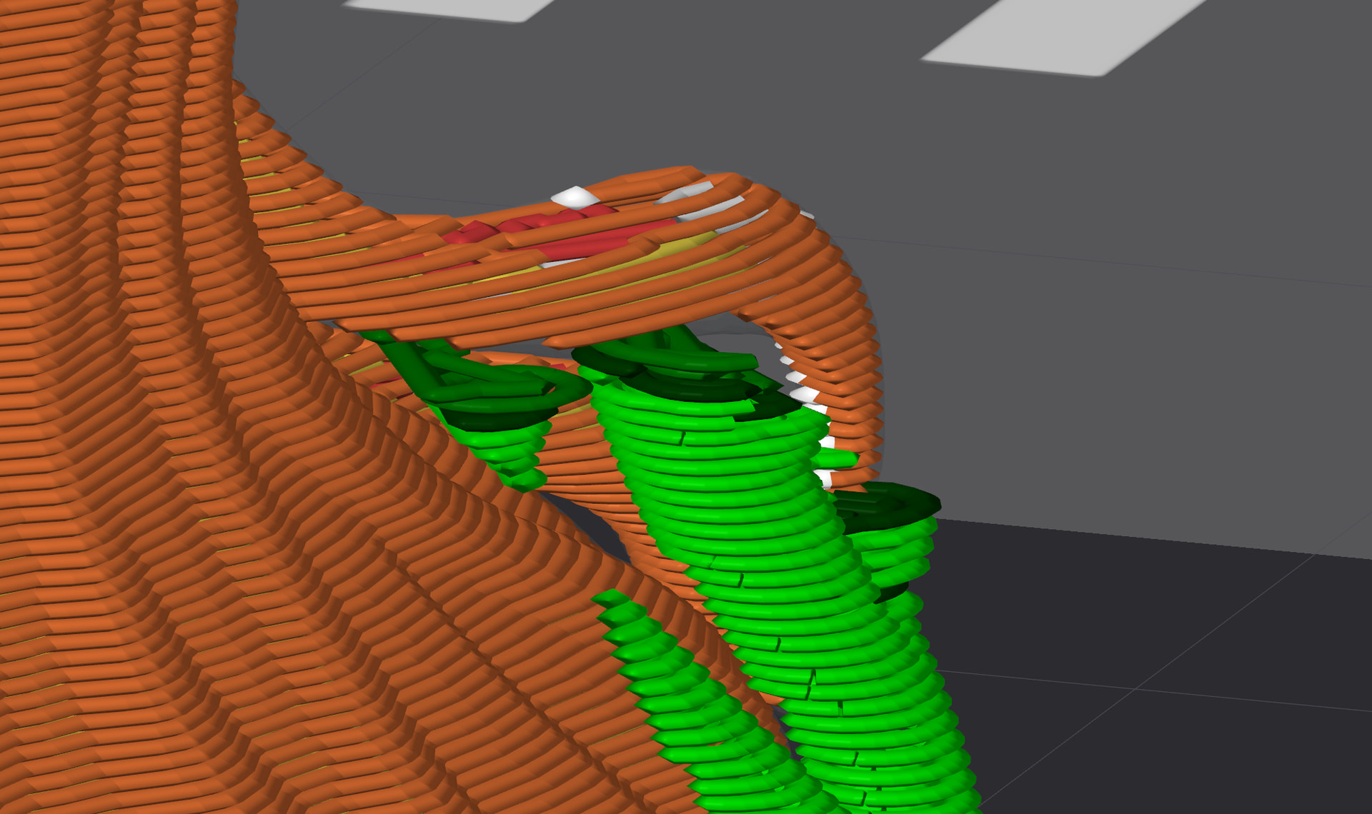

Your support is partially floating in the air and is not connected to the object: Not just in one place, but in many - that’s probably the cause of the print failure.

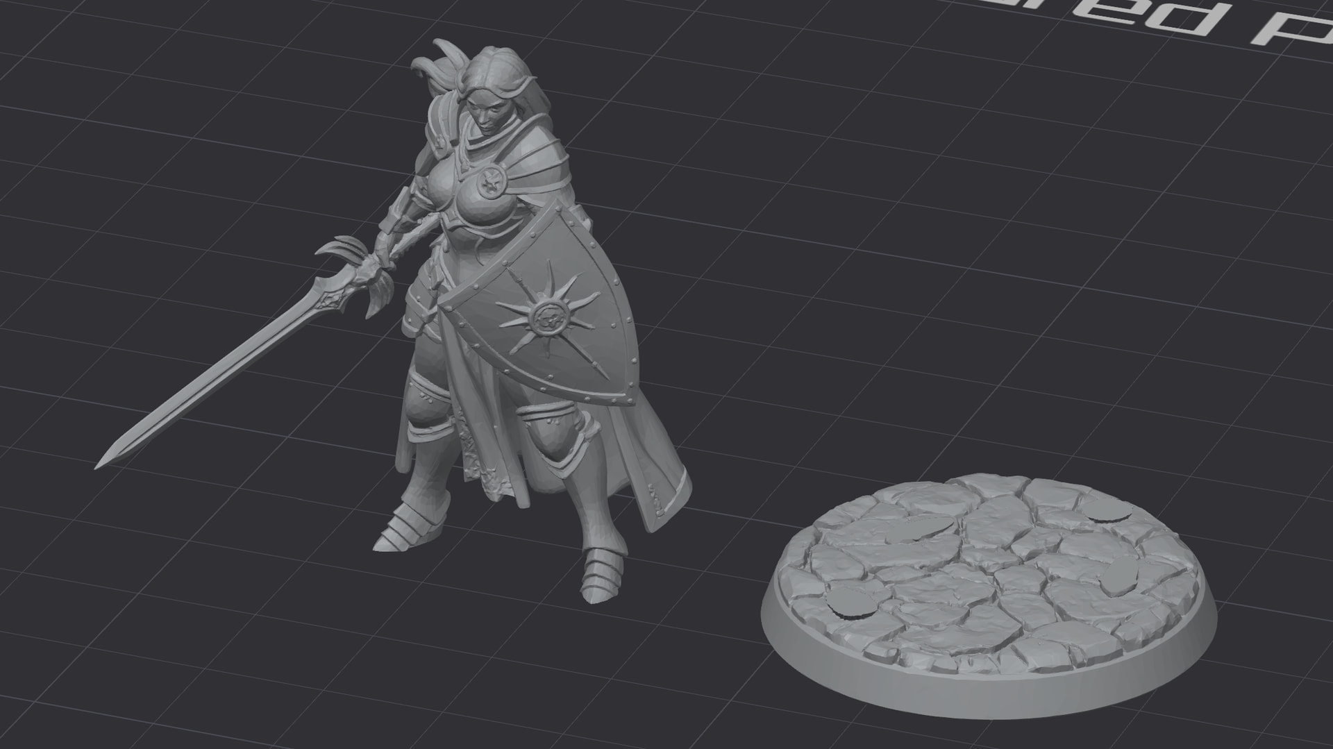

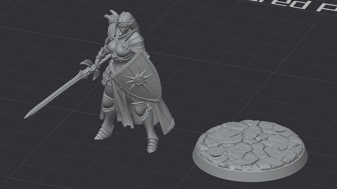

By the way, if it isn’t one of those “support-free miniatures”, I’d personally print it with the base and the figure separated. It saves a lot of time and avoids a whole bunch of headaches. You could even add a few simple joints - this was just a quick mock‑up. Glue the parts together afterward and it’ll hold perfectly. Honestly, I’d be more concerned about the sword snapping off than anything else.
Here’s the file, but keep in mind that nothing has been configured or optimized yet - it’s just for illustrative purposes:
Female_Paladin+Base.3mf (2.5 MB)

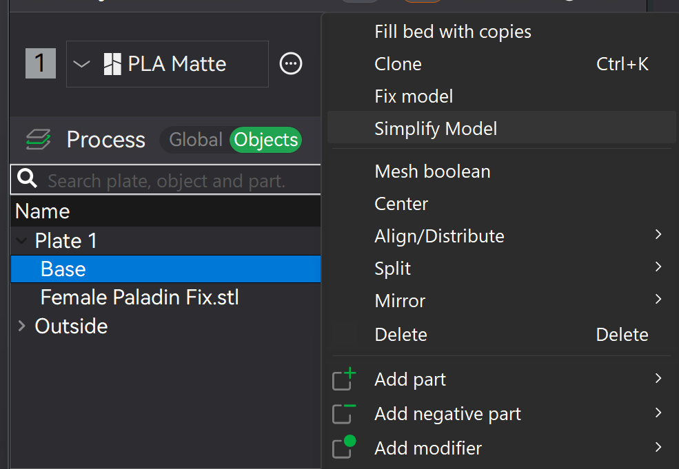

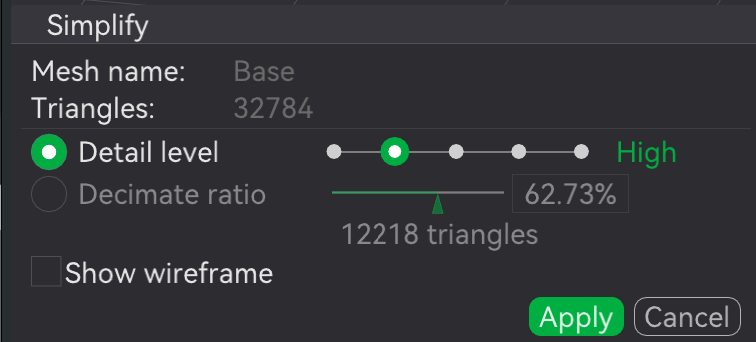

By the way, the reason was that the file hadn’t been optimized for 3D printing and was probably a game rip or a large model that had been scaled down. Take a look: After optimization, the file is only 2.5 MB.
This can also be a factor that confuses the slicer if there is a lot of unnecessary information in the 3D model.
To fix this: Simplify Model: Detail Level: High :grin: :+1:

Wow and thank you for your contribution and insight!. This is awesome and “A lot to unpack” for a newbie.. but I am thankful for your insight. Maybe a good quesiton for me to start with is Why are the supports partially floating in the air and is not connected to the object:
Did I mangle a setting somewhere?
Going back and rereading all you shared for processing purposes :slight_smile:

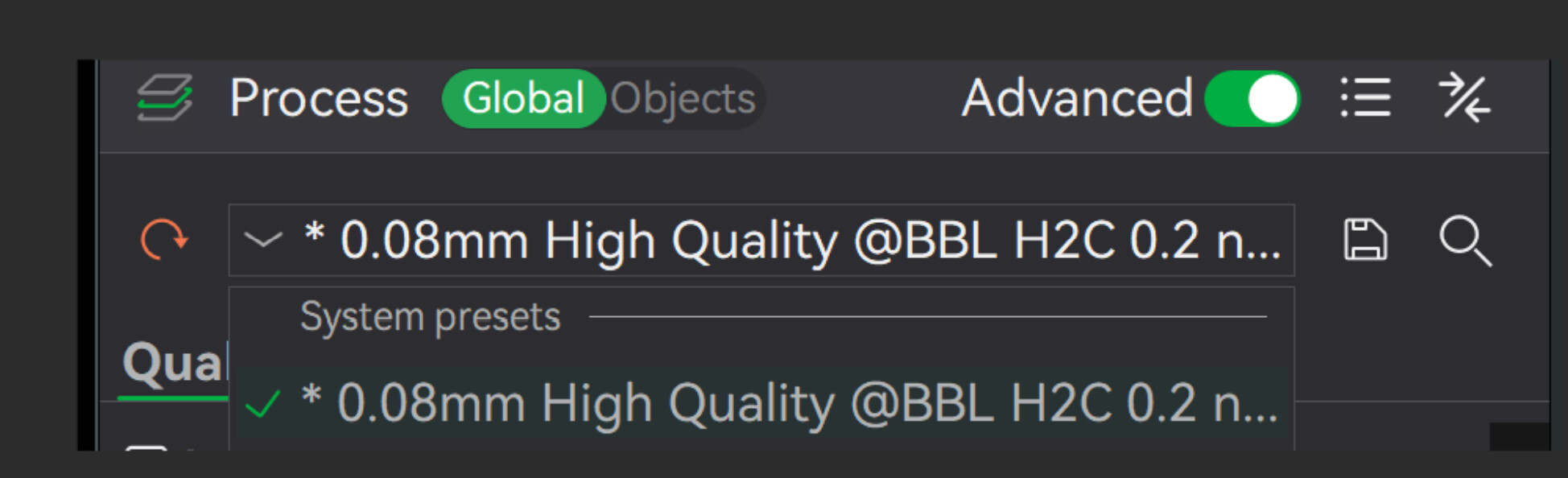

To be completely honest: I have no idea. I can’t really say, because so much has changed. That’s way too much to be able to judge.
I rarely make it that complicated for myself: I just use Bambu’s “High Quality” profile and tweak the support settings a little. Too many settings can often lead to errors and print fails.
