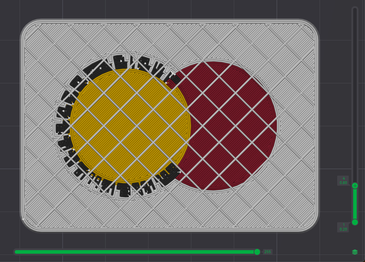

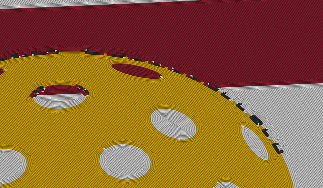

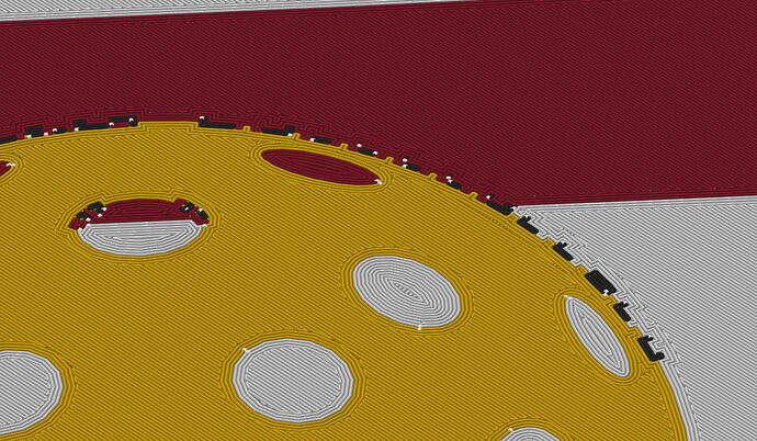

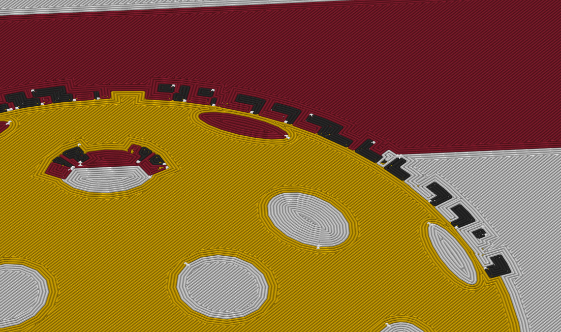

So Bambu Studio seems to be adding ‘artifacts’ when slicing a model from AutoDesk Fusion. My model contains multiple bodies that are imported as a single multi part, multi color, project. Layer 1 slices as expected but layer 2 adds some unintended and unwanted, artifacts at the border of 2 colours in a 3rd color not intended to for that location. In Layer 3 the artifacts are larger. Layer 4 is a pure solid layer of the base color of the main body (White). I am trying to understand what is causing this and more importantly, how to prevent it or at the very least, override it.

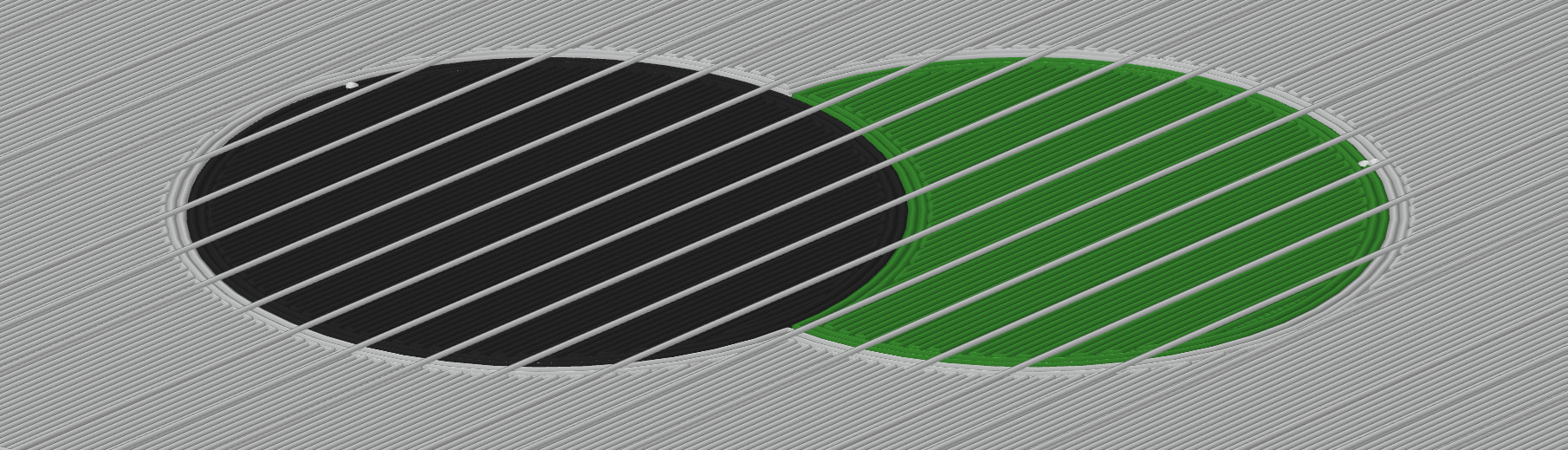

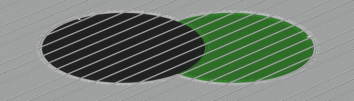

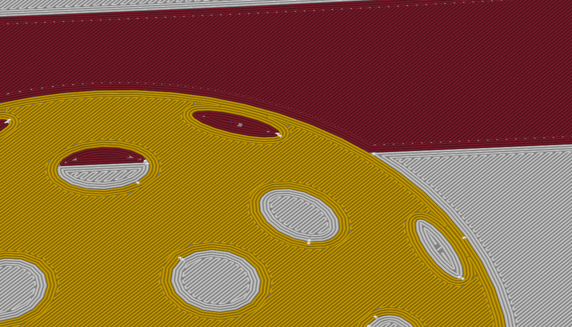

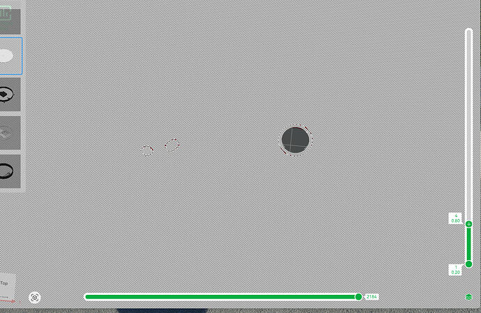

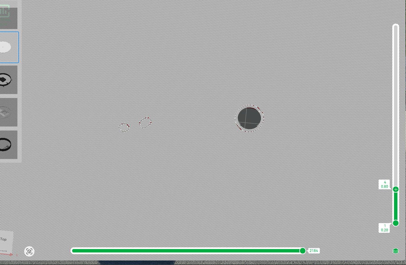

I can Jon. Check my Reddy Kilowatt clock. On layer 4 of the clock face there are two odd little ovals that appear in the slice when it should be a solid and uniform layer. Like I said, I’ve seen this effect on a number of models. That slice image below is with Studio 2.8.2.60.
Looking at it now I guess what I see hasn’t had walls added. It’s just islands of solid infill.
The model is online at Reddy Kilowatt Lighted Antique Pam Clock Replica - Free 3D Print Model - MakerWorld
Added - @JonRaymond, something else. I imported just that stl file alone and sliced it and no issues with islands. It sliced clean. It seems at least in this case to be provoked by the layer underneath it maybe?
The design below that diffuser is 0.6mm thick (3 layers of 0.2mm each) but when I extrude those kinds of designs in Fusion I do the extrude distance as a numeric input of 0.6mm. The stls below the diffuser should all be the exact same height. What the diffuser sits on top of should be entirely coplanar.

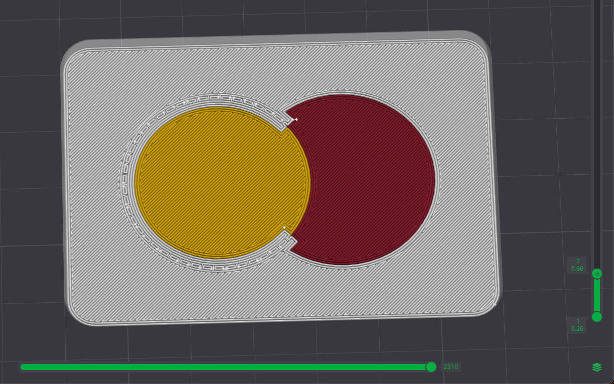

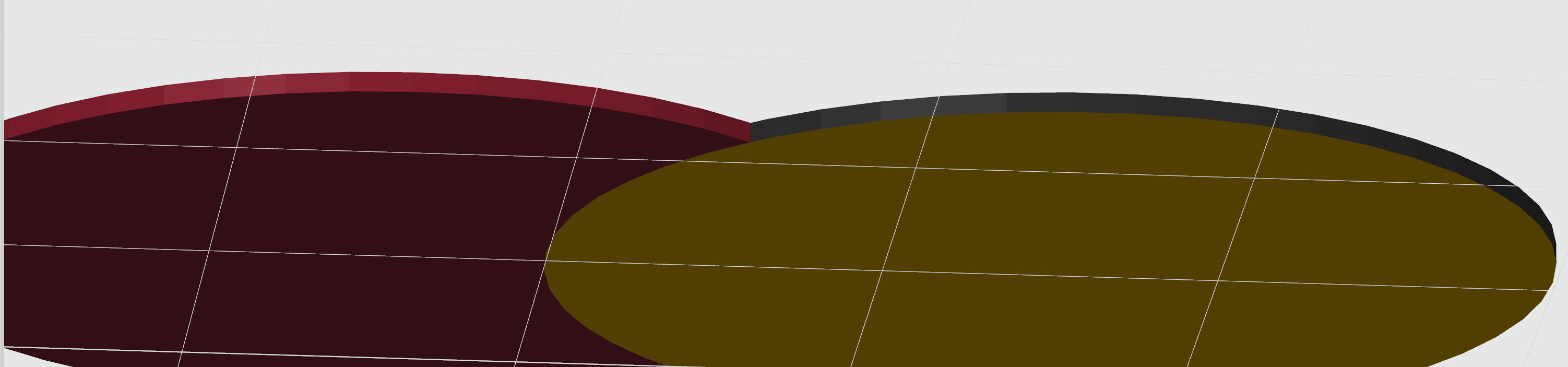

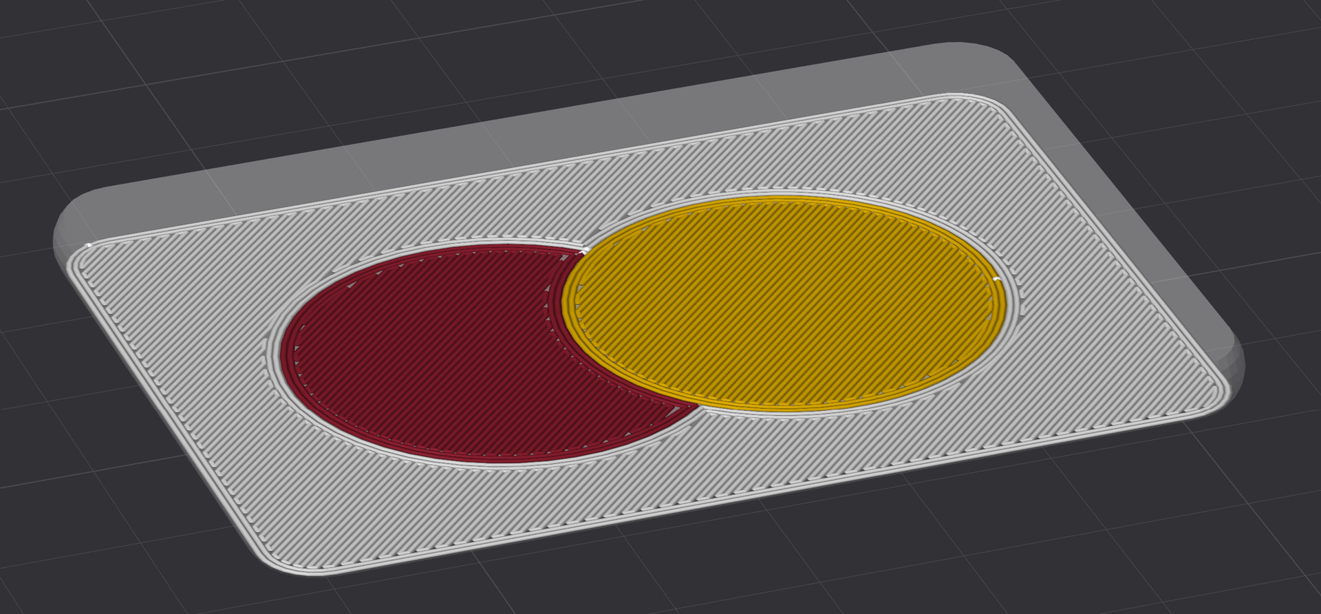

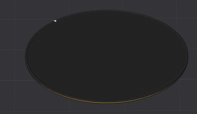

I created a small test model to replicated the issue and it exhibits the same behaviour but oddly more between an inlay and the base part where the original is between the inlays. And in the test case, I have 3 bodies and it adds a fourth color (the black) when creating the project from Fusion.
I am really having a hard time understanding why Bambu does not just slice each body in the color specified. Attached is the Bambu Studio project file for the test piece.
Sign Test.3mf (41.8 KB)

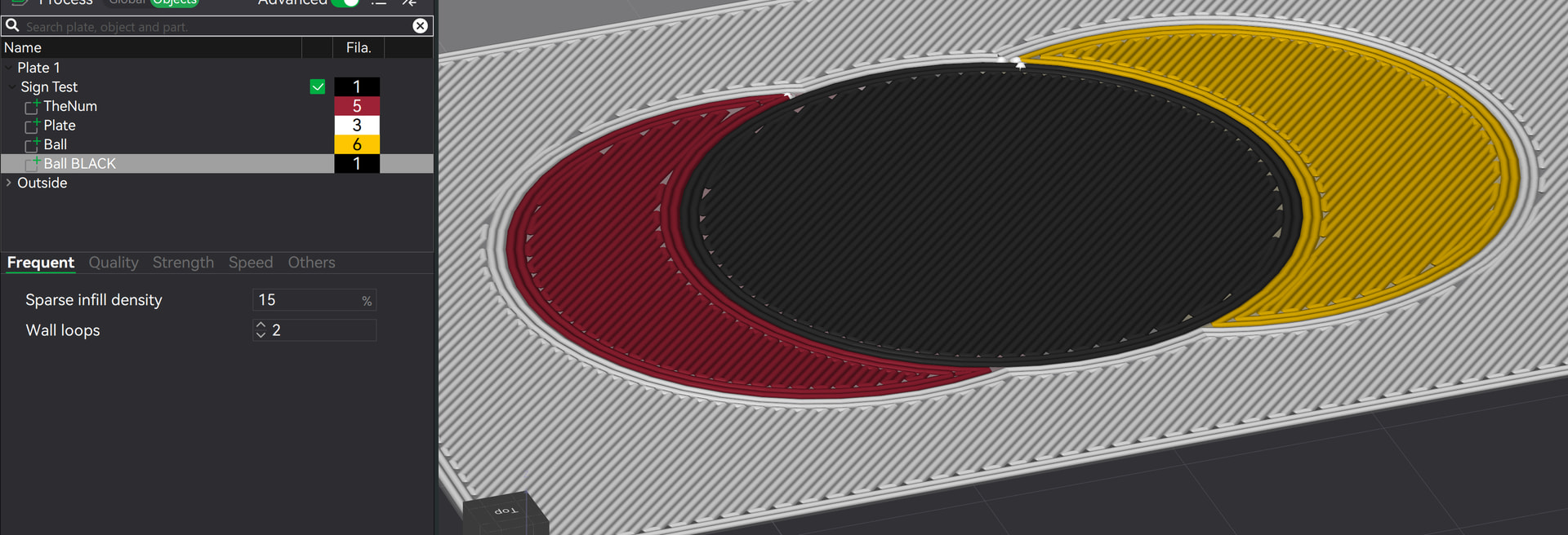

Because you painted the circle two colors: yellow on the bottom and black on the top (the side that isn’t visible), which doesn’t really make sense. You probably only colored one side - that was the mistake?
Change its color to whatever you want - not just one side = problem solved. :+1:
Re: Sign Test 3mf

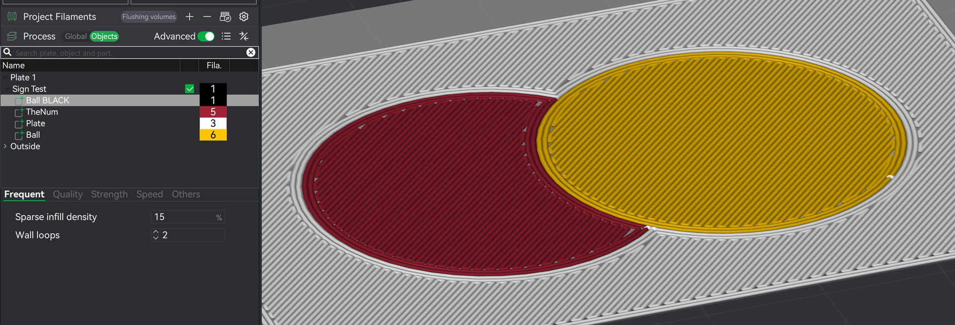

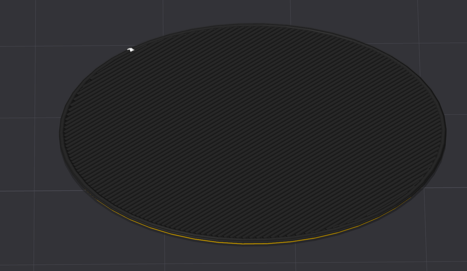

How it loaded for me, note the Object tab on left. Objects are assigned default colors that are not what is painted on them

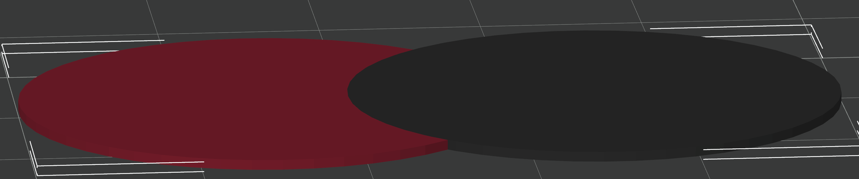

Just to get a visual of whats going on in your CAD program, I deleted the outer part. [“plate”]

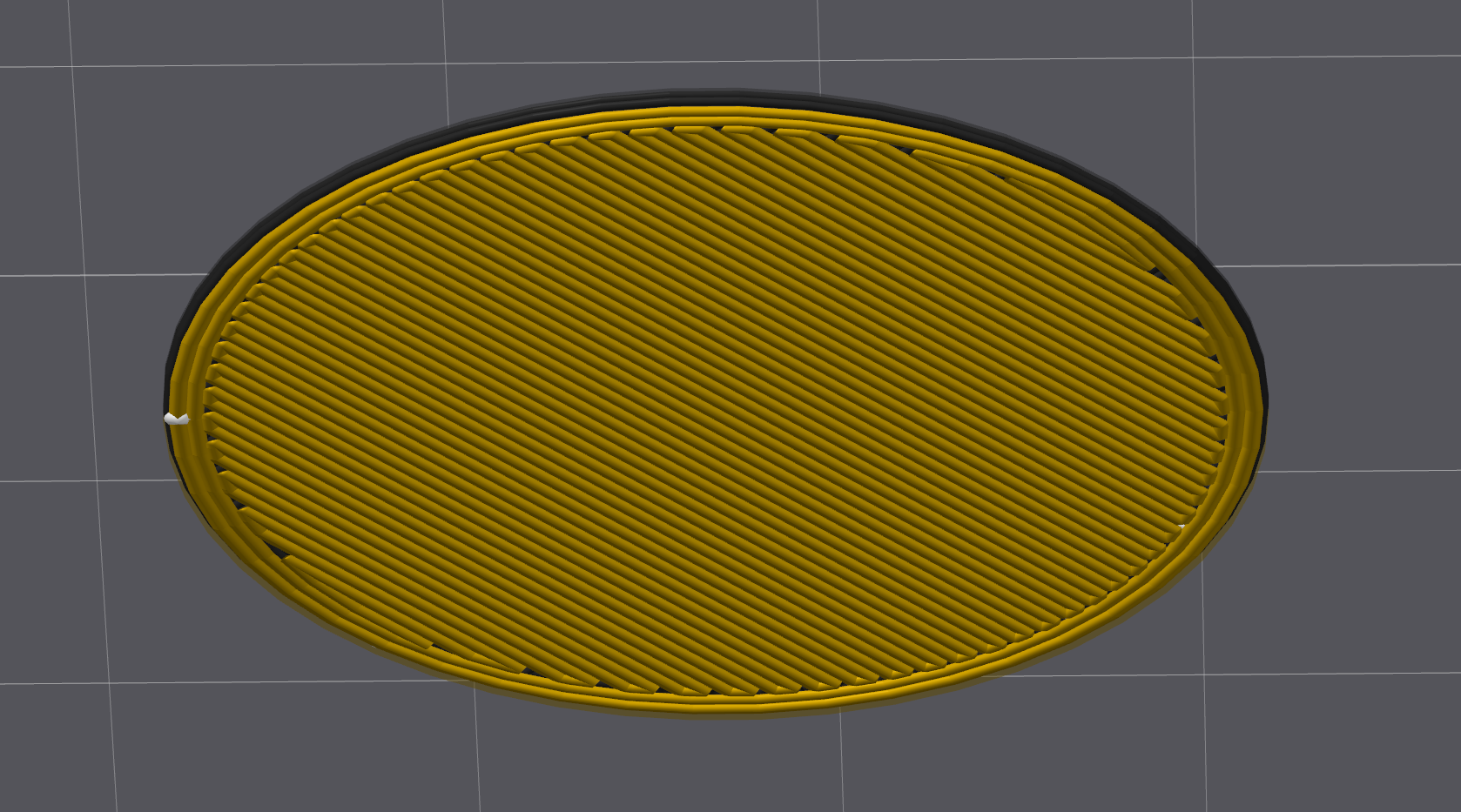

The yellow circle is black on top
I repainted it all yellow, and even then, the slice is still a little freaky
OK, that was a mistake in Fusion, I usually use Appearance to color entire bodies. Let me look at the model…
Also keep in order in mind - referred to here as “Ball BLACK” - as this leads to completely different results!

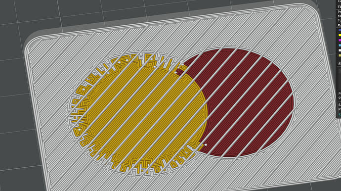

Yes, after switching to a grey I was able to get the weird blending in the same color as the inlay, which is somewhat better but still weird. The ‘blending’ appears now in whatever color I make the body.
And yes, my original model had the yellow only on the surface of the inlay and not the whole body. Good catch, I had not noticed that.
Hmmm… interesting. I did not even think about the order the bodies are listed in.
The feathering or whatever you wanna call it is a function of whatever applied the “paint” here. You say Fusion. If you destroy/reset all paint, it slices smooth. [although of the colors described in the object pane, not in the paint]
I think what you are experiencing is a result of Bambu wanting to ‘strengthen’ the layer based on features from previous layers. That can be somewhat frustrating as well.

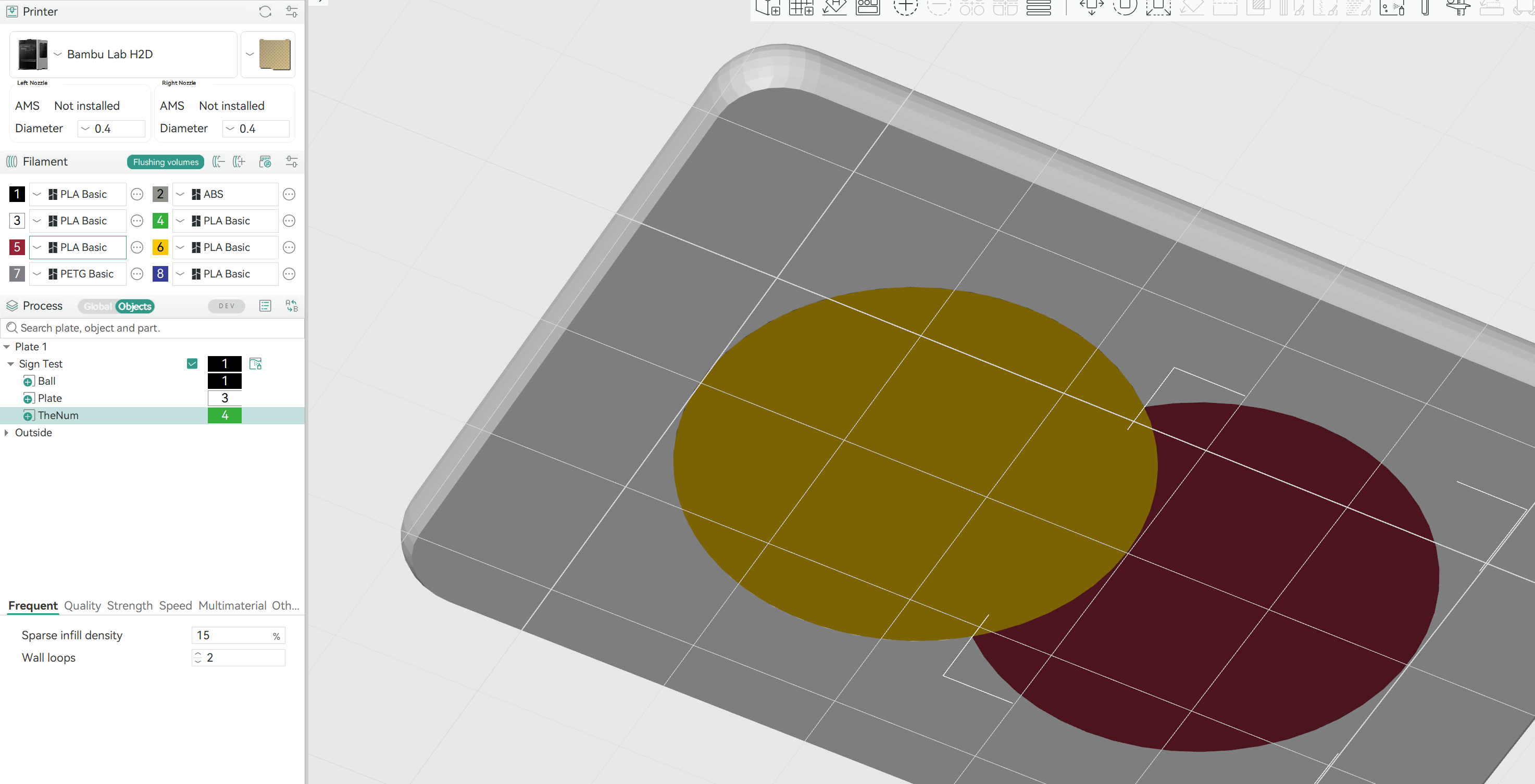

Do you not assign colors/filaments to the individual stl files that make up the design?
Just looked up and you do… In the objects tab?
If I paint the faces in Bambu, It still does the same thing, albeit a little smother and in the base white.
