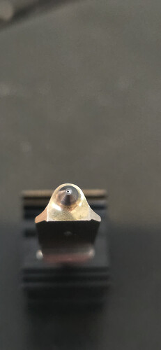

I purchased a 0.4 mm tungsten carbide nozzle from Bambu Lab. Upon inspecting it prior to using it for printing engineering filaments, I noticed that the nozzle opening does not appear to be centered. When viewed closely, the opening also appears to be slightly angled rather than straight through. Based on my experience, this does not seem normal for a precision tungsten carbide nozzle, and I am concerned this may be a manufacturing defect.
for single extruder wont matter :slight_smile:
I don’t have one of those nozzles but that is not normal and I recommend contacting support. This will most likely cause some defects in the print as the filament won’t properly be smushed around the nozzle.
Thanks for sharing the clear photos. Even if print quality does not degrade immediately, an off-center orifice guarantees asymmetric wear when running abrasive filament. That is not a theoretical concern. It is a predictable outcome.
More importantly, this is a premium-priced nozzle. You paid for something marketed as high-end, not commodity hardware. The equivalent analogy is paying for Pirelli racing tires and receiving something that barely meets minimum spec. The issue is not aesthetics. It is basic concentricity.
If this part had been received into my company, it would have been rejected at inbound inspection as nonconforming. Off-center drilling is a fundamental manufacturing defect, not a cosmetic variance. If this were my money, I would demand a warranty replacement with a properly manufactured nozzle.
Be prepared, however, for a response that reflects what the Chinese often call “Chabuduo” (差不多), meaning “close enough.” That mindset may explain how a defect like this passed QC, but it does not justify charging a premium price for it.

The nozzle doesn’t just extrude plastic, it also “irons” the extrusion to make it flat. If the hole is off center, that ironing will be off center, too. IMO this nozzle is defective and won’t produce the same quality of print a properly centered orifice would produce.

I may be wrong but it seems small for 0.4mm. Is it really the orifice you’re seeing or part of it with some filament residue from production around it. You may want to try to purge it or do a cold pull and re-inspect.
I zoomed it in a bunch, make judgements here I guess
In my judgement, I’d say that nozzle is NFG.
As all my nozzles came primed with white filament I wouldn’t disregard that’s some left over we see
You should contact support for a replacement. The “angle” you speak of probably isn’t important, as it’s held constant, but the orifice being off center so dramatically is a legitimate problem.
I agree not to mention I tried to stick the declogger needle through it and it didn’t budge

Then, it has a defect and bambu needs to replace it. Submit a ticket if you haven’t yet done so
Look like some white filament to me as they test the nozzle before shipping them out, ive had a few arrive with white filament inside.
