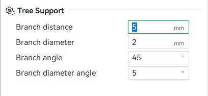

I have this overhang that is supported partially by trees instead of the solid like the rest of it right at the edge where it connects to the rest of the part. Is there a way I can manually turn that part into a solid base as well?
Share the screenshot of your support settings.
Changing the branch distance to 1 mm is the best solution i found so far, but still keeping the supports on that part as trees obviously.

Hybrid doesn’t change anything. Will use 1mm branch distance.
