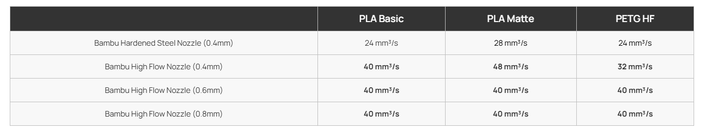

Typo inBambu's reported HF performance?
How is it that the 0.4mm HF nozzle can print at 48mm^3/sec, but neither the 0.6mm nor the 0.8mm do? Is this real or a typo? Usually, the larger the nozzle diameter, the flow is either greater than or at least equal to the smaller diameter nozzle.
That table is correct — it’s not a typo. The reason the 0.4 mm High Flow nozzle can reach higher volumetric flow (48 mm³/s) than the 0.6 mm or 0.8 mm versions is due to the design trade-offs in the hotend and filament heating path.
The 0.4 mm HF nozzle is optimized for maximum flow within the thermal limits of the heater and melt zone. When switching to larger nozzles (0.6 mm and 0.8 mm), the melt zone becomes the limiting factor — there isn’t enough time or surface area to transfer heat efficiently to the filament at higher extrusion rates. In other words, the heater can’t fully melt filament fast enough to maintain consistent flow through those larger diameters.
So even though larger nozzles could theoretically handle higher flow, the printer’s thermal design (heater block, melt zone volume, and extrusion pressure) becomes the bottleneck, capping all of them at around 40 mm³/s.
How come this same limiting factor does not apply to the 0.4mm HF nozzle?
As in, how does the HF nozzle push past the limitations of the printer design?
Simple math.
If you double the diameter, the circumference doubles also, but the area quadruples.
Therefore you have relatively less surface area to heat a certain amount of filament.
Even though larger nozzles have a bigger outlet area, the heater block’s melt zone doesn’t scale with nozzle size — it stays constant.
The 0.4 mm HF has a much shorter and more efficient internal melt path, so it reaches full thermal throughput within the H2D’s heat limits.
For 0.6 mm and 0.8 mm HF, the required melt volume grows with r*r, but the available melt energy doesn’t.
That’s why all larger nozzles hit the same 40 mm3/s cap — the bottleneck isn’t the nozzle, it’s the melt capacity of the hotend.

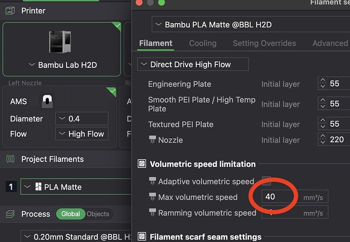

It is a typo, if you check the filament profiles the max flow rate for matte is 40mmÂł/s on 0.4HF nozzle.
The larger 0.6HF and 0.8HF nozzles should not be much faster, but not slower either. In real life use you might be able to squeeze a tiny bit more speed from the 0.6HF from my experience.
