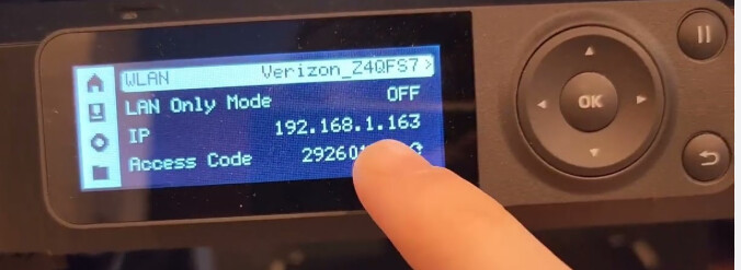

My P1S doesn’t let me reconnect to Bambu handy or studio, I have restarted it several times, and my internet is perfectly fine, what should I do? Studio said check internet or firewall before I logged out of the internet
Welcome to the forum.
Does your printer display show that it is connected to your wifi? If not it’s important to remember that it must be connecting to 2.4ghz and ideally use a different name than the 5ghz channel. Also remember that short passwords with out special characters needed.
