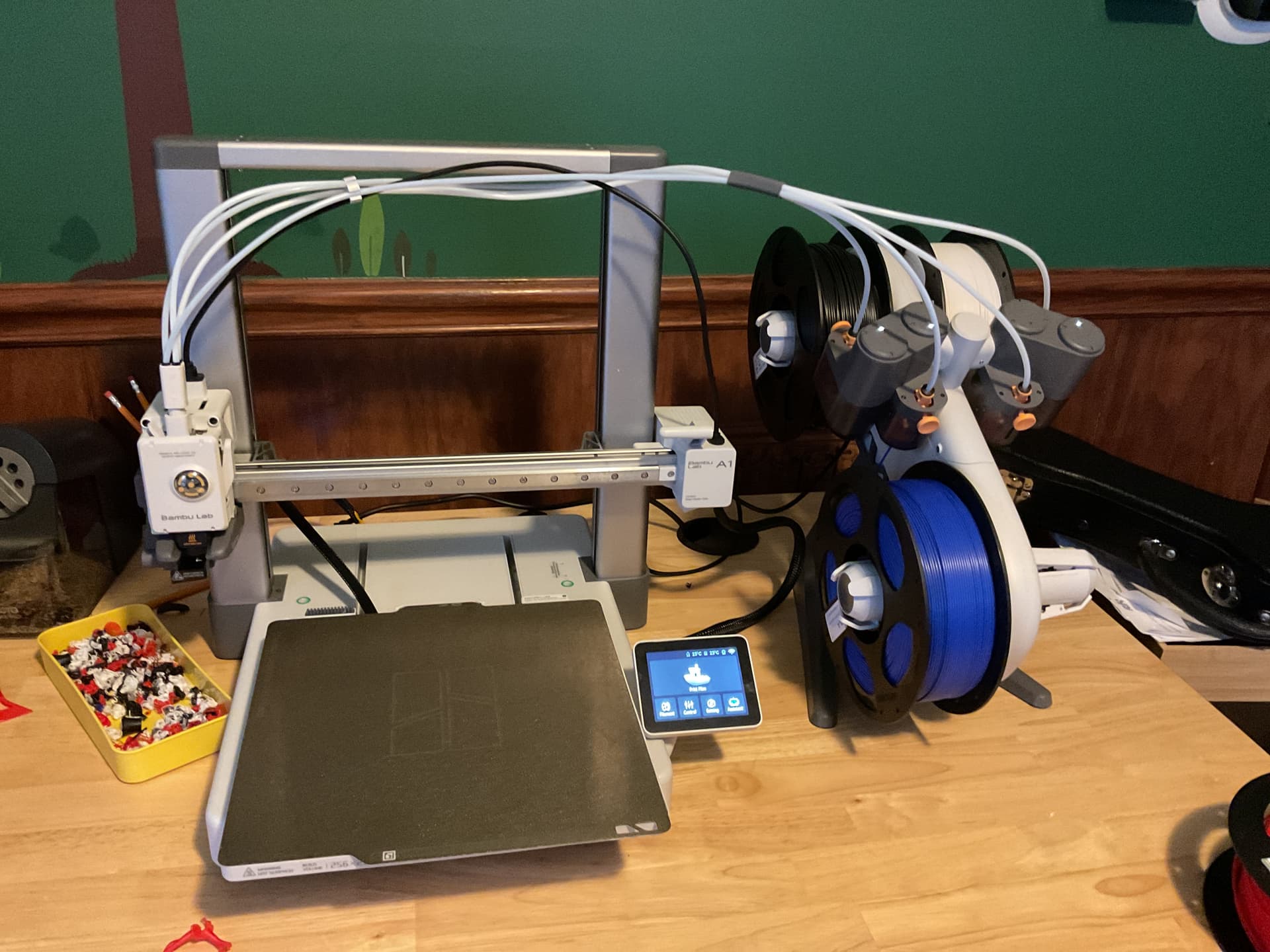

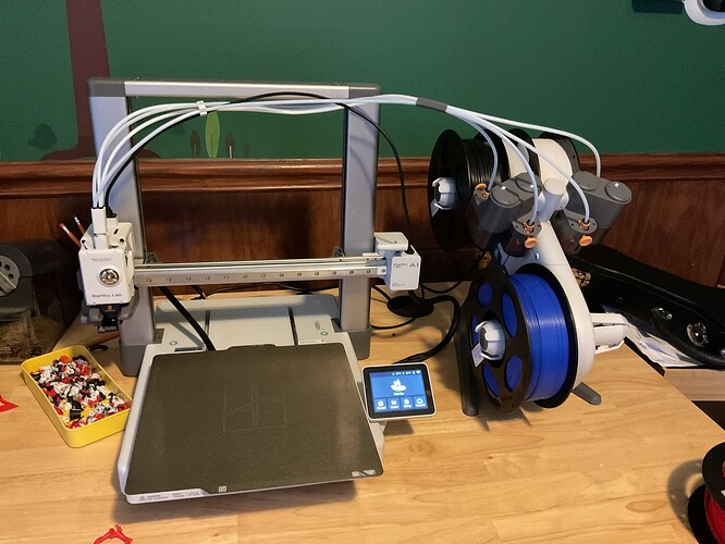

My brand new a1 cannot change colors, it will always give me the “unable to feed filament into extruder” error. I have been trying to fix it, nothing seems to work. Pterodactyl are fine, everything works, filament isn’t tangled. Keep in mind, this only happens on ports 1 and 2. As of last night though, The filament may be slipping. It won’t feed the filament and makes this awful squeaking sound. Filament is not bambulab, 1.75 mm any cubic pla on ams lite, not sure if that could be the problem, but I still had the problem with bambulab pla too. Printer is only a month old, not sure what to do!

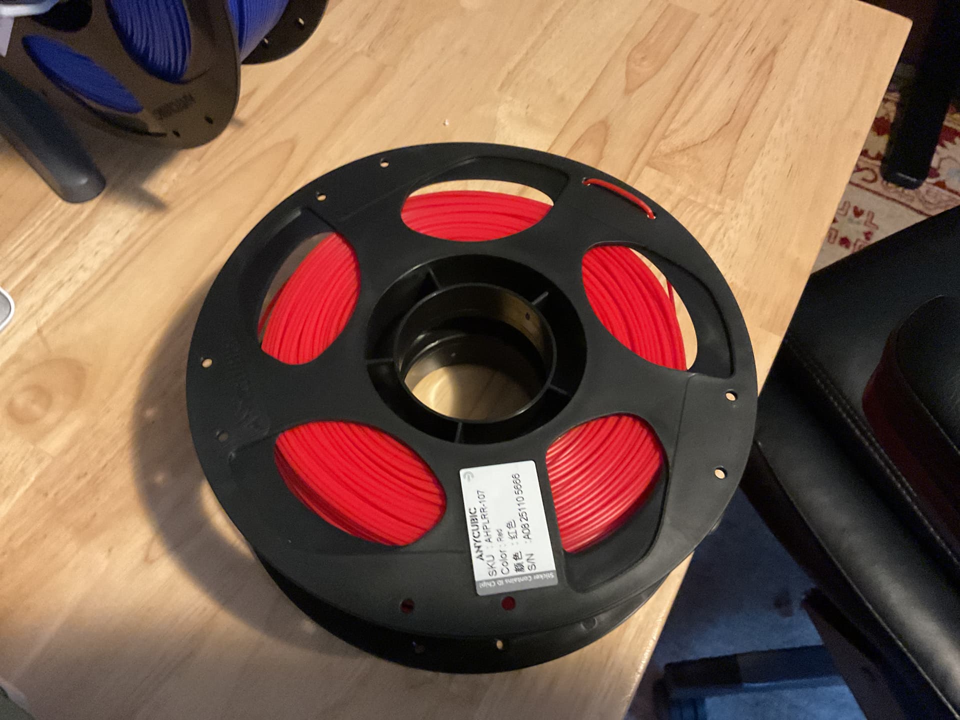

I don’t know if this has changed in the meantime, but the last I heard was that Anycubic spool aren’t really compatible with the AMS Lite. There seem to be different spools from Anycubic, some that work better, others not at all. In addition, there are versions made of plastic and others made of cardboard.
Check which spool you have and print out an adapter for the AMS Lite if necessary.
The thing is, I have 4 rolls, only 2 of which don’t work. I have a plastic roll and slots 3 and 4 work fine. It is just one and 2. I found a similar topic, which said it was a feeder unit issue.

No, they are plastic. Ptfe tubes might look weird here but they are fine

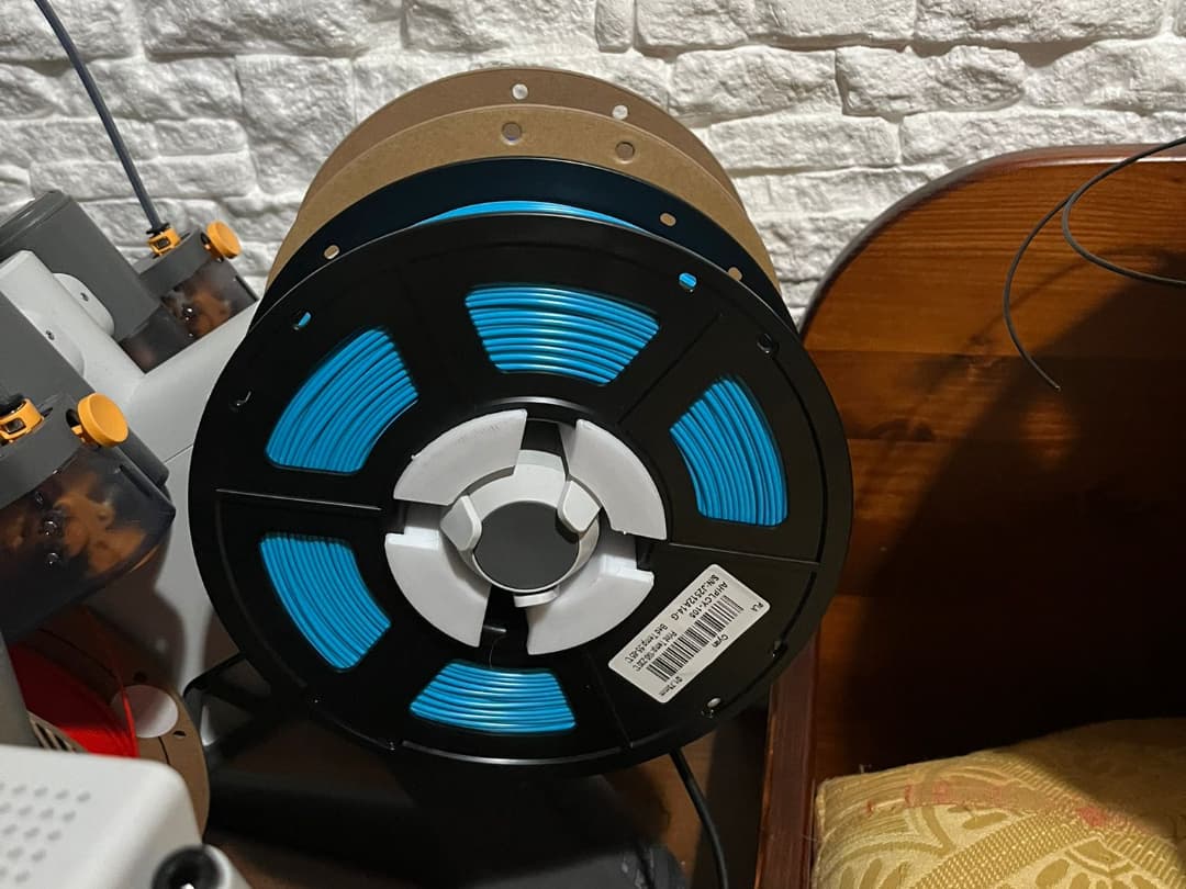

OK, thanks (edit: the carboard one shown in the photo works fine on those spindles?). I haven’t used AnyCubic (no particular reason) but it looks like those are the newer twist together spools? I got the impression that the spool opening is very close to the same size as the bambu spool, if not slightly smaller (edit: I meant the core, not the opening, I haven’t seen any measurments on the actual opening) (not sure if that is a factor or not, just mentioning it). Do you have ANY other brand of filament that you can try on those positions to see if they behave the same?

Let me make sure I understand. As you face the AMS, the spools do not work when on the left, but they do work when on the right? (I am going by your pictures so hopefully I have the sides correct).

No, It fixed itself when I moved all of it around. No idea why
