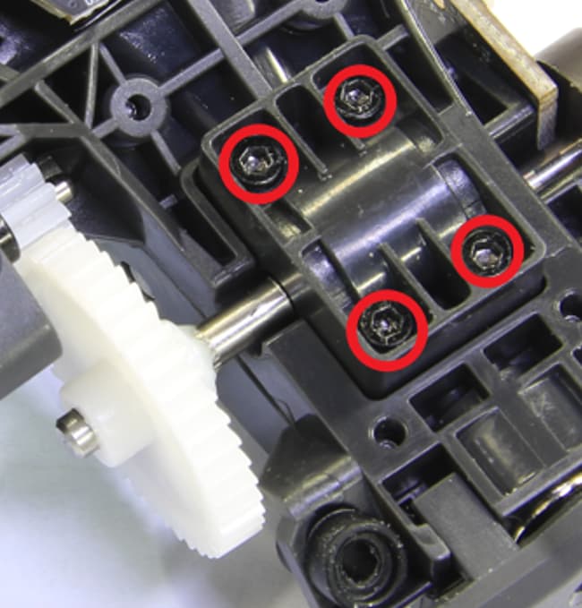

For those with the same problem I found this and will report back later today after further troubleshooting ….
Following the instructions given and the photo provided I went ahead and checked these screws… mine “looked” different but some screws were loose so I gave them a slight turn.

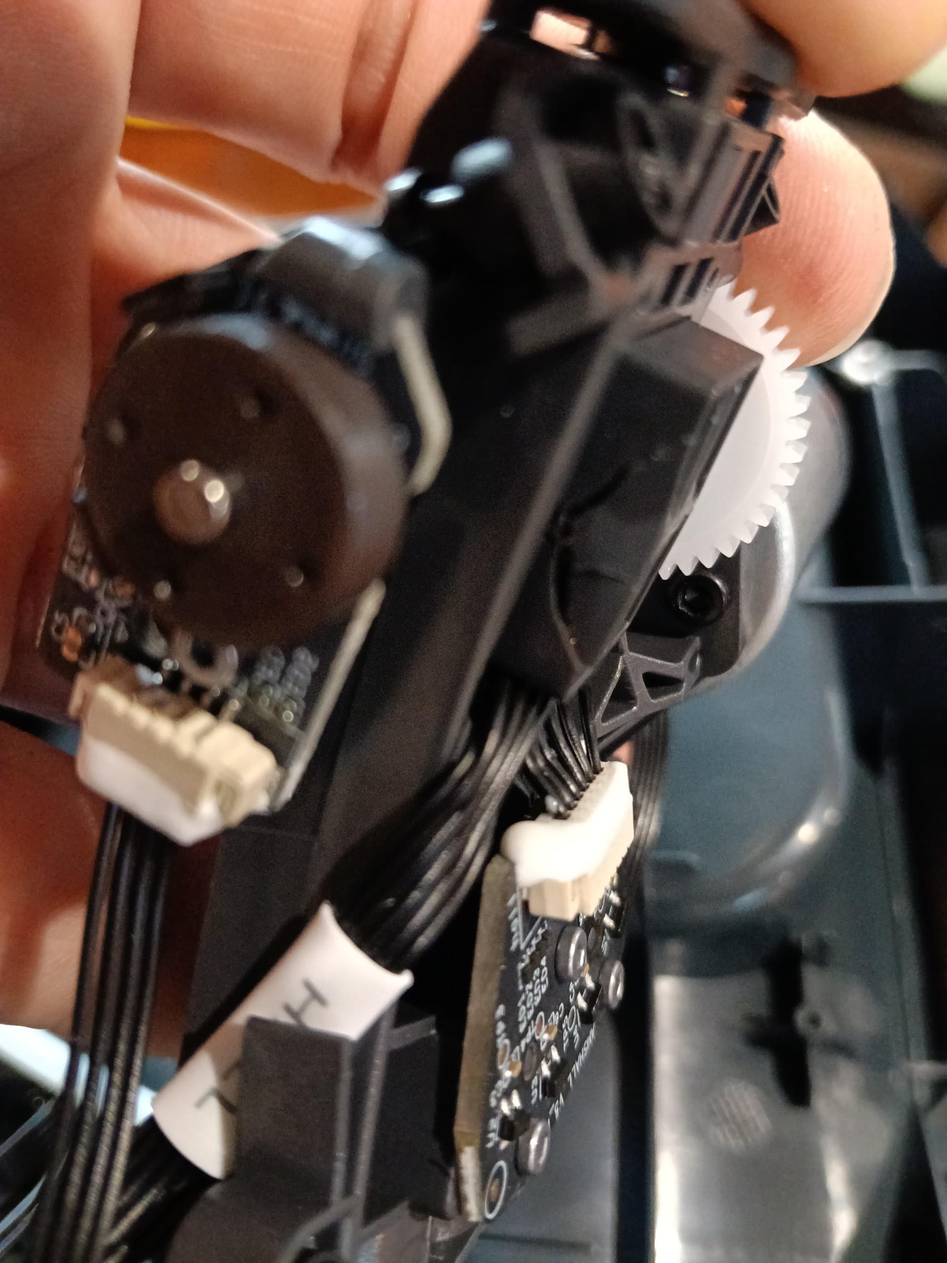

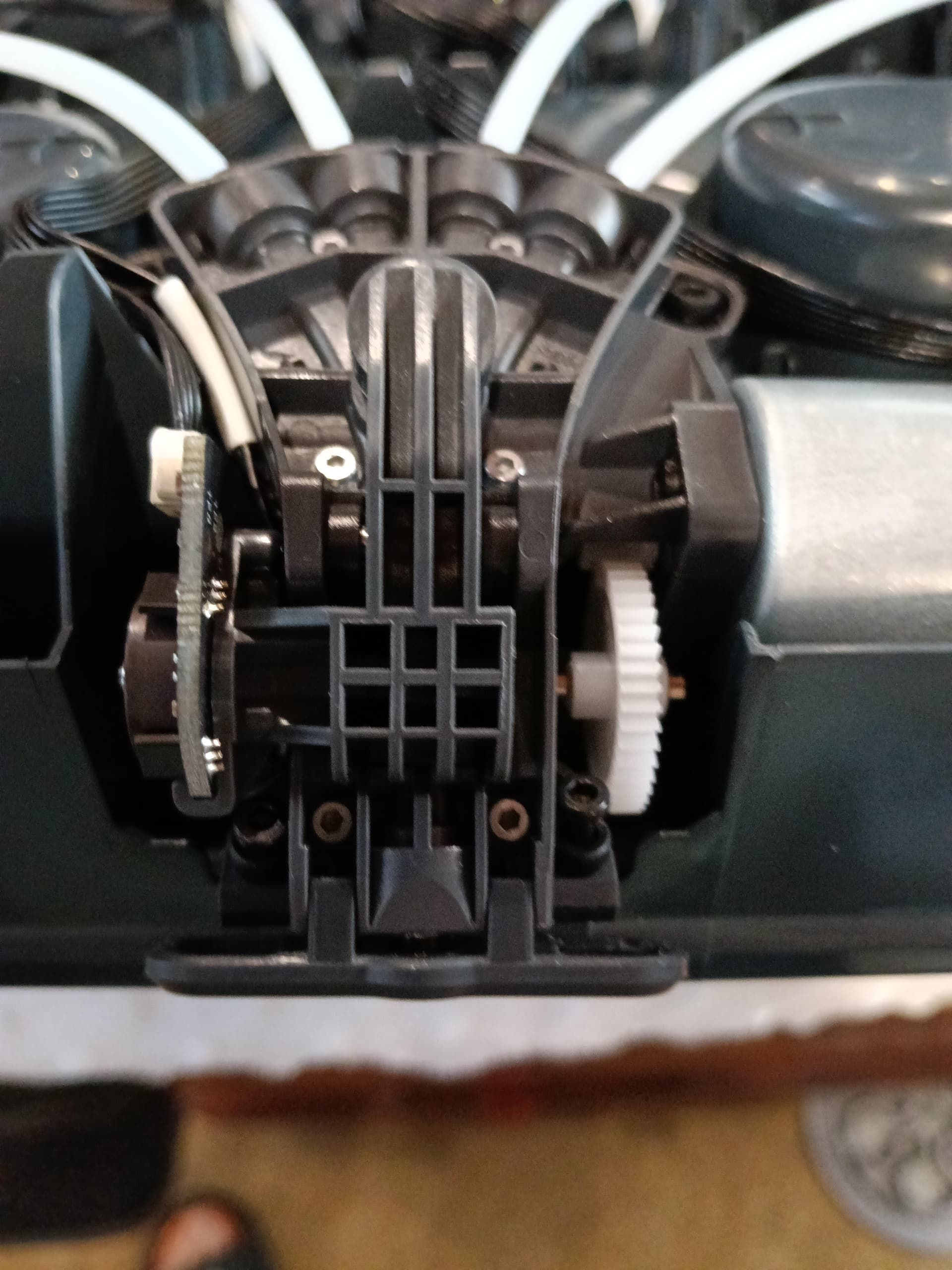

What I saw when I opened up the AMS
The problem still wasn’t fixed so I decided to take the whole part off and check underneath to see what was going on there… then I realised the image they were showing was the underside and no point tightening these screws as the whole part was cracked… I have put in a support ticket and hopefully will get a replacement part soon.

The part is called an AMS Bearing support for internal hub unit.
It appears to be an issue for many people and as a person that has worked in assembling electronic devices for UAVs for a living a decade ago I am going assume it is more of an instillation issue of possible over tightening? Where mine cracked it definitely looked like that was a possibility. I guess it is a balance between under tighten and it won’t grab or over tighten and it puts pressure on weak spot???
