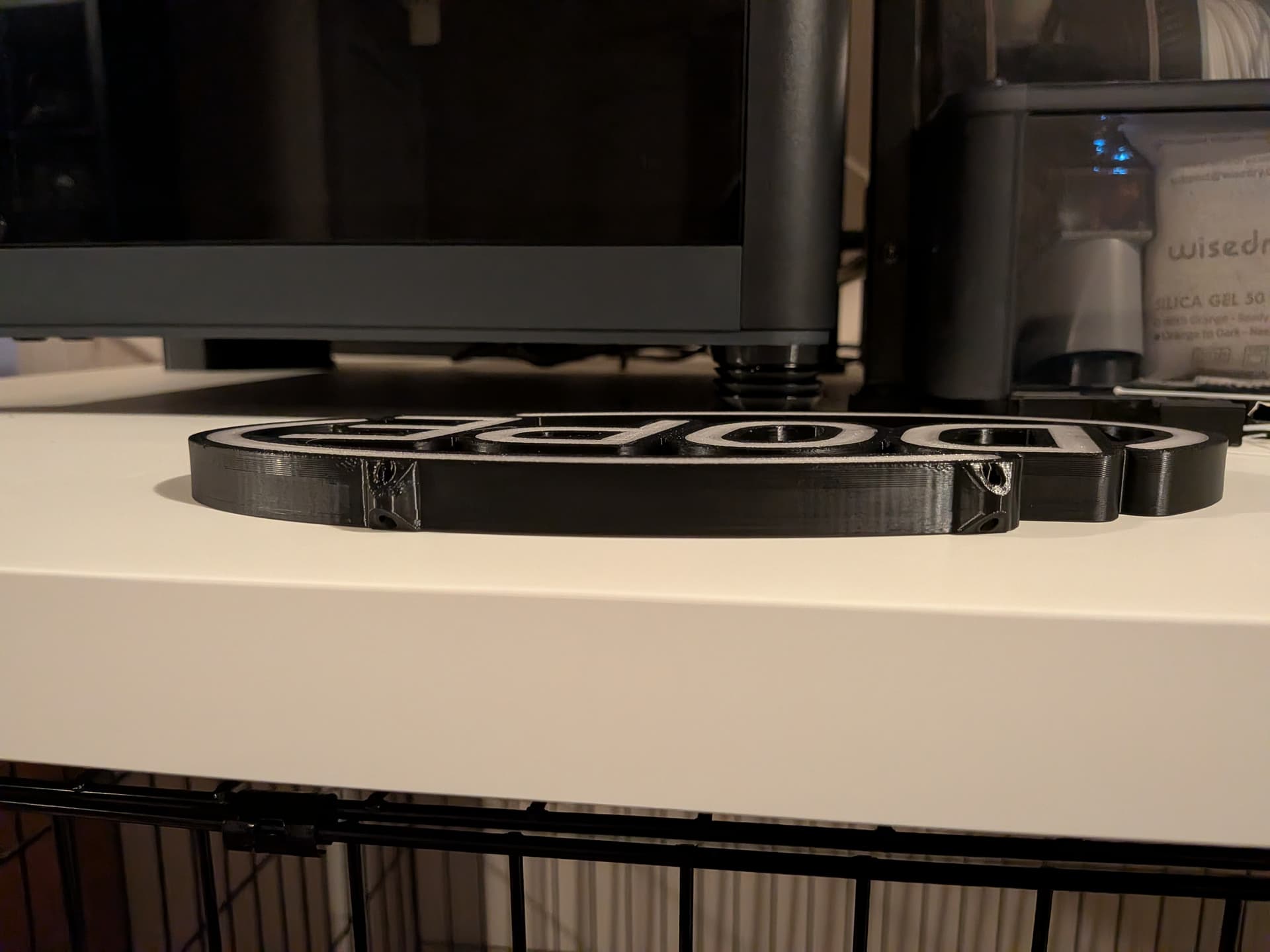

Unable to find settings to get P1S to print PETG to print this 'cleanly'

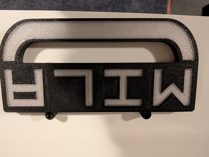

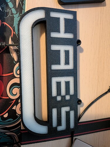

I am trying to use my P1S to help out a friend print his signage in PETG on my P1S printer but despite everything I try I can’t seem to get it to either look similar to how their older Ender 3 Printer can do (but he has to swap the filaments in order to do multi-colour printing) which more or less looks like my last 2 pictures which are in PLA to show the model does print quite well/nice in PLA.
PLA Version:
Since they are able to print it ‘properly’ but very slowly on their printer it makes me think I have one or multiple PETG settings still ‘wrong’ in order to not get some of the black to end up in the clear sections or the outer wall looking ‘cleaner’ (yes I know PETG won’t be as good at finer detail then PLA).
This is done using a 0.4mm nozzle with the ‘top’ of the bottom printed face down
Quality - Standard settings for 0.20 mm
Layer Height is 0.2 mm
Toggled on/off with no changes: Order of Walls Inner/Outer to Outer/Inner
Toggled on/off with no changes: Smoothing wall speed along Z

It seems the slower prints speeds give me the best outer wall printing but still not ideal and all still result in some of the black getting captured in the clear section as shown.
Thanks for posting clear pictures. I may not be following which part of the images you’re unhappy with, so I want to confirm that the contrast shown in the two photos is what you’re referring to.
As noted earlier, differences in surface sheen (shiny vs. matte) are often speed-related. Try the following:
  1. Change wall order from the default inner/outer to outer/inner. This allows the outer wall to set first before the inner walls are laid down. If there is contraction or density-related behavior in the filament, this can influence surface finish.
  2. Increase the number of wall loops. If you are currently using 2, try 3 or 4. If you are using 3, try 5 or 6.
  3. Reduce wall speed to 25% of the current value. If that resolves the issue, increase speed incrementally - for example, from 25% to 37.5%, then 50%, and so on - until the effect reappears.
As a time and filament-saving diagnostic, use the cut tool to isolate a portion of the model that reliably reproduces the issue. If you cut out a corner or feature and fit 4-6 copies on the build plate, you can vary wall and speed settings per model and run multiple experiments in a single print. This is similar to what Orca’s calibration utilities do, except you’re using your actual part geometry as the test case.
There are a few things I am not happy with, the first is in your image where it’s not consistent texture the entire way. That ‘top’ would be part of the bottom layers as is printed with the cover facing downwards.

I am also trying to get rid of what I guess I could call random black stringing that ends up in the clear section, such as if you look at the O you can see some black filament in there. I do have a Prime Tower and I’ve even tried max flushing between black to clear.
Yes, I outer wall speed as inner wall speeds likely will not address the issue. Sorry for not being clear.

Especially with those outer walls Bambu should be able to do it with their own filament as well as it doesn’t solve the black filament stringing sometimes into the clear sections for no good reason. I’ve also replace the cutter, cleaned the nozzle, and replaced the nozzle whipper too. All we can really think of is it is one or multiple Bambu specific settings causing this.
I had only the worst experience with the old PETG basic. PETG-HF is much better in my opinion. I guess the image with the partially matte and glossy surface was the basic?
I also see lots of VFA, those vertical repeating lines resembling waves. I just yesterday did a VFA test on my X1C and worst occurrences were between 80 and 150 mm/s. Only above 200 and below 50 mm/s I didn’t see them at all. If your printer behaves similar to mine, it would be best to avoid that range. 125mm/s was right in the area of worst VFAs at any direction. With PETG-HF I would use 200 for outer walls. For PETG basic, that is too fast in my experience, so I would reduce to 50 mm/s.
Then, I would suggest wall order inner/outer/inner with at least 3 walls. That combines an outer wall that is not influenced by infill etc but also has no retraction at end and start of the line, which gives a much nicer seam.
Next, in filament settings in tab cooling, you could enable “don’t slow down outer walls” for consistent sheen.
