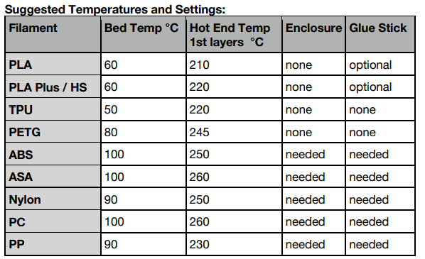

When I got my WhamBam Carbon Fiber Plate, I had to start from scratch, as no one had a working setup at the time. WhamBam’s own recommended values were quite off for achieving a good, clean first layer.
This is the value that prints a perfect layer for me every time:
This is what WhamBam suggests:
Getting the nozzle and bed temperature right is a bit tricky. I kept testing until the model stuck to the bed as it should, and then gradually increased the nozzle temperature until the first layer came out perfectly.
