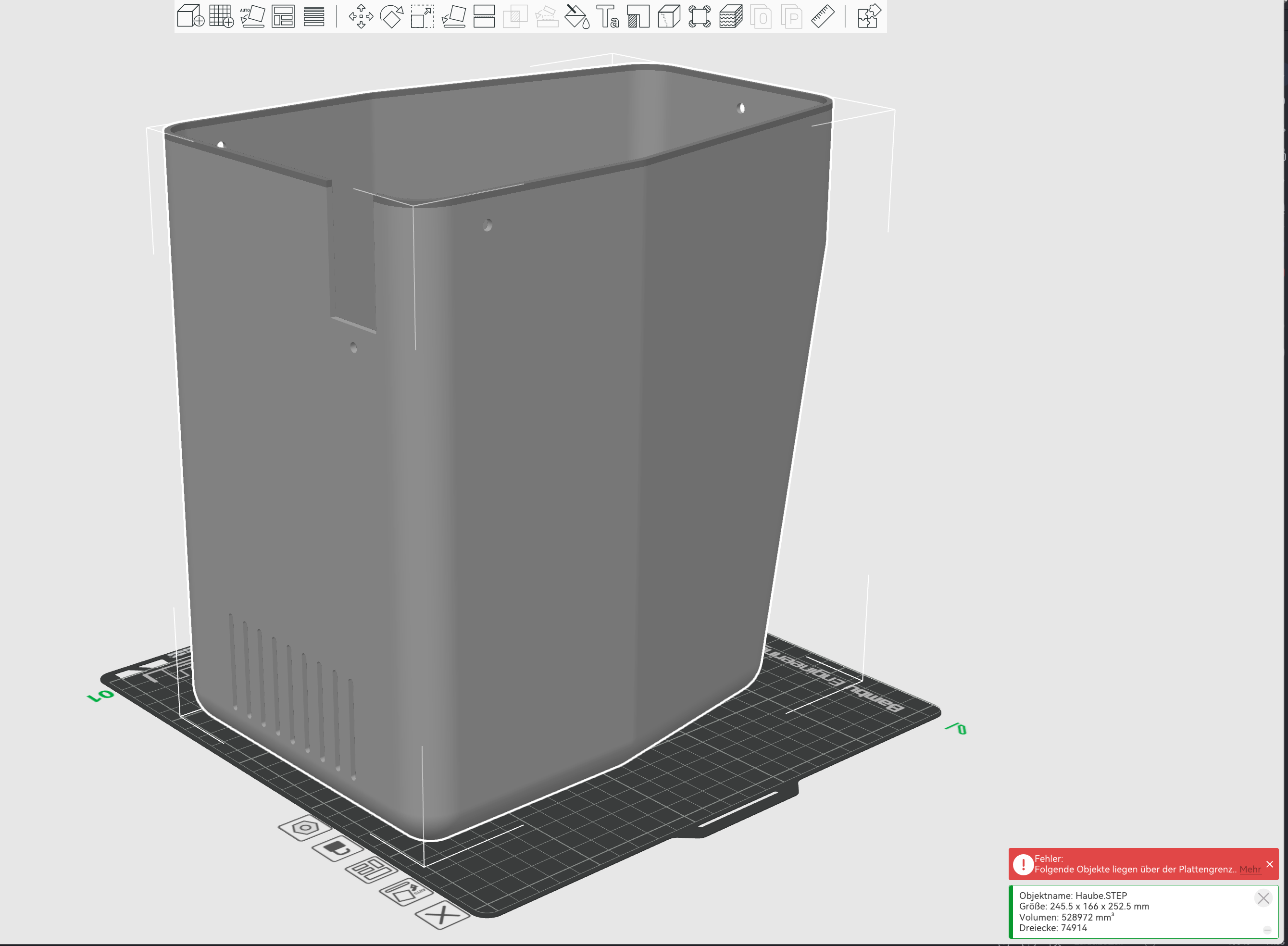

I am currently somewhat confused by an error message displayed by my Bambi X1C. I have created a housing that is somewhat tight, but according to the manufacturer’s specifications, it should fit into the 256 mm x 256 mm x 256 mm printing space.
However, I am getting a message saying that the enclosure is too large and I cannot print it. According to the dimensions at the bottom right, the manufacturer’s specifications for the X1C print chamber are not exceeded in any axis.
How can I solve this problem? Are the specifications for the X1C in the data sheet incorrect?
It’s hidden in your image but you should left this white zone free for print head to reach the filament cutter:
Yes I know. This area is not covered.
When I reduce the height to 245mm it fits to the printing volume of the printer. So the max printing height of the X1C is not 256 mm
here you go - Print volume limitations, and how to use the full build volume 256x256x256mm³ | Bambu Lab Wiki
