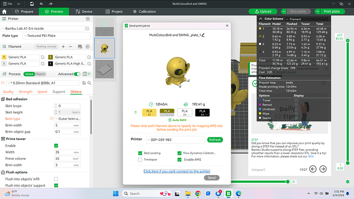

This is the first time I am going to use the ams lite on my A1 and after I slice the model it will not highlight the send button so I can send it off to the printer, I am not using Bambu filiment is that possibly the issue, I have included a screen shot.
It looks like filament 2 is not recognized to be the same as in the slicer. If your settings are good though, you can just select the grey arrow under the second spool and select A2.
After doing a little more digging, I found that it was set to ABS instead of PLA and that was not allowing me to send it. I changed it and way it went, thank you for your input!
