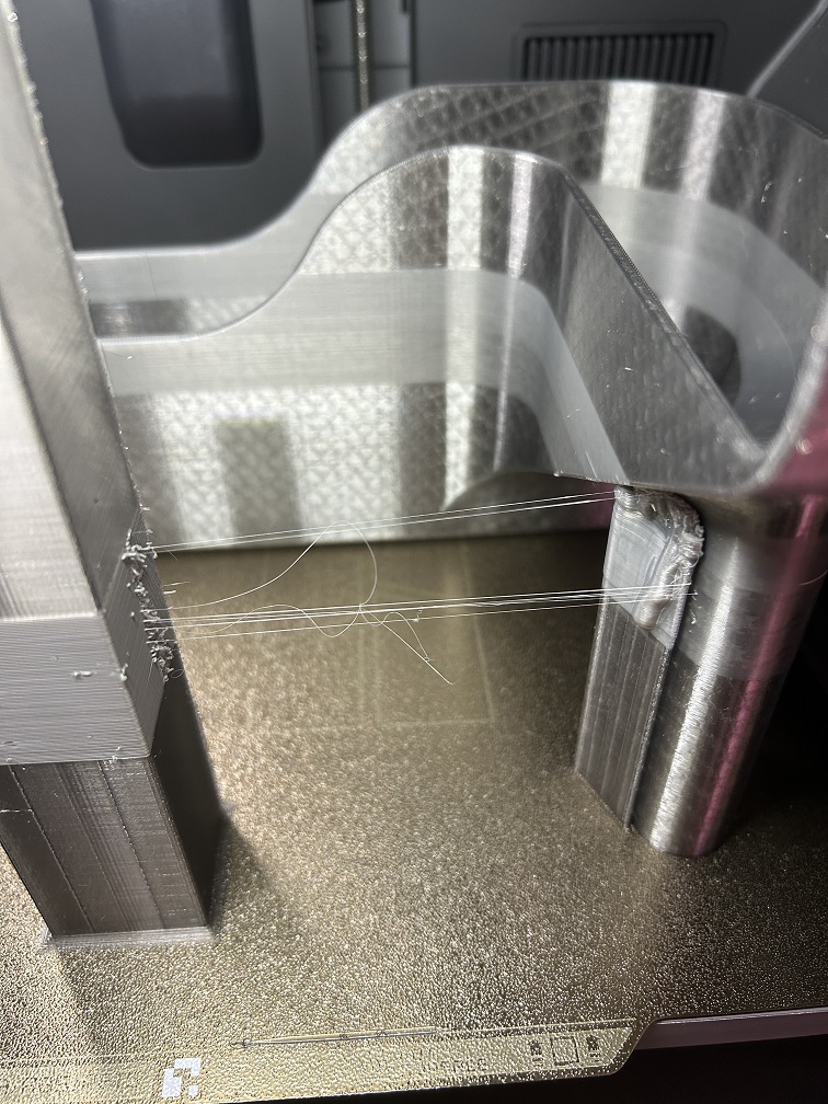

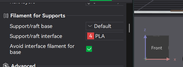

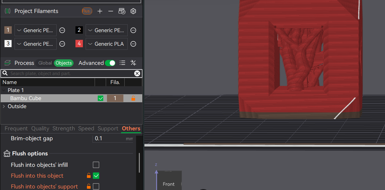

My P2S, which is connected to four AMS-1s, was printing a 20-hour solid single-color PETG model with PLA specified as the support interface. Around the middle of the print, the main body started printing in PLA and continued for about a third of the model height, then switched back to PETG with PLA being used as the support interface again.
I can use the object because it is still functional and not used in a visible location.
The photo of the model on the print bed shows stringing and some melted filament running down the side of the support. I believe this was caused by PLA being routed to the hotend while it was still using PETG settings.
The support came off cleanly.

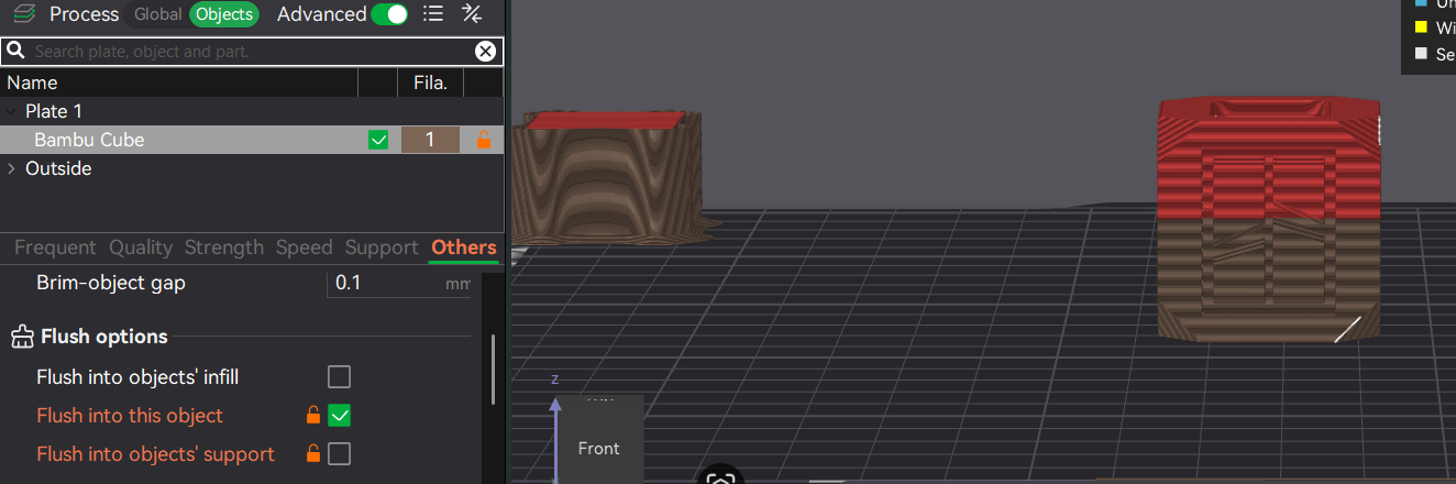

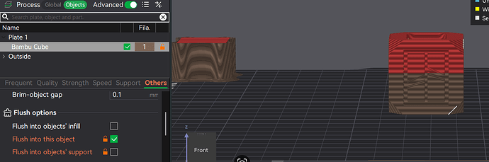

Are you using flush into object ? object mode
I just reopened the file and checked. Flush into this object is not checked. I normally use Flush into support, which was also the case this time.

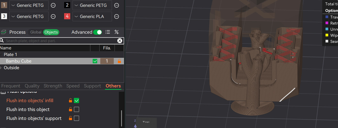

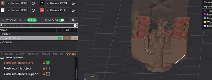

This is with flush in to support (global) and flush in to object (object mode) set
and avoid interface filament for base disabled , same result with the prime tower disabled ,which greys out all above settings except enable support , i recently used flush into infil which did work well
flush in to objects infil (global) no setting in object mode
flush in to infil (object mode)
could this have something to do with a recent stealth update that reset studios default from object mode back to global ?

According to BBL, whoever created the model inserted instructions to flush to object into the STL. The override to the slicer settings caused the issue.
So nothing to do with the two p2s updates we`ve had this build either ?
How do you insert instructions to flush to object into a STL?
OK, I misunderstood what Support was telling me. Apparently my flush settings were incorrect and caused support filament to be printed to the wrong area for a while.
