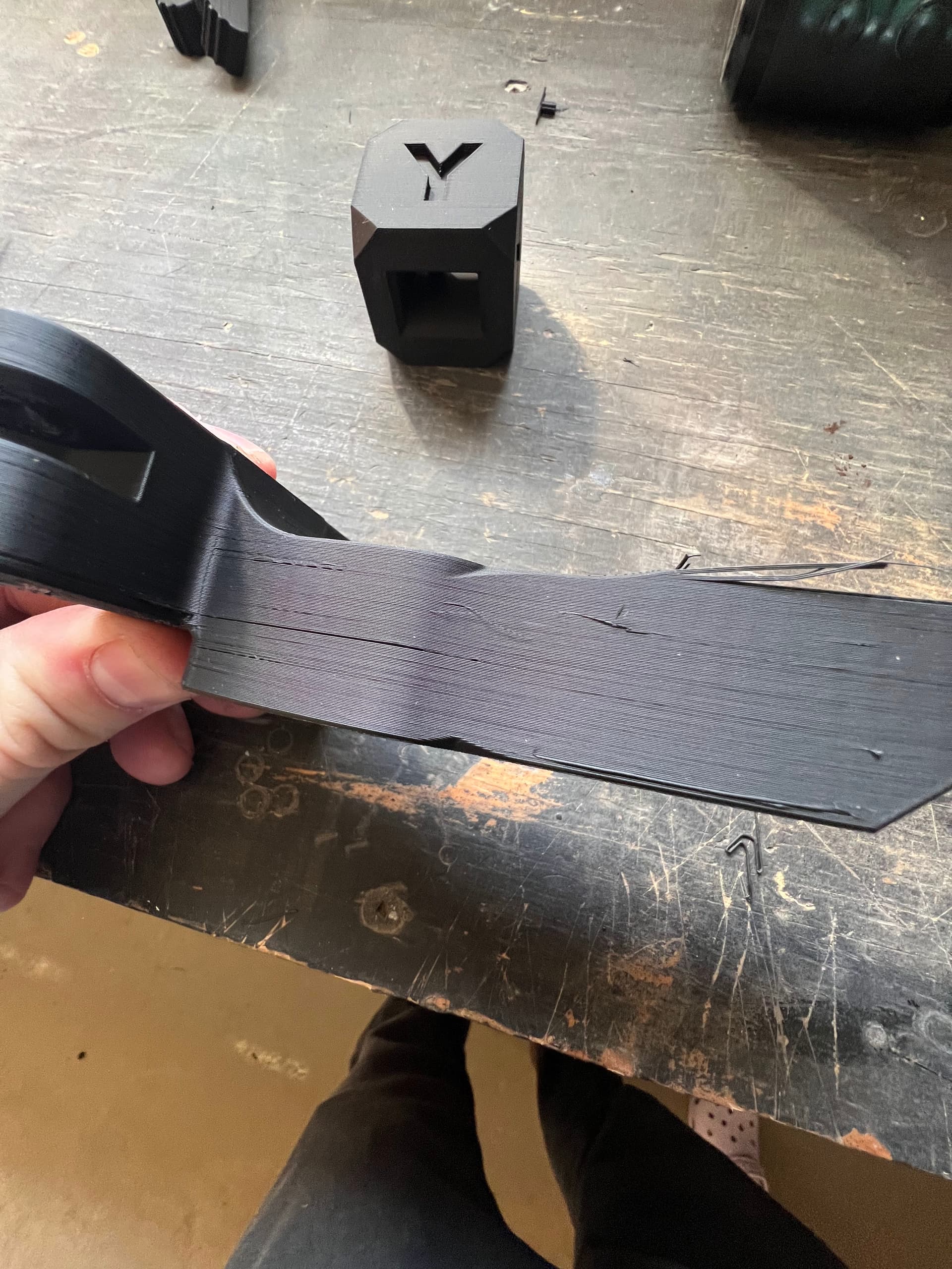

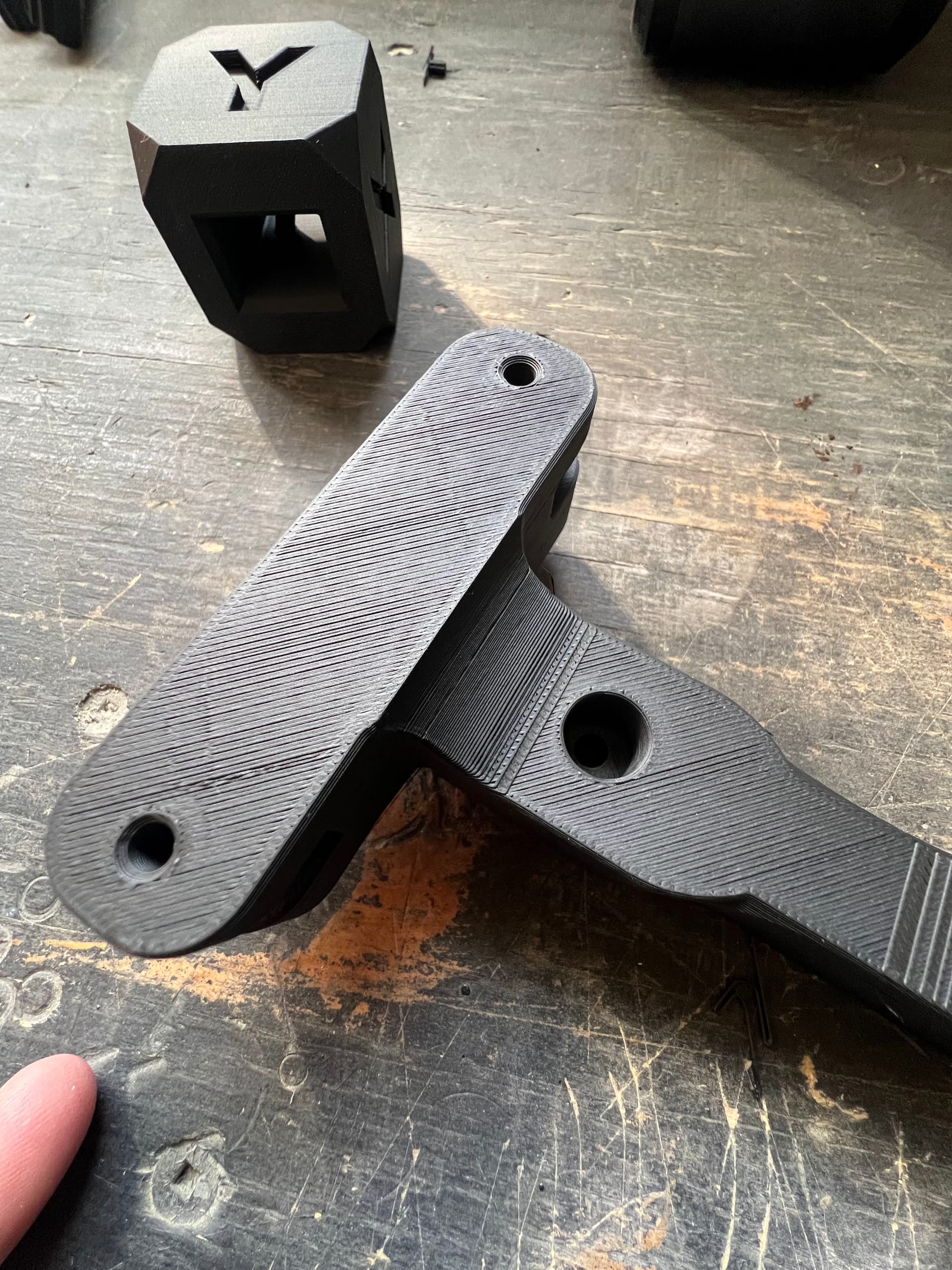

Hi. I have a P1S with around 3800 Hrs on it. Over the last month I have noticed some under extrusion happening, mainly top surfaces and the odd spot on the walls of prints.
it has gotten to the point I can separate the layers and walls easily.
See attached pictures for the print Quality.

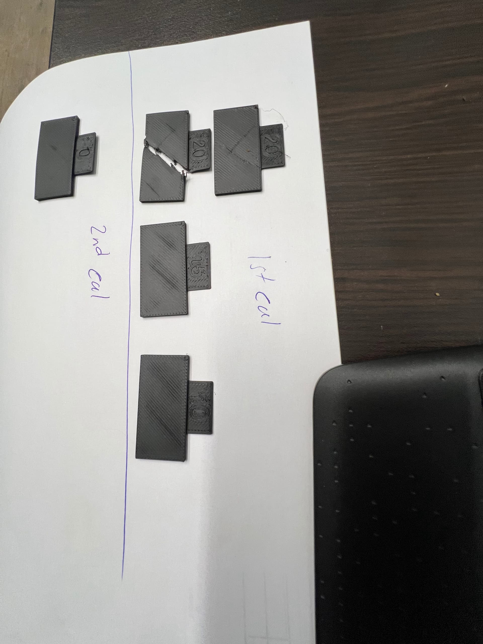

once done I tried to calibrate the filament I use again.
did the K Value flow test in Bambu studio entered the value that looked the best (0.015) and saved.

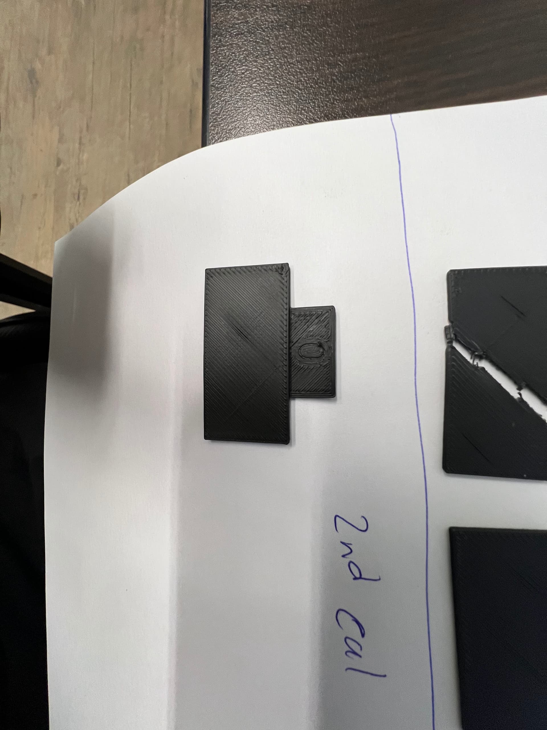

Then I did the Rough calibration of the 10 Swatches. Number 20 was still under extruded…
I then did the Fine calibration, 0 was the best but slightly under extruded Same as the 20 from before.
After all this I have a Extrude ratio of 1.176.

Here are pictures of the Calibration Swatches I Chose

I fixed it.
It was worn out extruder gears
