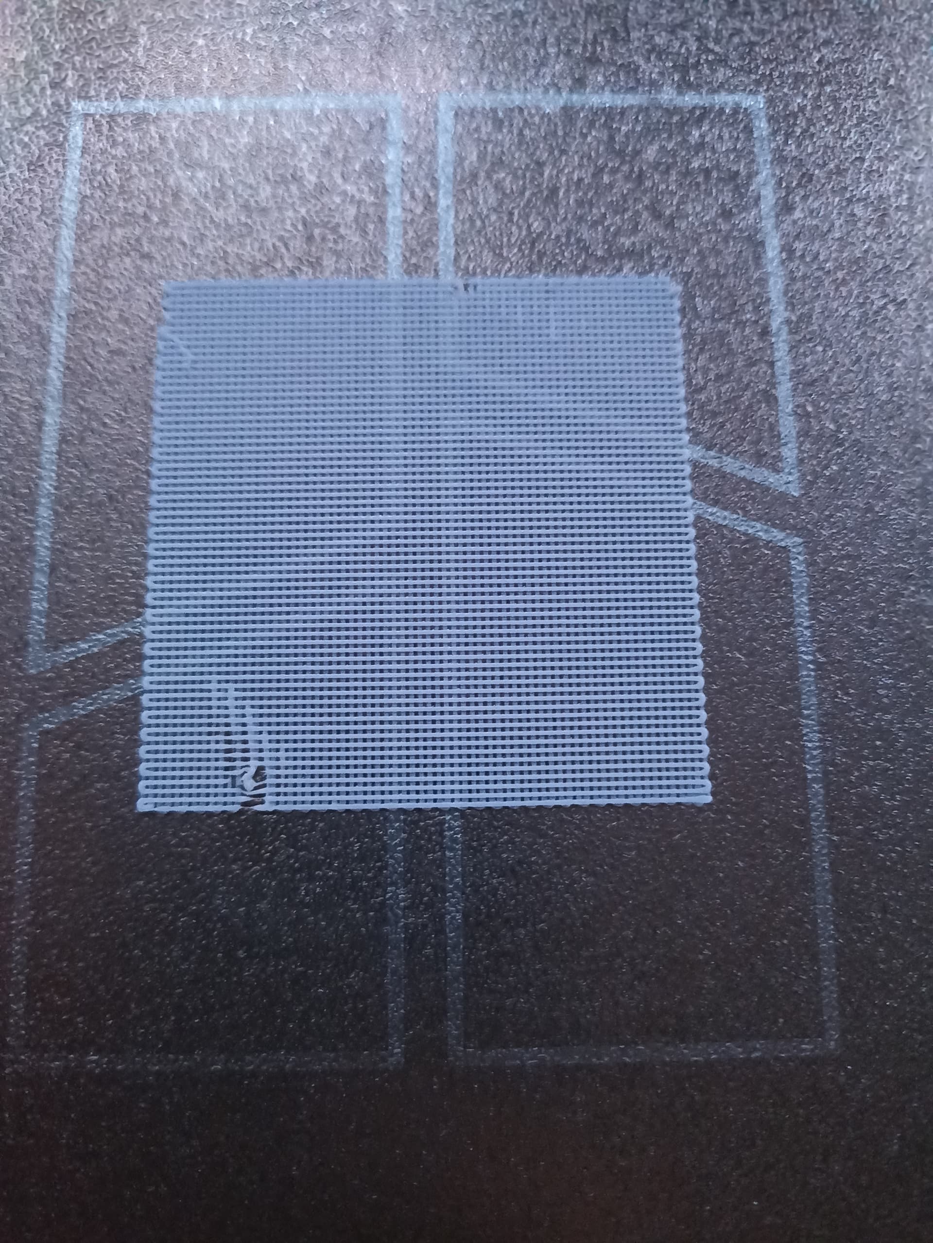

Im trying to print a grid with a .1mm gap in holes, now theoretically according to the slicer with my settings it should be possible to do this:
However the actual result doesnt line up with the slice, because the gap dissapears when printing, I assume it pushes out too much filament causing it to spread over time and close the gaps of the rows.
I figured the easiest way to handle this would be to manually underextrude the material so as to prevent that.
But I dont really know how to do that, never messed with settings like these before, would appreciate it if someone could help me out here and tell me how to set this up, or know of a better or easier way to handle this case.

Achieving 0.1mm features is asking a lot from FDM printing. Have you tried reducing line width settings and maybe reduce the temperature? Using a 0.2mm nozzle may help.
Ive been experimenting the last two days with how to achieve this.
Doing some simple numbers tweaking controlling the flow rate.
Once I reached a certain threshold of underextruding, it seemed feasible to get a grid of that size, since the lines no longer bleed together after printing them.
However, it was not enough, despite the thinner lines it proved difficult to get them to stick (I was using the Textured PEI plate that came default with my P1S). So I started increasing the bed temperature, to try and improve the adhesion.
Going up from the default 55°c that was default for the Bambu PLA Basic profile, to 70 seemed to stick well enough to minimize the loss of inital layer lines.
The biggest problem I then noticed is that certain line’s sides were sticking closer together (bleeding into each other) than other, so I looked at where the toolhead started printing the lines and where it stopped, noticing the pattern that wherever the seams were placed the most bleed happens.
Setting this to nearest improved the results and made it more balanced, but still shows clusters of them bleeding together.
I therefore attempted to do this manually in an alternating patern, however for some reason it just refuses to adopt the drawn seams? Maybe I dont really understand how the tool works, but I assumed that the areas marked would be seam placements…. here two different test cases wher ethe slicer just refuses to alternate between the sides:

You’re really doing this the hard way!
If you want to try to fool the slicer to make your top and bottoms line up like this, you need to understand whats happening with line width and flow:
By increasing line width, you technically increase the distance between extrusions, but the solver ALSO increases the flow to match. So if you want to just simply make it anemic - increase line width AND reduce flow dramatically.
This quick and dirty example is a cube, 0 wall, 0.8 width top and bottom, 50% filament flow, and monotonic line (to make it look nicer but is not important)
If you do some geometry volumetric math you can probably predict the numbers to use to achieve exactly 0.1mm, but this can be tuned extremely quickly with trial and error

Stole this infographic from prusa’s forum but the concept is same - if you declare your line width to be really wide, the slicer is still going to want to fill it all with plastic - thats what it does! And it calculates that by the VOLUME of the space.
But… we dont want that filled up. We want gaps on the sides. So if you make that multiplier low, it’ll still position the lines far away, but not extrude enough plastic to fill the area.
If you do that twice, rotating by 90degrees each time [slicer does this by default], you make a net.
This method works reliably because the nozzle is still pushing enough plastic to “fill” the nozzle aperture just like a normal print. It just doesnt know its walls arent connecting =p
Interesting, I think I understand why this works, your basically only pushing out half the required material to make the full line width happen by making the the flow rate .5, thereby making a .4mm thick line instead of .8mm thick which you set for initial / top layer width.
That unfortunately creates .4mm gaps/holes though, but theoretically that can be adjusted to make .1mm sized gaps if you tweak the flow.
I made a test print using those settings (changing the line orientation though to make un-interupted lines.
.8mm Lines | .5 Flow == .4mm grid | .4mm gap
.5mm Lines | .75 Flow (conservative) == .4mm grid | .1mm gap
(Not 100% consistent, might have to get even more conservative with the flow value)
